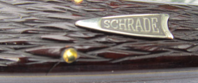

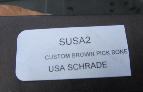

JW very nice ! i a'm here to learn . so are we saying picked bone was done buy hand ? company's still use the term a lot . just noticed the other day the box labeling on a Schrade, GEC made for them. don;t know why it didn't say pick bone. looks liked jigging to me

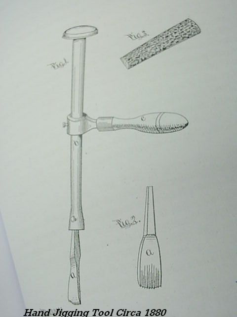

Post by Miller Bro's »
TripleF wrote:What is red pick bone? Or, what is pick bone?
The simple answer is that it is cow shin bone that has been "Gouged" out, either by hand using a variety of tools or it was done mechanically by a machine.
Picked or Jigged same effect just a different term used by different people. I have never seen an old catalog describe it as picked bone only jigged bone.
Below is a picture of a tool invented in 1880 to hand jig bone for knife handles. Note the changeable blade at the bottom for making different patterns in the bone, simple yet effective.

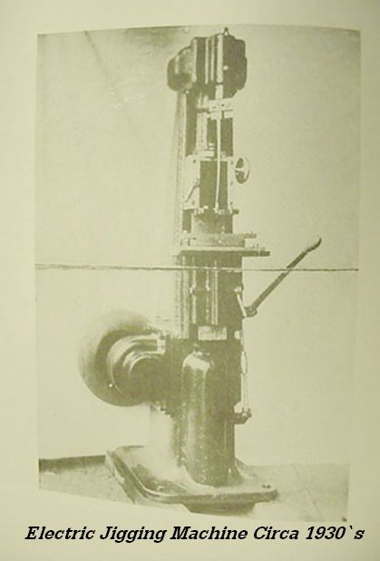

The only problem is, it was a slow process. To speed things up a machine was needed. There is a machine that was patented as early as the 1860`s in Germany, but I don`t have the picture or exact date handy.
George Schrade invented a machine to do the same job, here below is a picture of that machine. All you had to do was feed the slabs in and out came a nicely jigged handle. After the jigging they were dyed to the desired color.
All this machinery lost to time, what a shame :(

Thanks Dimitri for the clamification as well as
the fine illustrations of olde timey cutler toolery.

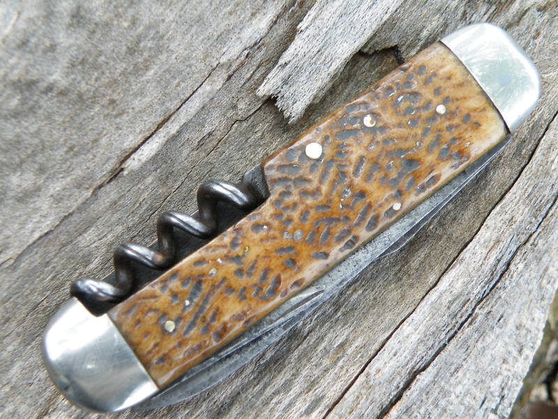

Post by tjmurphy »
I wouldn't swear to it and am certainly no expert, but I think that this is an example of "pick" bone handles, in that the jigging is kind of eratic and non-uniform.
