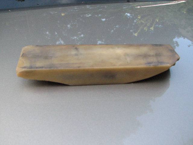

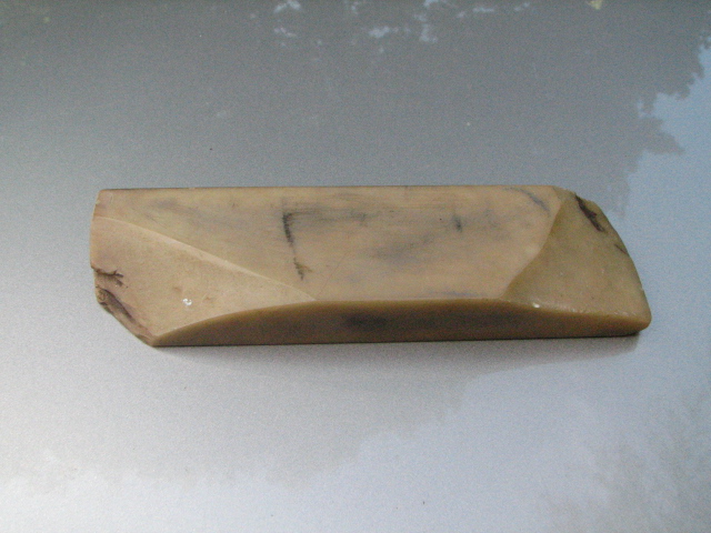

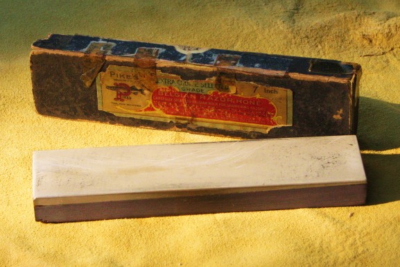

For sure not the only stone I've got, but it certainly is the best. Don't know what to call it, just a piece of broken stone my grand-dad had. He died in 1954, so at least 56-years old but probably more like 75+. He made his own knives, butcher and kitchen knives, and this is a piece of the stone he used to keep them sharp. I can bring an edge up to razor sharp with this old feller. Pardon the crappy pic, all my indoor shots turn out grainy like this.
A question. When would you use oil and when would you use water as the carrying agent on which stone?

tj, what a beautiful old stone that is. I don't know what to call it either. That it has been used for many years and is still in good form, that is, not dished out much, tell me it is a very hard stone. It seems sacrilegious to put water on that one.
I don't know that I would. Besides, your Grand dad would frown on a pup like me for suggesting it. I think I'd stick with oil.
I has worked for you and him.
I use water on all my stones. I soak them just a bit and use a spritzer to keep them wet.

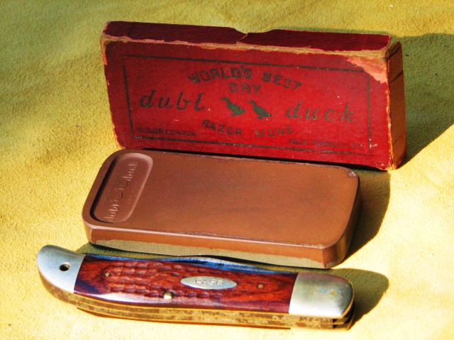

How bout this old stone? 50 centavos at a flea market. I couldn't pass it up. This was/is a fine stone. I use it a lot.

Thanks FRJ. This little feller's been lost for about the last five years. There's another of his old stones floating around here somewhere along with his old John Primble razor hone. Need to start tearing my junk room apart to find those too. I've tried using my other stones and have ruined a couple of good knives in the process. They just don't work like this ol' guy. I guess a stone is a stone but the new one's don't seem to cut like the old ones. I've always used oil on my stones and you probably couldn't get water to stay on this old feller long enough to do any good anyway.
Wow, 50-cents, how could you lose? It sure looks like a dandy. Has it turned into your regular use stone yet? Bet it's a lot better than your newer stones. I'd have gladly paid that for it and more. Old is better.

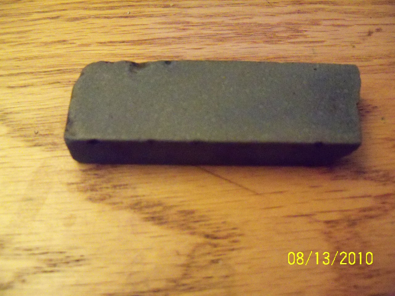

and one I forgot I had
Corundum (aluminum oxide)
Does anyone care to give a quick pro/con on each or add other types to the list?

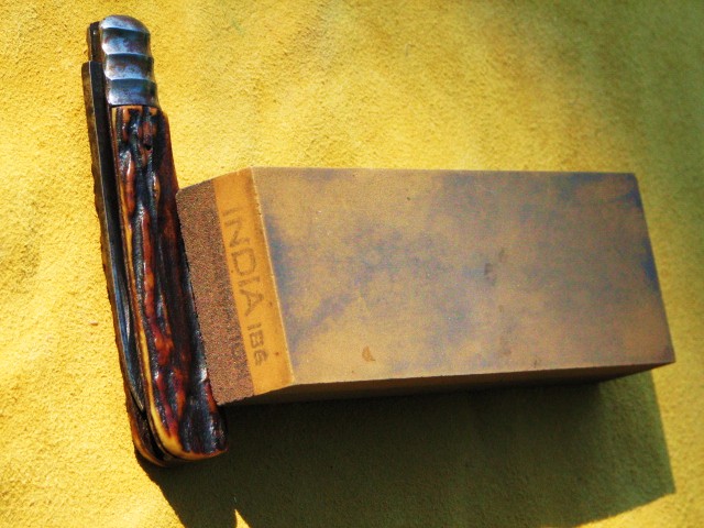

I have a reddish, two sided India stone. what ever that is.
Also, Mike,I don't know what corundum is.
I'll send a pic of my India, if you'll send a pic of the corundum........tomorrow.

Will do. It works pretty well but I like the carborundum better.

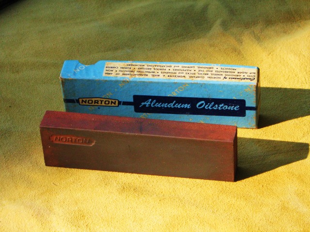

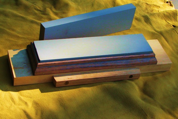

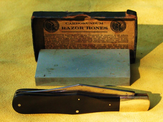

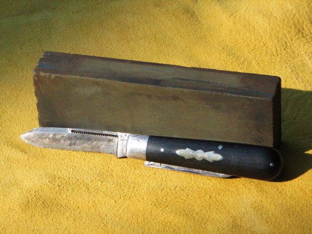

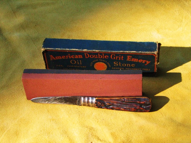

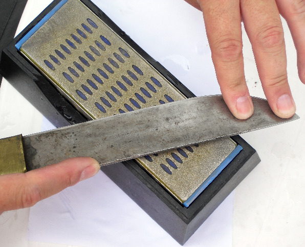

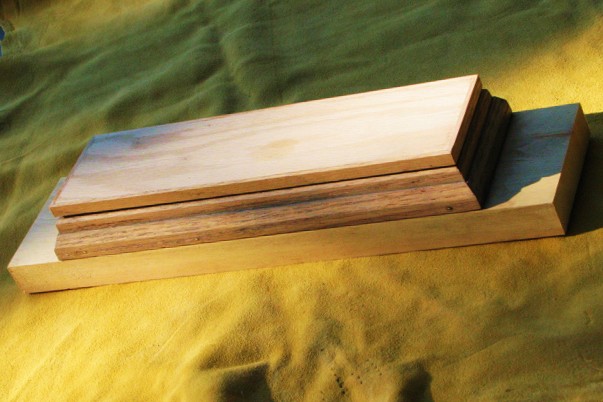

Here are some pictures of some of my stones.
- Attachments
- vikingdog
- Posts: 2308
- Joined: Mon Feb 08, 2010 2:46 am
- Location: Pennsylvania The Keystone State
Re: Freehand Sharpening
Great post Joe. I love the old stones with the original boxes, not to mention the knives. You've got some high class pieces there. The Belgian stone is supposed to be about the finest grade. As a matter of fact I think I'm going to start collecting nice stones now. What is the brand name of the carborundum razor hone in the bottom picture? It looks familiar.

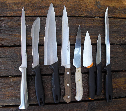

These are the straight edged knives I found in the kitchen drawers. Nothing fancy, but mostly good quality utility knives with decent steel. For some reason Finnish Fiskars seems to be the preferred brand of the house.
Most of these knives have seen years of use without ever being sharpened and they were all very dull.

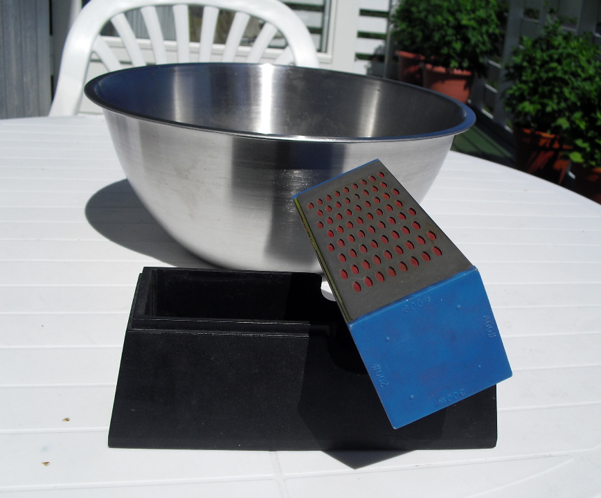

When sharpening very dull knives or blades with damaged edges, I start out with a diamond stone.
I had brought a stone with four grades of "grit" and the knives all screamed for the coarse treatment first.
Sunny days and I put on some sunglasses and went to work outdoors.

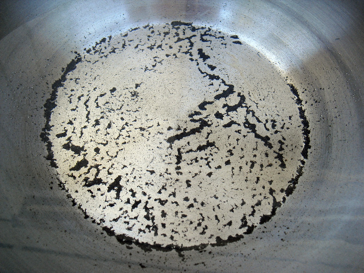

The bowl with water is for removing metal fragments from the diamonds, with I do frequently during the sharpening process.

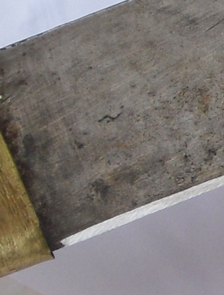

Among the non-kitchen knives I sharpened was an old Sami knife (Leukku). The dark patina of the blade made it a good candidate for some pics, which I thought might come in handy some day.
I started by reprofiling the old and very dull blade, establishing a new edge with a thinner edge profile. Firm pressure initially, then gradually lighter. Here you can see the new edge forming. Still quite rough, but getting smoother as I moved on to finer grades of diamonds. Quite a few knives and metal residue was building up in the bowl as I worked. With such a diamond stone and some skills you can get a decent working edge on most knives, and some times that is all you really need.
I like my edges to be a bit more refined for that shaving sharpness and moved on to a ceramic rod.
