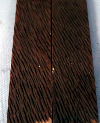

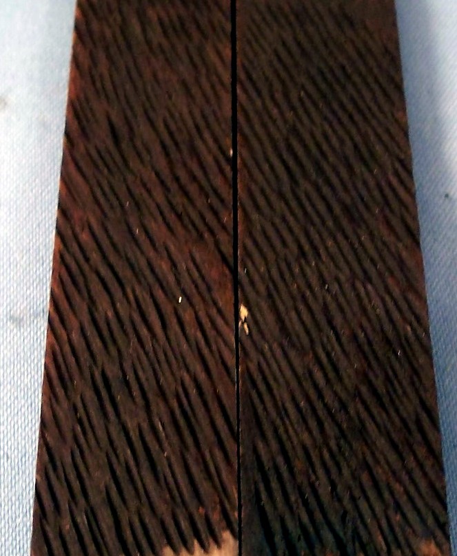

Been playing with jigging and dying in my fee time. Here is my attempt to replicate the old "true" (as I call it) peachseed bone schrade used in the 60's
orvet
Posts: 19898
Re: Dye for bone handles
Post by orvet »
That looks good Kaleb.
Have you hafted any and put it on a knife yet?
I am curious to see what it looks like then.
muskrat man
Posts: 5684
Location: Ohio
Post by muskrat man »
I'm working on rehandling an old german whittler in a set of bone I just jiggewd and dyed, using the same process as the peachseed, only ths jigging is different and looks like some of the older pre WWII jigged bone, I'm hoping to finish it up today, if so i'll post pictures. I got 100% penetration with the dye from all sides so once hafted it should not be much lighter in color than what you see here, we'll see. I havent stepped outside yet to check the teperature but if it's warmed up any I hope to try dying som bone that should turn out a lavender color.
