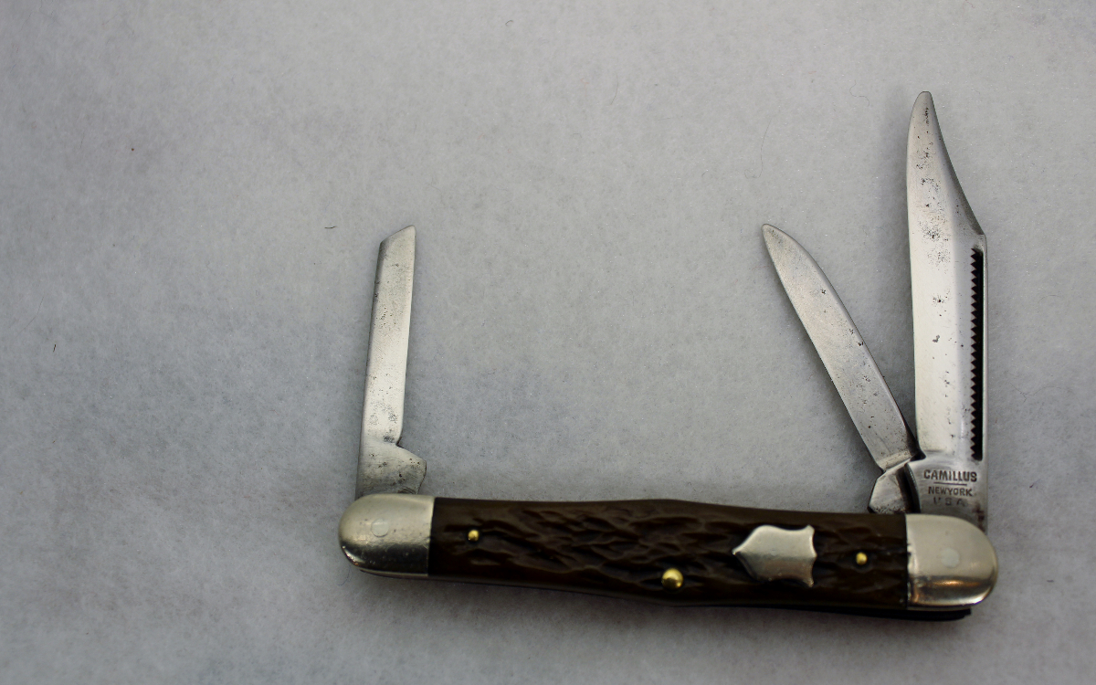

Post by Shearer »
Landersknives

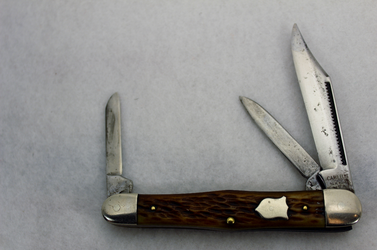

You did a top job on the knife.It's hard to fit that shield.The ones with the round scout shield makes life easier.

Tsar Bomba
Posts: 3637
Re: camillus #72
Post by Tsar Bomba »

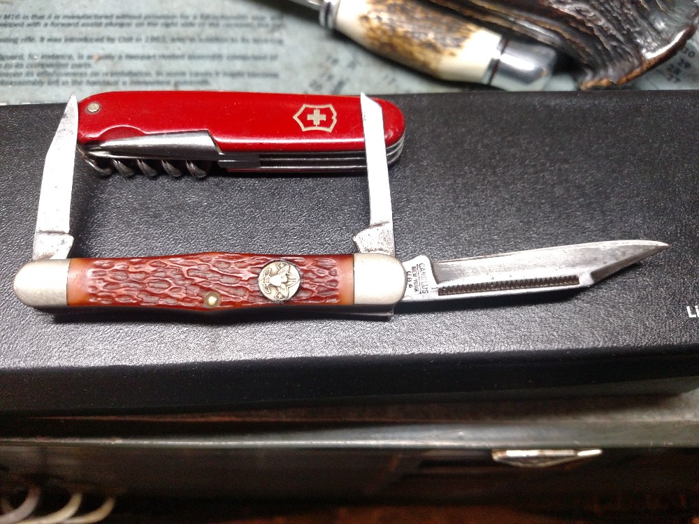

Ed, you make a compelling argument to get some of those shrinky-dink #72s rehandled in ACSB. ::tu:: Outstanding work and thank you for sharing those unique creations with us! ::handshake::

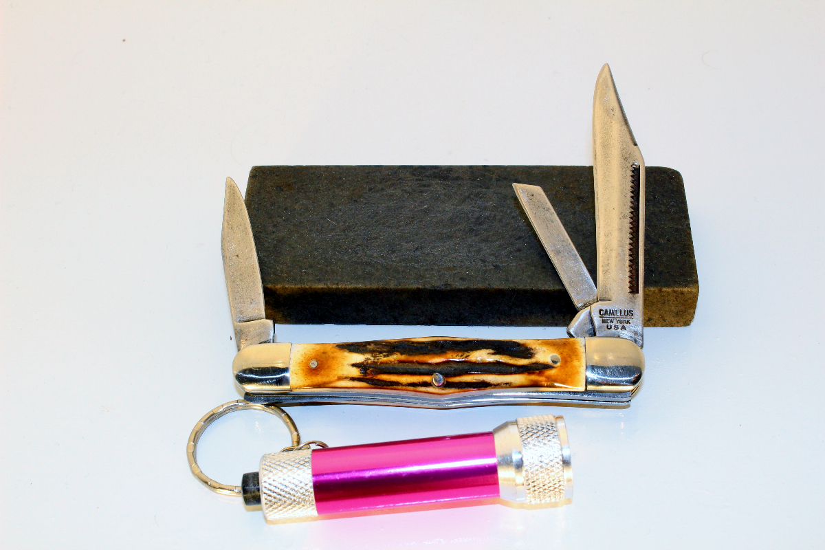

Thank you Grant and Tony. I really appreciate your opinions and thanks for the encouragement. Yeah the shield was a little difficult for sure. I really enjoy working on pocket knives and I strive to get better and you guys your comments and feedback help me. ::handshake::

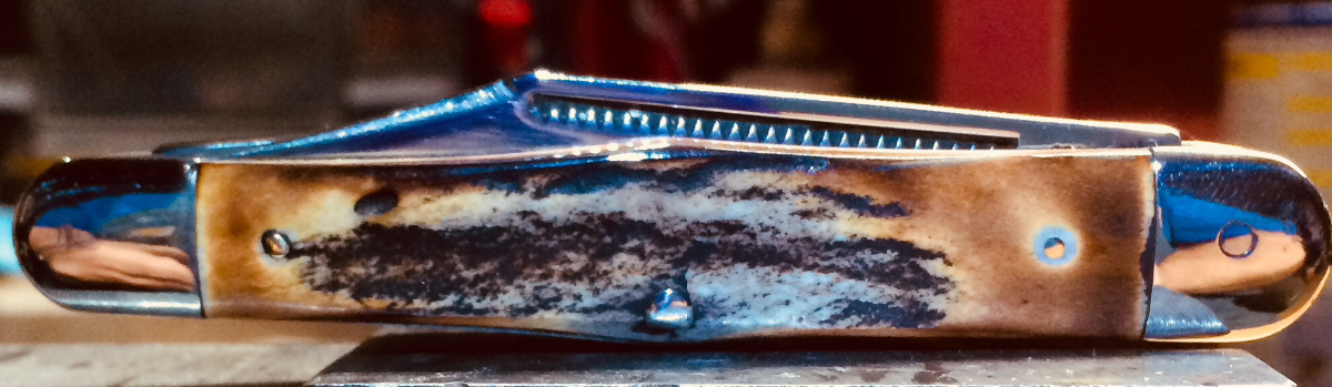

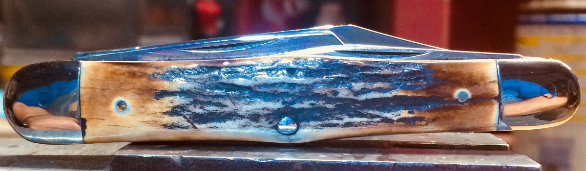

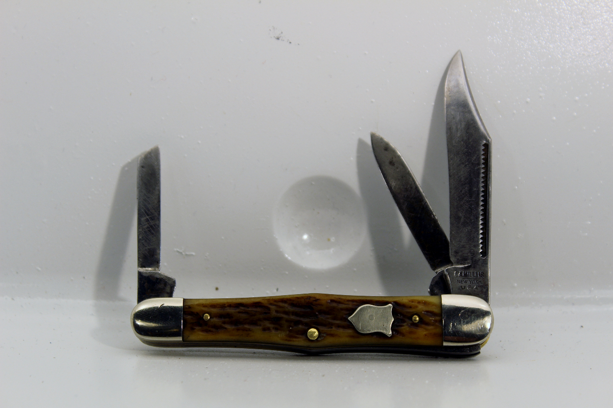

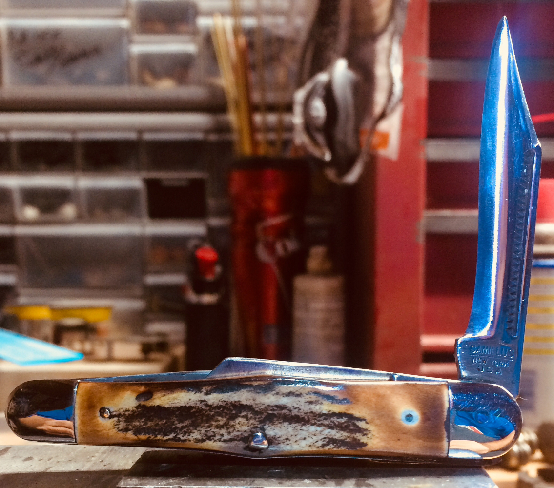

Well the other 72 is done. It fought me hard all the way. I hope everyone likes it. I went with stag. Check it out ::tu:: comments/constructive criticism welcome! The main blade had no snap so I had to weld the tang but it has plenty now.
Ed
“No brag just fact”
Walter Brennan
carrmillus
Posts: 6293
Location: tupelo, miss.
Re: camillus #72
Post by carrmillus »
.............outstanding!!!!!!.......... ::tu:: ::tu:: ::tu:: ........................

I know nothing of knife repair but the work you have been showing sure looks top notch to me. ::tu::
#goldpan
Posts: 1891
Re: camillus #72
Post by #goldpan »
Nice work Ed! ::tu:: I'm jealous buddy! You do very fine work indeed! ::ds::

carrmillus wrote:.............outstanding!!!!!!.......... ::tu:: ::tu:: ::tu:: ........................
....after looking at that one again, I wouldn't care if it didn't have a shield!!!......... ::tu:: ::tu:: ::tu:: ::tu:: .............

Thanks guys very much. The shield on the regular 72 was a push in type. It had a sharp point at the top and bottom and you would push or press it into the scale. Well I could have inlaid it like I did the Boy Scout knife but it would have took some of the stag out so I made a design decision and left it off. Thanks again for all the comments I do really appreciate them. ::handshake::

....on a stag handle that looks like that, you don't need an emblem!!!!..... ::tu:: ::tu:: ::tu:: ...............

jerryd6818 wrote:Ed, that is splendid. Absolutely splendid. That's not just a good job, that's a great job. ::tu::
Hey Jerry just wondering if you have seen the stag 72. If so what do you think of it and if not take a look please sir. Thank you for the above complement. I really do appreciate it. ::handshake::
Ed
“No brag just fact”
Walter Brennan
Posts: 39458
Re: camillus #72
Post by jerryd6818 »
A little heavy on the toasting for my taste but other than that, another fine job. Hey, you asked.

Light on the toast gotcha! I did ask my friend I value your opinion. I am fairly good with constructive criticism. My one feeling is fairly tough. Thanks for letting me know. ::handshake::

Ed, that's just my opinion formed by my taste. The opinions of others will most certainly differ. "You can't please everybody so you gotta please yourself."

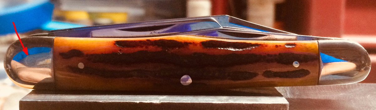

Post by Vit_213 »
Landersknives, It's really a great job ::tu:: .
However, I immediately had a question: is there really a bolster has an oscillation on the axis or is my vision deceptive?

That is a visible pin that I did not blend well enough. It has been corrected. Lol.

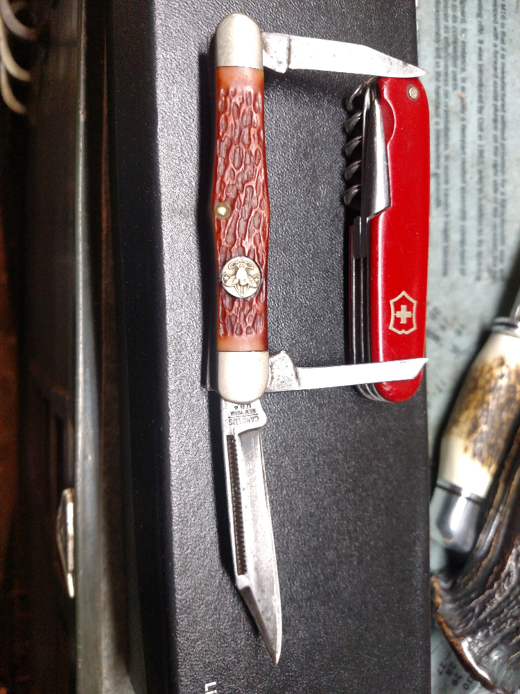

::sotb:: hi
Landersknives wrote:Thanks eveled. Did yours look like this one below?
Yes it is like that one with the round shield. It's really a nice knife. My first knife was a stainless SAK, and the carbon steel blades on the 72 were a blessing, for an aspiring whittler.
I used to like carving small totem poles and give them as gifts to my scout master's. Or back scratchers. Fun and easy. I'm being forced back into it by my young son. He likes to make walking sticks. Best thing I carved with it was a set of interlocking hearts for my wife.
Your stag one is amazing.
It's made a lot of chips, and still has a lot of life in it.

Sweet knife! Greg that sure is a beauty. Great knife and story eveled. Nothing like carving walking sticks but the hearts sound very cool also. Thanks for the compliment on the stag. :D

Posts: 39458
Re: camillus #72
Ed, that Scout version of the 72 is commonly referred to as a 1047. She is post 1976 when Camillus stopped pinning the handles and went to the formed post method of attaching handles (look inside the blade well for a circle) to sometime in the early/mid '80s. Looks to be in fair decent condition. Sounds like you've put her to work for her intended purpose.
