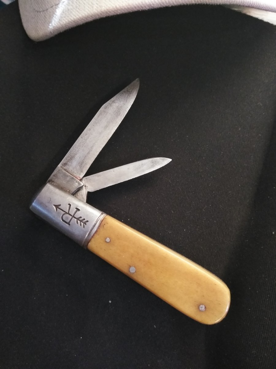

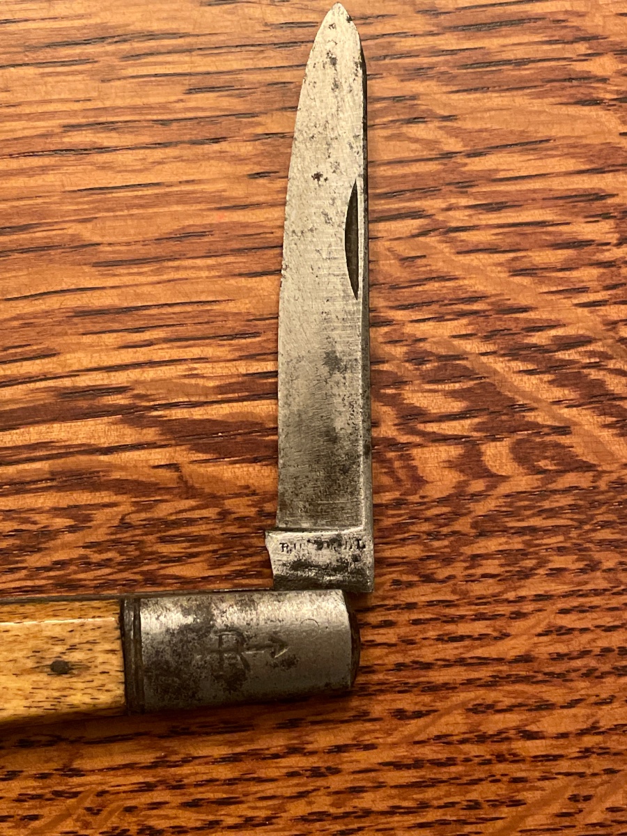

I think this is an older Russell knife but would like any info I could get. According to this thread the straight Russell name on tang is before the 1930’s?
Thanks for any input!
Posts: 21541
Re: Learning to spot a real Russell Barlow
Looks like a legit HOK (honest old knife) to me. ::tu::

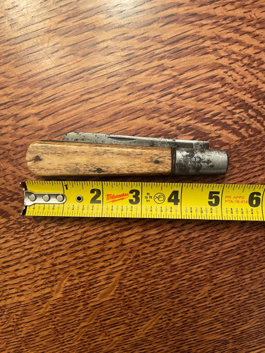

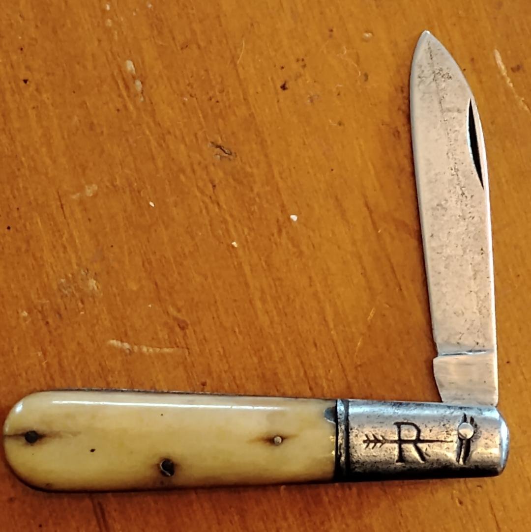

I recently acquired this Russell and have been doing some research to see when it was made, model, etc. The thing that is throwing me off is that all the others I can find like this have 3 pins, while this one has 4. Before I list it for sale on Ebay, I want to make sure I have an accurate description and it is indeed vintage. Thanks for any help given!

Thanks, I have a German replica apparently. Good to know. Fascinating post.
Posts: 21541
Knifearious wrote: Sun Mar 05, 2023 9:21 am Thanks, I have a German replica apparently. Good to know. Fascinating post.
The above posted picture is not a true Russell, better late than never I guess. I wonder how it sold on eBay? This is one of my favorite AAPK learning threads.

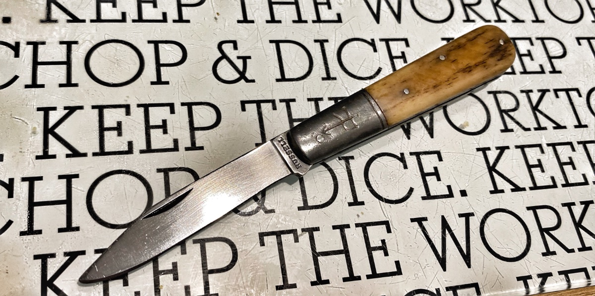

Any info would be appreciated on this one thanks!
Year it was made ?
Reverand
Posts: 4476
Location: Pisgah, AL
Post by Reverand »

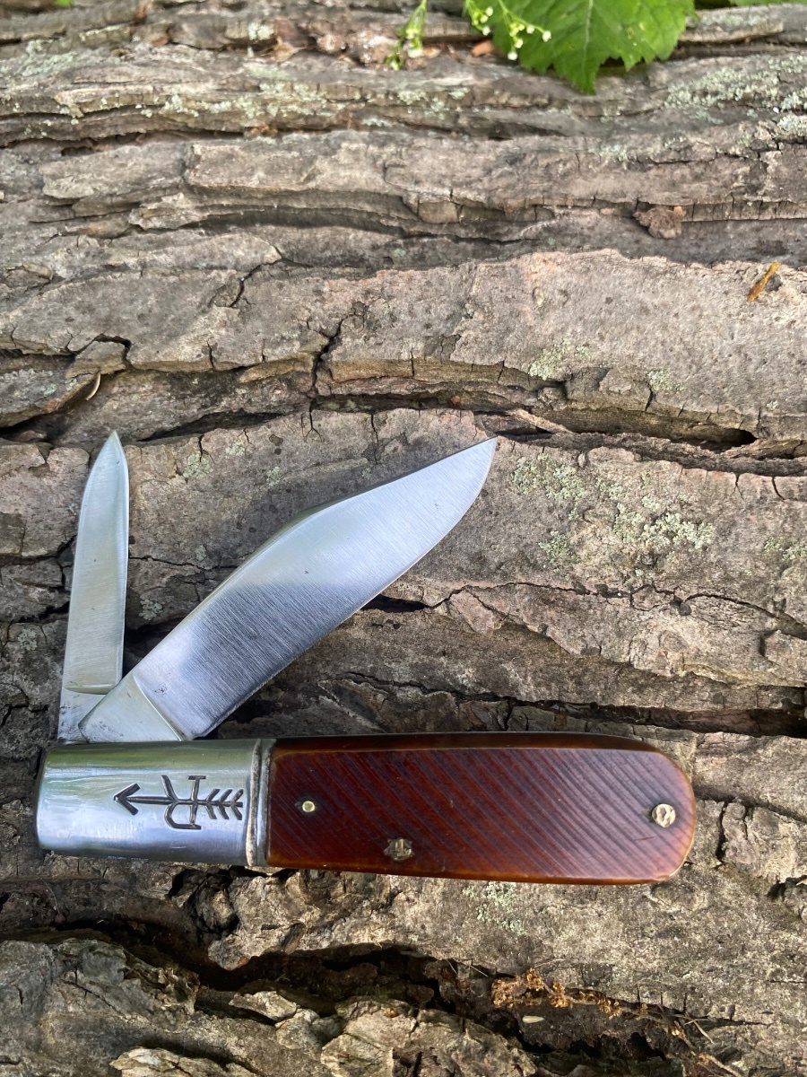

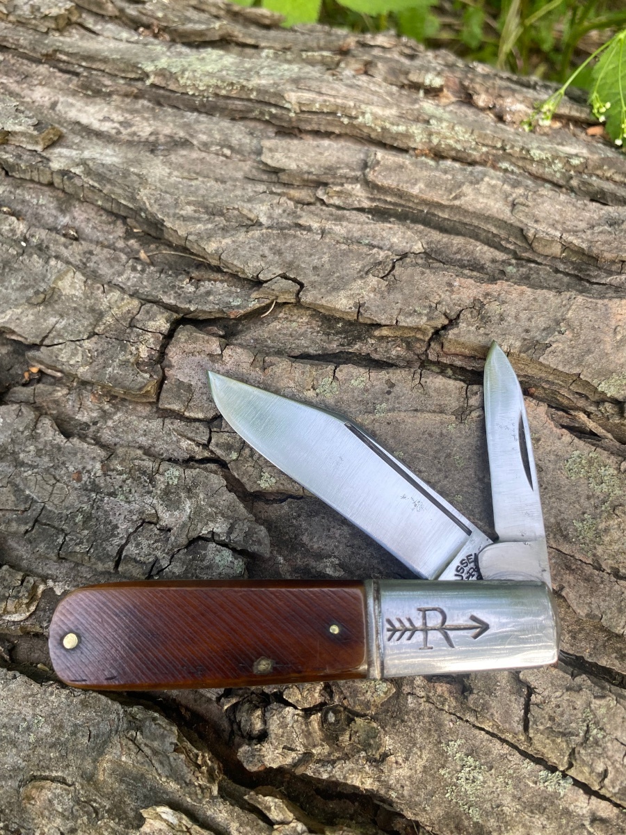

Lilnick70 wrote: Sun Jul 09, 2023 1:11 am Any info would be appreciated on this one thanks!
Year it was made ?
I cannot verify your knife, but I can say that there are some strange things going on with it.
First, it looks to have been buffed quite a lot, at the least. The long pull is not straight on the main blade, and the brass pins have a strange "waffle" pattern on them, like they were peened with a framing hammer or something.
I suspect that, at best, it has been reworked.
Any old knife with blades that shiny are suspect, to me.
I hope for your sake that someone on here who is more of an expert can point out where I am wrong.

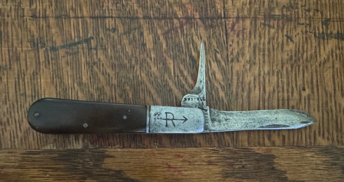

Lilnick70
Posts: 4
Joined: Sat Dec 03, 2022 10:26 pm
Post by Lilnick70 »
Thanks for your time and input much appreciated!
Posts: 21541
The rocker pin isn't centered, so I'm going with reproduction, maybe made by Camillus. But I bet it cuts well. ::nod::👍

Take note of the location of the middle pin on your knife. You’ll notice it’s not centered between the other handle pins. Then go the very first post in this thread, and you’ll see one just like it that was said to be made from a Camillus.

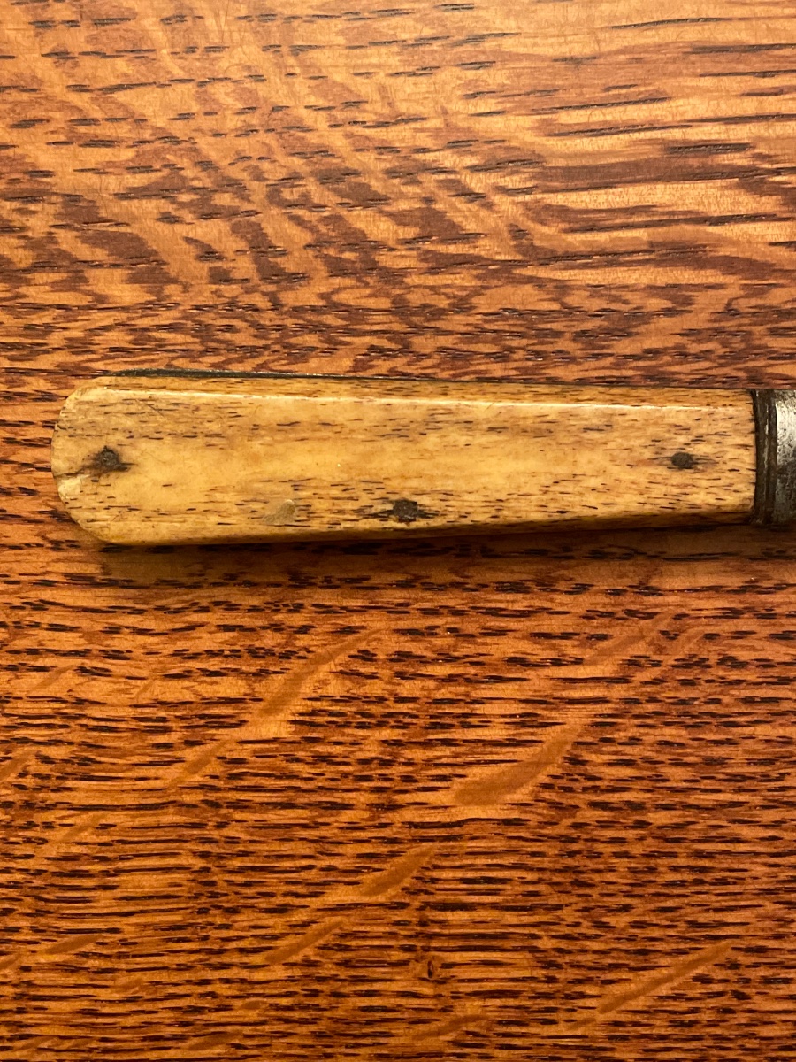

This knife was one of my Dad's heavily-used working tools. He was a carpenter. I've begun to renew this heirloom but am unsure of the approximate year of manufacture. From what I gather in this forum thread, it is a pre-1933 and likely turn of century.

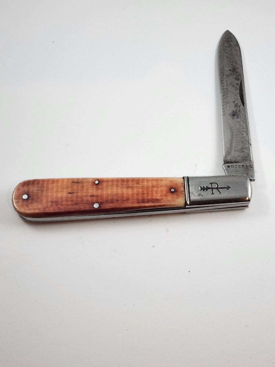

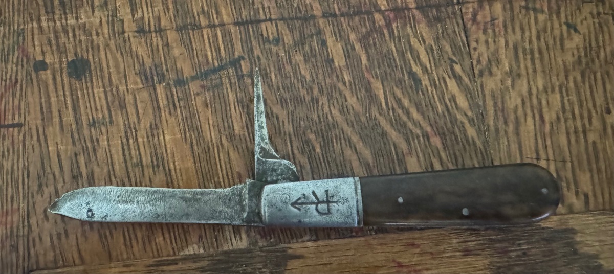

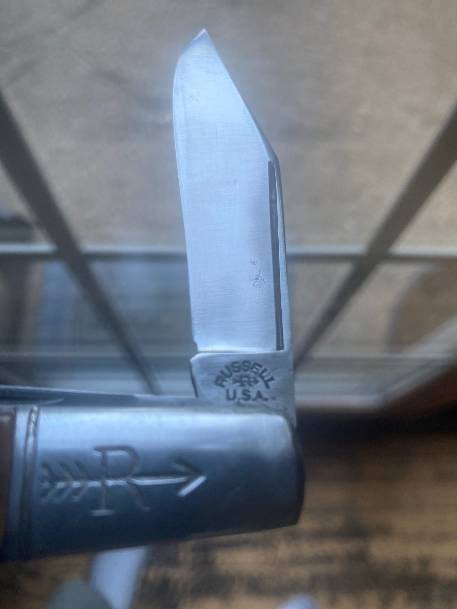

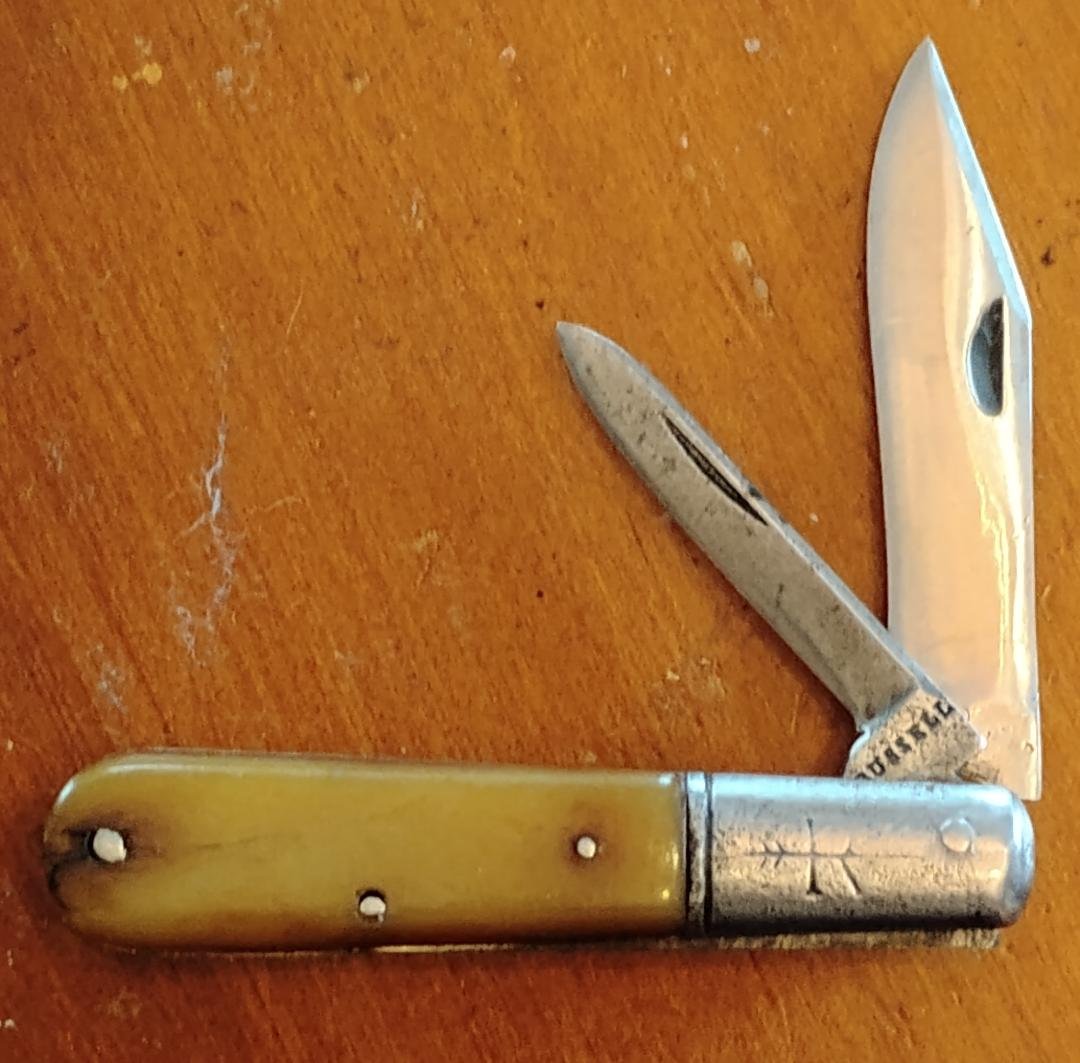

Hi guys , bump this post , I got this Russell’s Barlow today , the handle seems correct ,it was a bit too over restored for me so I did some work on it , I blued the bolsters and got some on the blade but nothing happened , so I tried to blue it out of interest but nothing happened, tried vinegar but nothing again , so thinking it’s SS , I’m the tang stamp also seems to crisp , I got it cheap from a friend so it will be a good user , he is sending me the other one he had and the blade on that is pitted and looks more correct , what’s your thoughts ::hmm:: too pics the one I think has a SS blade , I’m being sent the other one
Paul,
Posts: 21541
Nice find, Paul! Looks legit to me. ::nod::

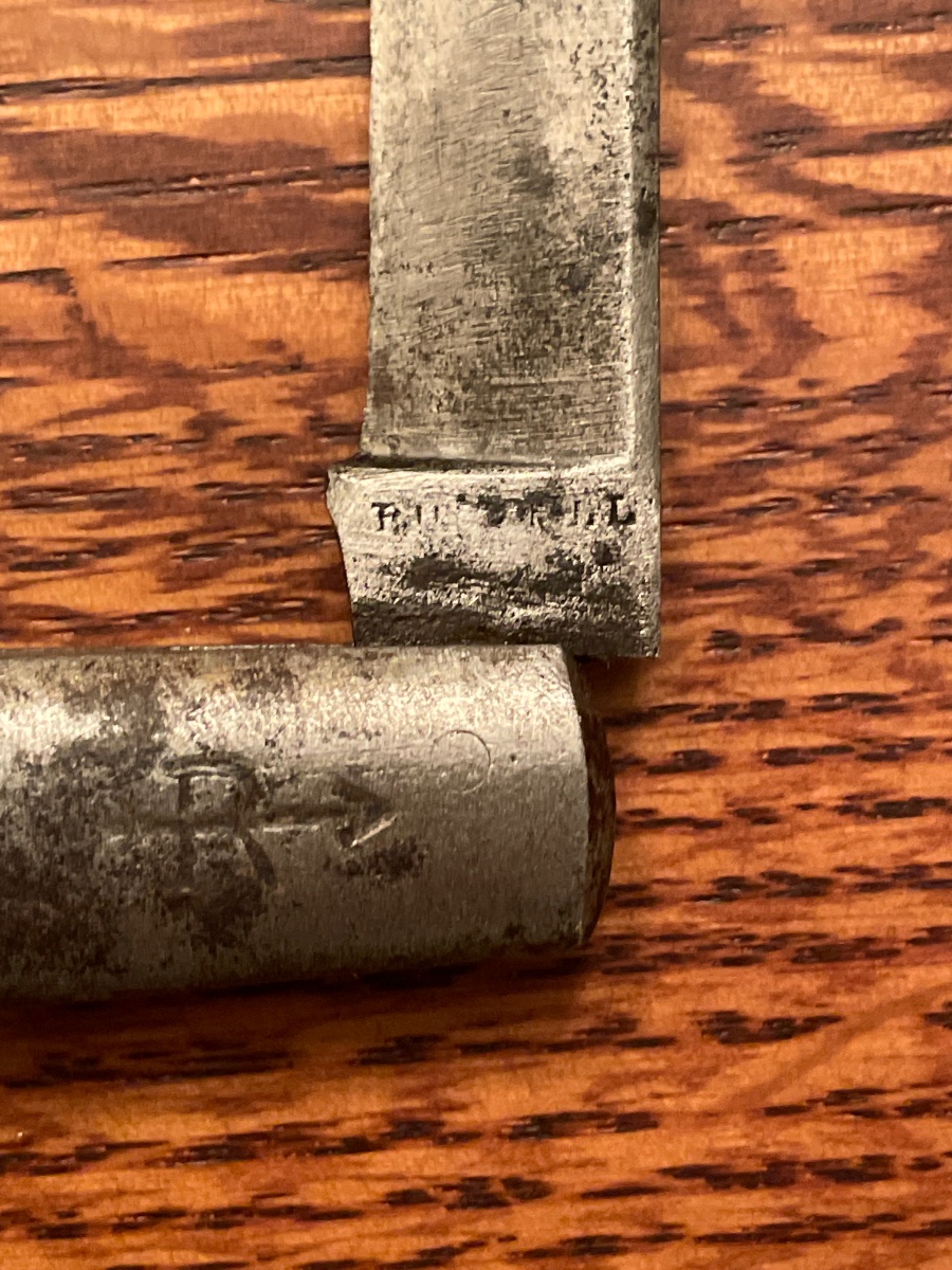

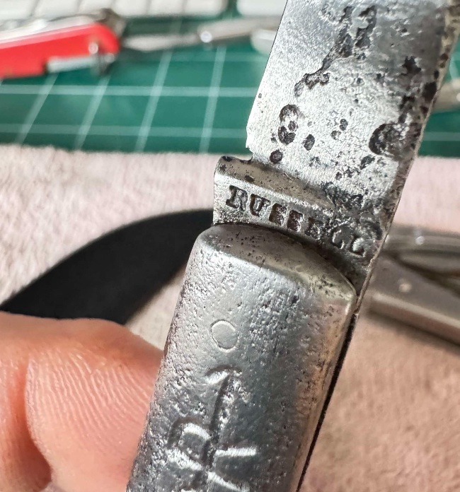

New to AAPK and forums in general, please excuse (and correct) any forum etiquette breeches . There’s a lot of great information here on Russell Barlows. Great Discussion. One thing I’ve always looked for in a straight line small Russell Barlow is they all seem to have a very distinct short tang (with the exception of the veterinary knives). The arch stamped knives and reproductions seem to have a longer , more modern looking tang. Anyone else observe this?

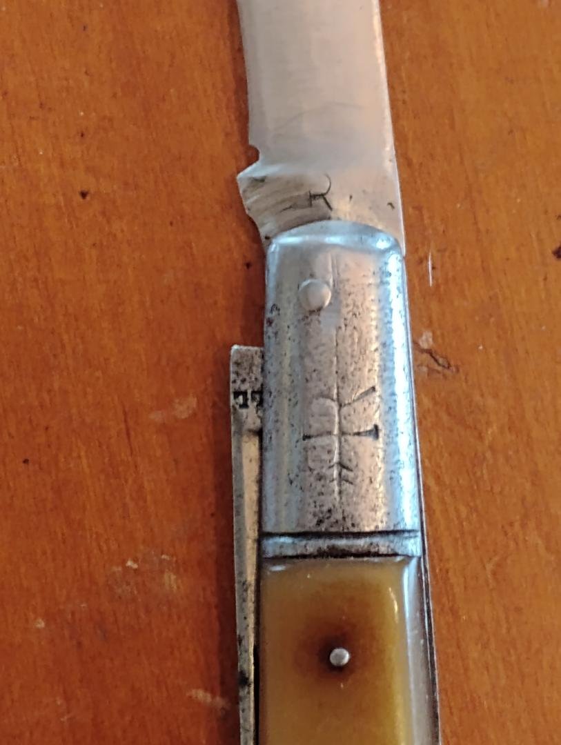

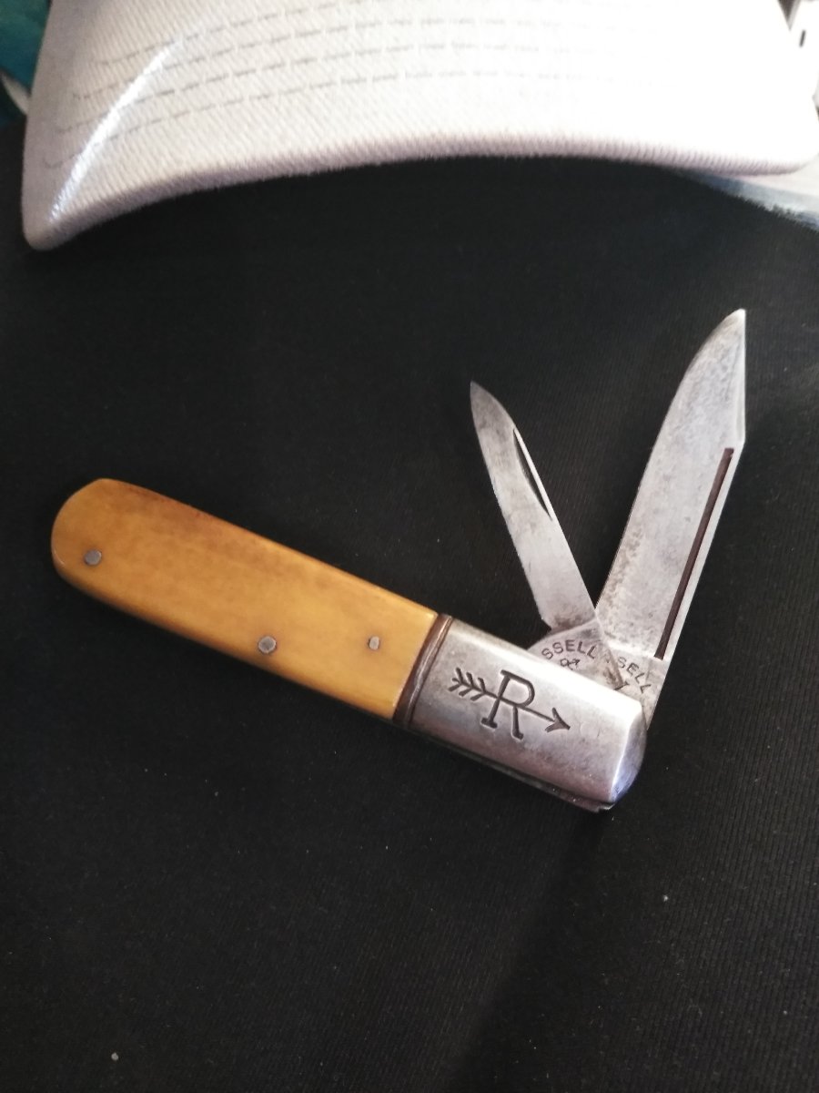

Hello all, I'm new here but not new to collecting knives, I'm happy to be here and eager to learn from the best, I really like the Russell Barlow and found this one online, and reading over this post, looks like I just purchased a little fake, but I've done it before, I have a question for you all, is this one of the German makes? Thanks guys for any information on this knife.

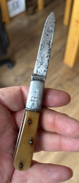

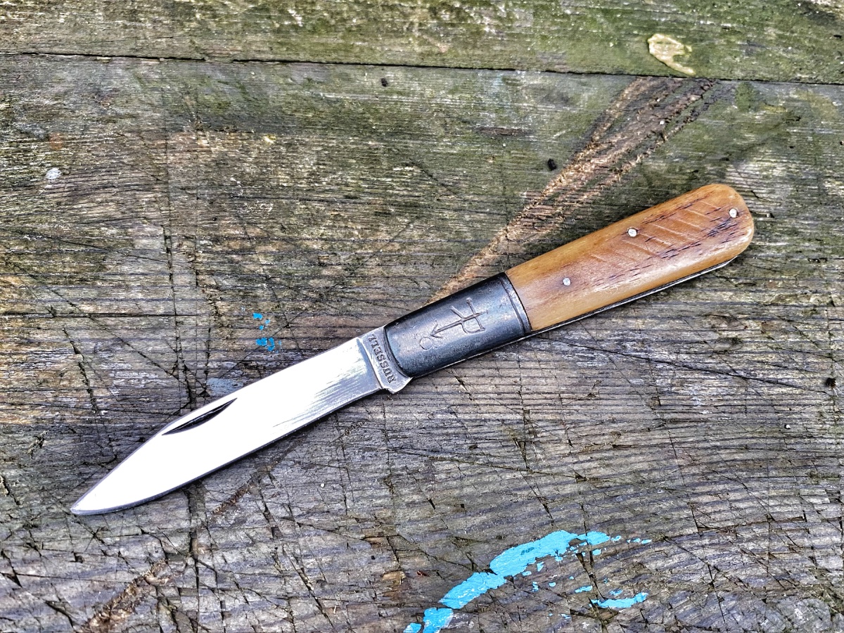

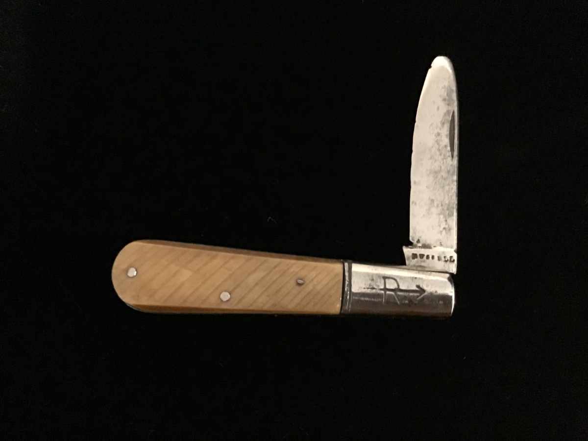

I would appreciate an opinion on these two. The two blade seems legit except for the main blade even though there is a R on the blade. I got them both in a swap shop so not much money into them.
