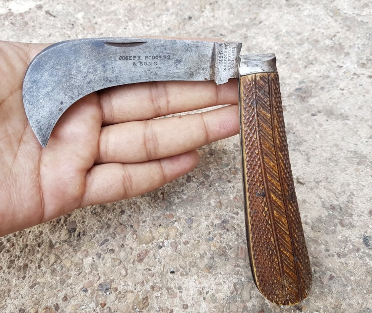

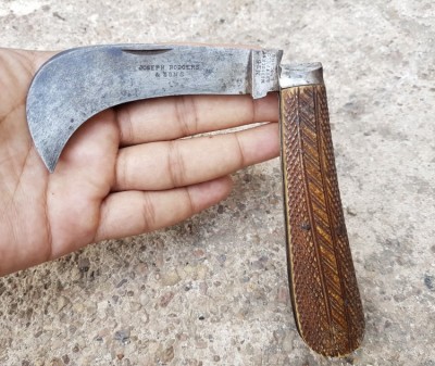

Here is a pic of some naturally occurring cow horn. Very rare.

James, that is smooth bone that has been carved into that design.

That was my little attempt at humor

That is one GOOD looking old hawkbill.JAMESC41001 wrote:Here is a pic of some naturally occurring cow horn. Very rare. 63AD7AB1-AFED-498B-B67E-86B2D60A49DE.jpeg

Quote James: "That was my little attempt at humor"
I like humor but we need to be careful to not mislead those who might be using AAPK as a reference source.
kj
kj

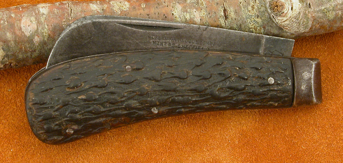

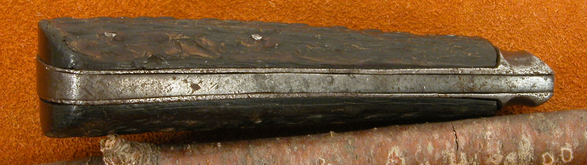

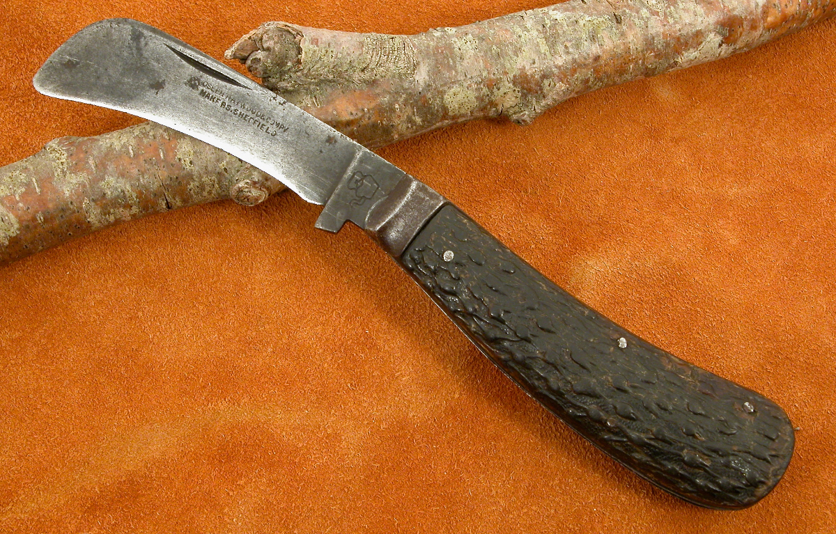

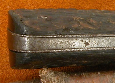

Some new info for the thread in terms of an example of a true "pressed horn" handle… Knife is a Joseph Haywood & Compy (Ca. 1845-1888) Hawkbill - (I’ll include some more history of this old maker when I post it in the Horticultural thread)… integral liners and bolsters so guessing +/- 1860… Classic teapot Tm stamp which was registered in 1860 and cool top hat kick on master.... anyway one question in this thread imho among the many is related to pressed horn as a possibility as the basis for the handle of the OP knife and perhaps more so for all other close examples posted in this thread - and this knife came to my collection in a serendipitous search
This Hawkbill pruner has a hefty handle in terms of girth so lots of handle to see… As described the horn was pressed using multiple overlaying pieces of horn that had been shaved to a layer, heated and trimmed to fit the mold in a stack (the latter info from the old articles noted above).. in fact I also had read that sometimes a dark reddish brown dye was used on these and I “think” I am seeing some of that color in this handle… Notably if you look at the enlarged photo of the sides of handle one can see the layers of horn overlaying each other and one can see the striations demarcating layers if you look closely. The mold pattern design in this case does not come close to those of all other knives here and not sure it would – not exactly a stag look, perhaps their version HSCRATCH but no doubt different… So given this example where I am seeing a clear difference to the many above I am leaning towards the OP knife and many similar examples not being horn but either pressed bone or a type of stag that was no doubt different than the well known old sambar stag, but imho definitely not pressed horn to give a stag-like appearance – I am not seeing the layering as in this knife on the majority of the examples above and a difference in the consistency when I look closely unless I am mistaken… jmo at this point which can always change with new info

Nice knife Lee

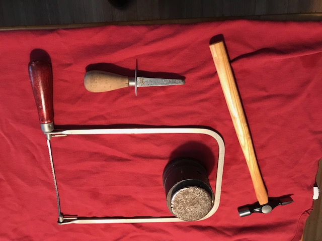

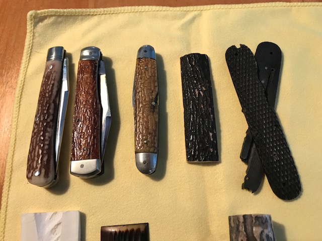

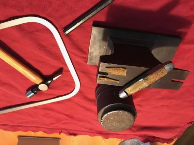

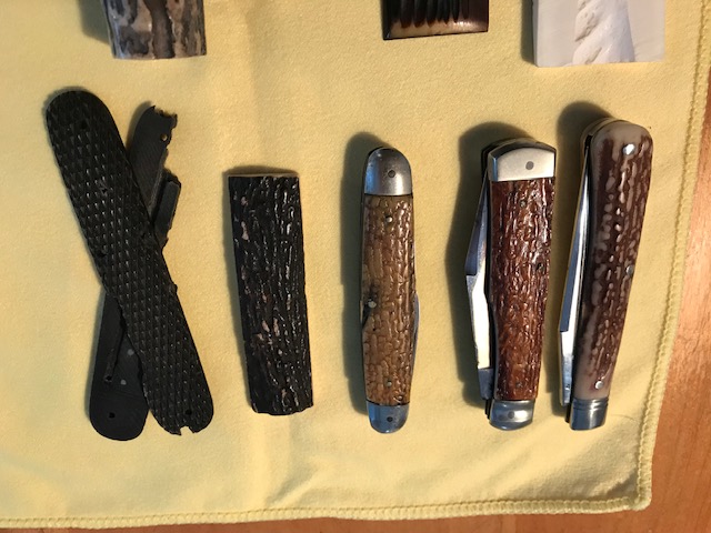

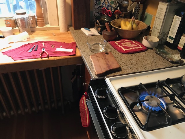

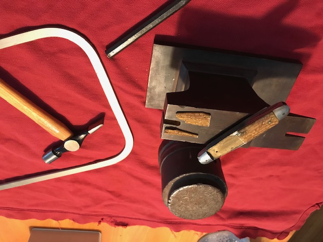

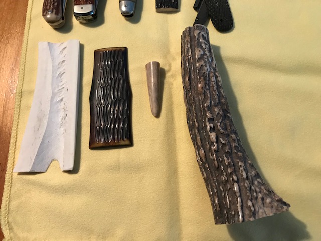

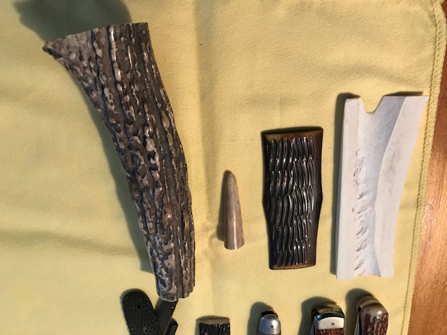

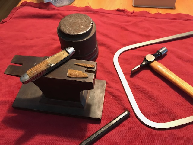

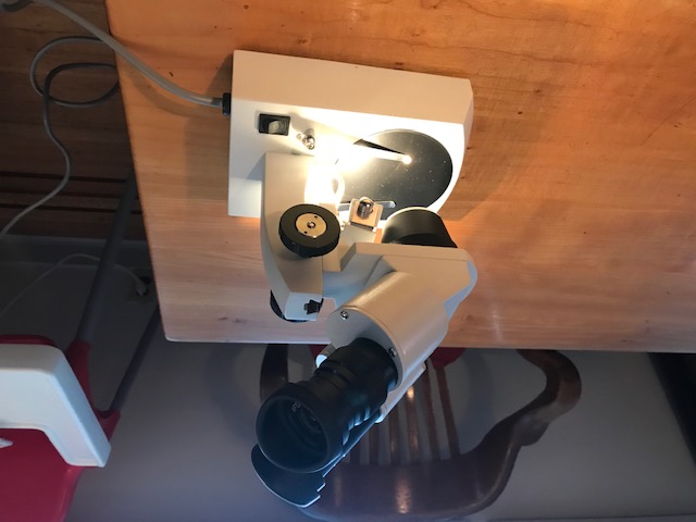

Finally found some time and materials to do this closer look at the "pressed" handle question!!
Thanks for your patience my friends!!!
Let me reiterate that I am an amateur at this, and all opinions and errors are strictly mine!!

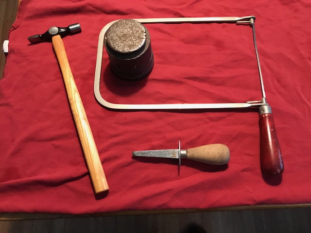

First of all I gathered some materials to look at;
Thanks to Lyle for donating a relic knife with pressed handles. Thanks Bill, at GEC for the cow bone, both raw and jigged.
Here are some pictures of the starting phase, and some of the tools I used.
I got the pictures fixed, and just started over - with apologies.

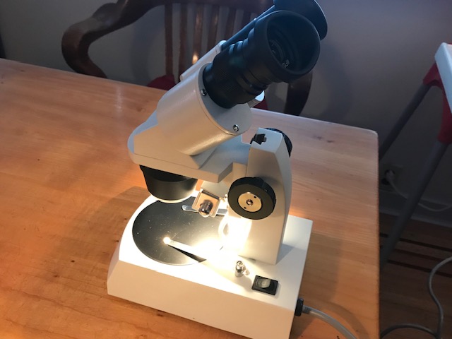

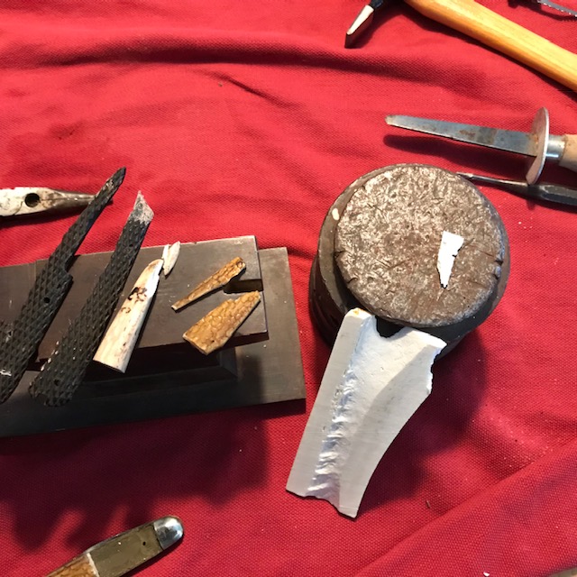

So, I removed part of the sacrificial handle material from Lyle's knife and sanded the back down below the dye, then sanded the raw bone, and the back of the 3" piece of Sambar Stag all to 100 grit, to compare under the microscope, which is 40X, or 40 power.
I found some "pits" diving into the bone in various places in the raw bone, which were not visible to the naked eye.
None of these were found in the "pressed" sample, nor the Sambar sample.
The Sambar and the "pressed" samples had a slightly variegated appearance under the scope, where the bone looked more uniform, whiter and somehow denser. The bone resisted penetration of a sharp point, almost like hard stone, while both Stag and Pressed handle samples felt slightly more deformable, though still hard.
I could find no light-colored horn, but the black horn sample looked like compressed hairs magnified, and was softer to a point pressed into it.
All point-push tests were done with an oyster-shucker blade point, to spare my knives of course!!

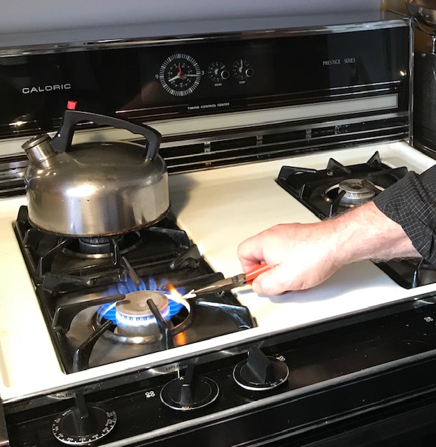

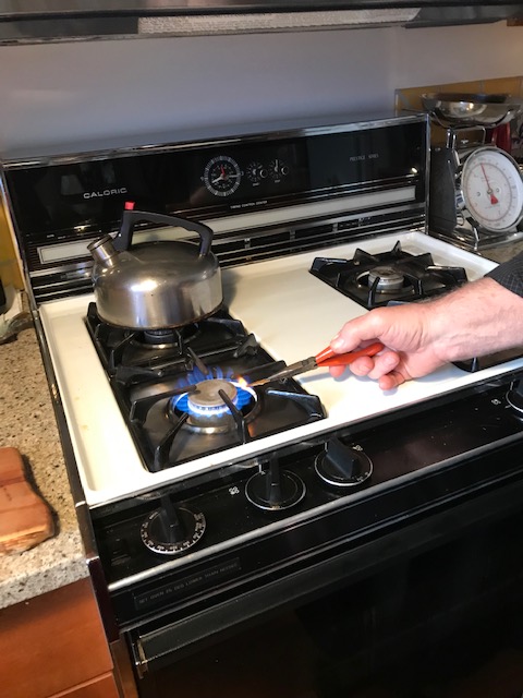

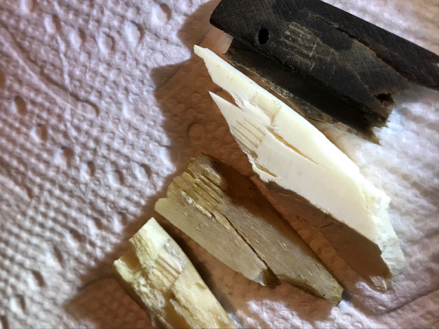

Finally, I splintered up some pieces of each material, ( and snipped a hank of chest hair!!
), to do the burn and smell test.
The bone and antler samples, as well as the pressed material, all smelled like the dentists office when he/she is drilling your teeth!! (two ugly images in one post!!
The Horn smelled like hair burning as did the chest hairs.
My final test will be to boil some samples, to see what becomes deformable!!

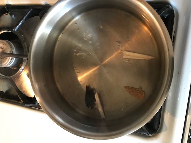

What's Cookin"?

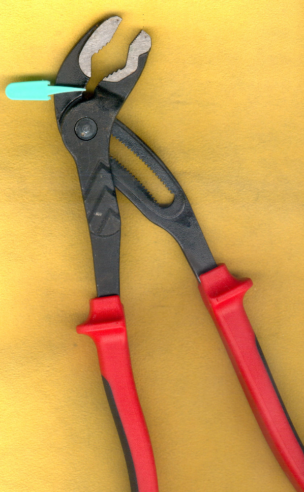

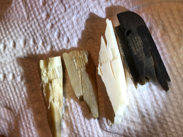

So, I simmered 4 samples for just over one hour; raw bone, pressed sample, Stag and black horn.
The Stag and pressed samples resisted squeezing the least, the bone more, and surprisingly the black horn the most - very tough!!
I held each piece tightly for approx. 1 1/2 minutes in the inner jaw of the channel-lock type pliers.
The black horn took the least impression, and "bounced back" considerably. The Stag kept quite a deep impression, and the bone and "pressed" samples were in the middle. As they dry, the bone has lost some more depth after 30-40 minutes.
