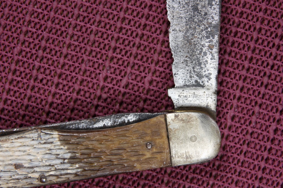

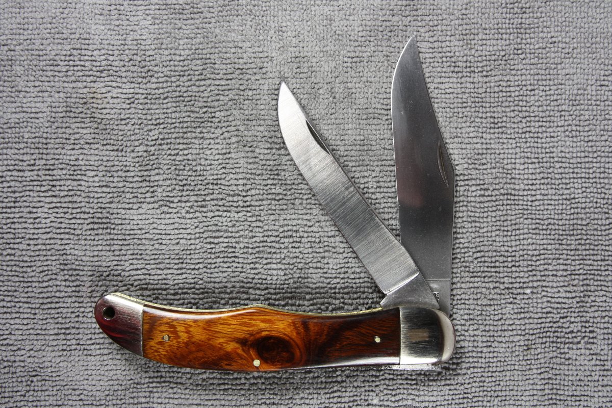

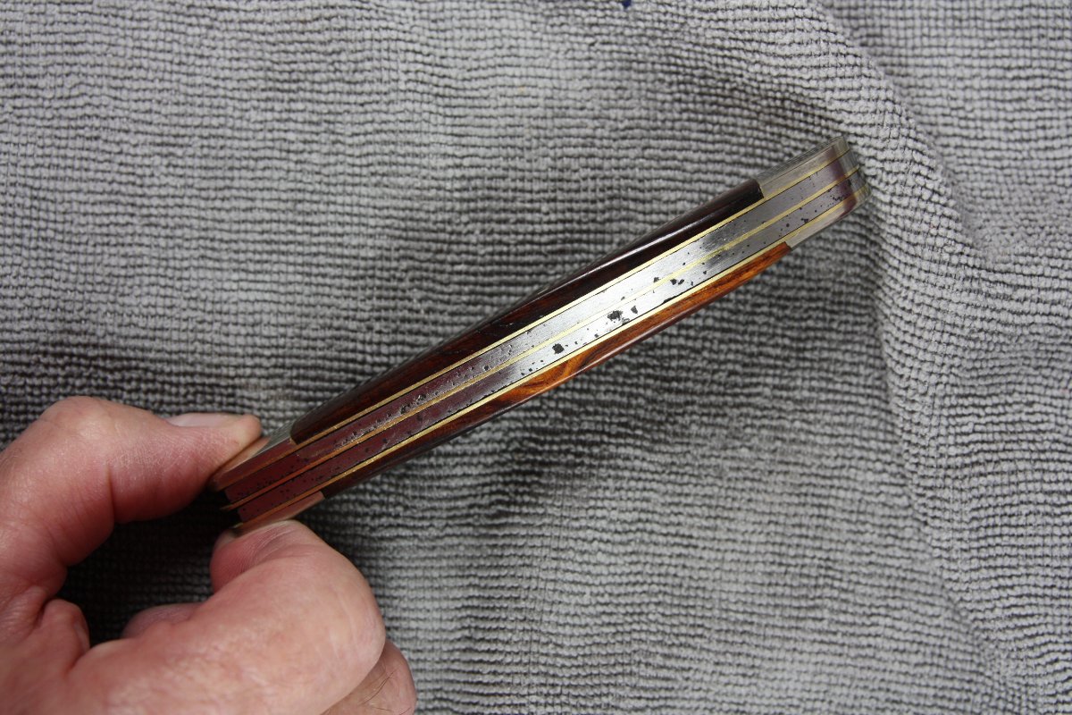

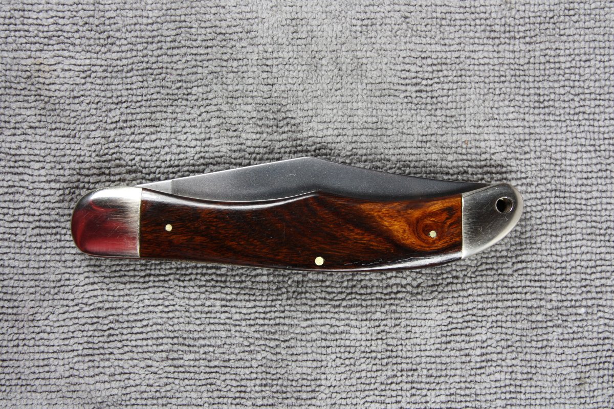

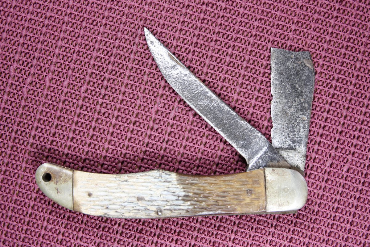

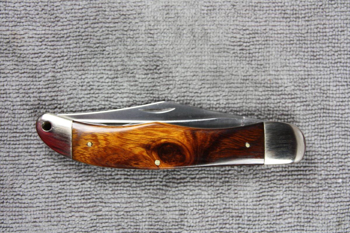

A while back, I managed to put a dent into the plastic bumper on my wifes car. My brother in law, the retired body man looked at it and said he could fix it. He brought a heat gun and laid on the floor in my garage with the heat gun from the backside and he popped it back out to the point that you can't even see it was there. I asked him what I owed him and he said he was going to bring me an old knife he had that "needed some work". The Schrade 225 below is what he brought me. It is the worst piece I have ever drug back from the grave for sure. I got the two blades from Orvet to replace the broken one and the skinner was also badly pitted and worn (thanks Dale). The owner, preferring wood for the rehandle, decided on ironwood. The replacement blades had 1/8" pivot holes as they were from the Swinden pin era and the knife had 3/32" pivot pin holes. After running a 1/8" bit thru the bolsters, and finding my piece of 1/8" nickle silver pinstock, everything fit together perfectly. It was not even necessary to adjust the kick or do anything to the springs. The wood finish is 6 coats of True Oil gunstock finish.
