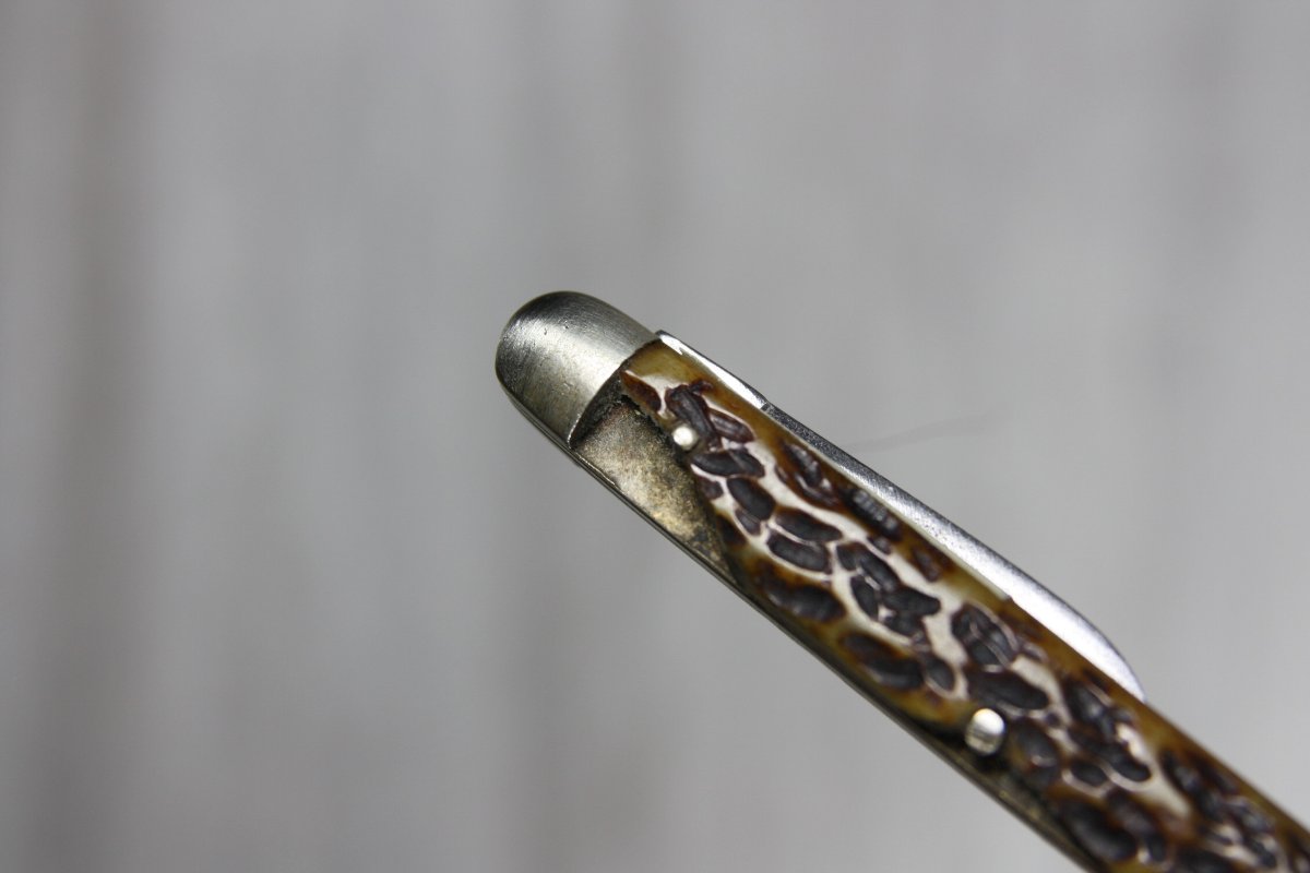

I have a couple of MOP handled pen knives with chips or chunks missing. I wonder if Acra-Glas could be mixed with some kind of pearl like powder to fix them. Anyone ever tried that?

Nothing will repair broken pearl, except replacing the pearl. You can do it-but the results will be horrible.
I use clear polyester casting resin from Hobby Lobby. It works very well.

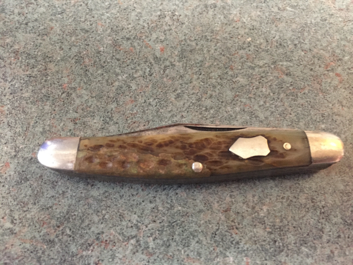

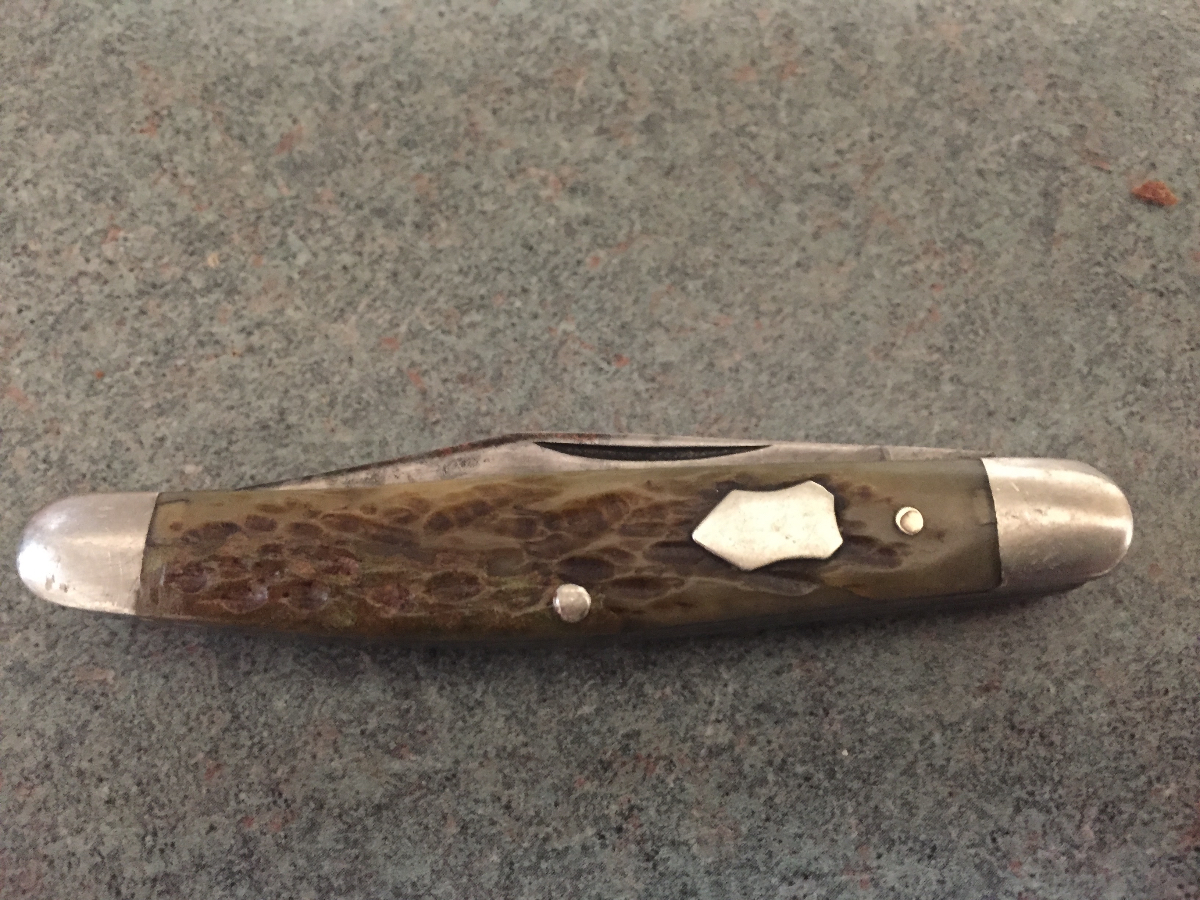

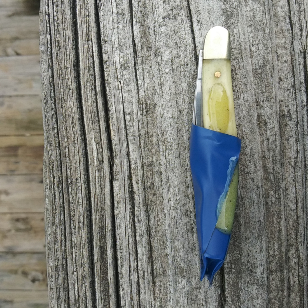

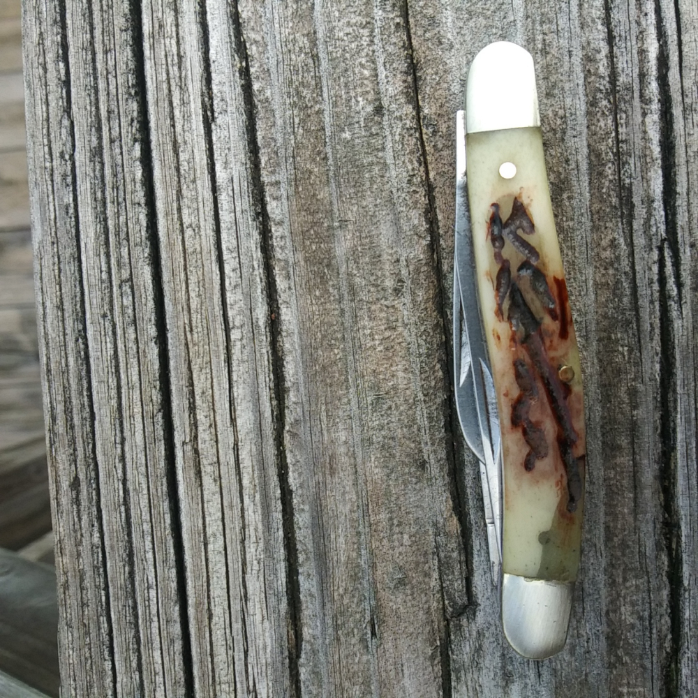

One revision...over my previously posted repair...
In hand, it looked pretty good. It seemed to me, that the limiting factor, was the "dullness" of the Acraglas. Today I put a thin coat of clear fingernail polish, over the Acraglas. It gave it a shine that brought it closer to the sheen of the bone. In short, I thought it was a worthy addition, to this repair. In hand, it looks pretty good.
Before glaze, not too bad:
After glaze to Acraglas, better shine and blends in better:

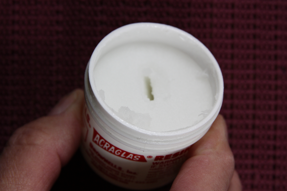

Those of you who have tried the Acraglas like I showed in the OP for repairing bone may have had this happen. Yesterday when I got out my Acraglas kit, I opened the container of resin to find that it has changed from the clear liquid which it was into kind of a white paste. I stuck a popsicle stick in and tried to stir it, but it was too solid. So I thought before I toss it I will call Brownells customer service number and see if there is a solvent that can be added to it and bring it back to life. I talked to the lady and explained the situation, and she told me to either put the tub in a hot water bath or put it in the microwave for a few seconds (with the metal lid removed) and the heat would fix the problem, like one would do with honey that had turned white and set up. She was right, I put it in the microwave for 10 seconds and it turned back into a clear liquid. Now to fix that old jack with the broken bone.

You can get various colors of pearlizing powder to add to clear resins that may make a decent patch for MOP. I have no first hand experience with it at this point but the potential seems to be there

I doubt anything will work well with pearl.
Mother Nature made it the way it is, and I have seen nothing that will match it.

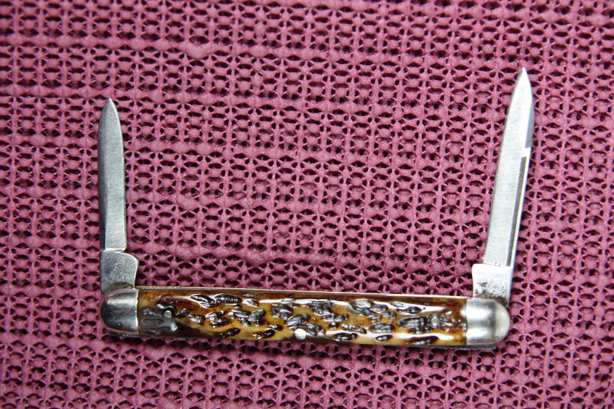

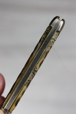

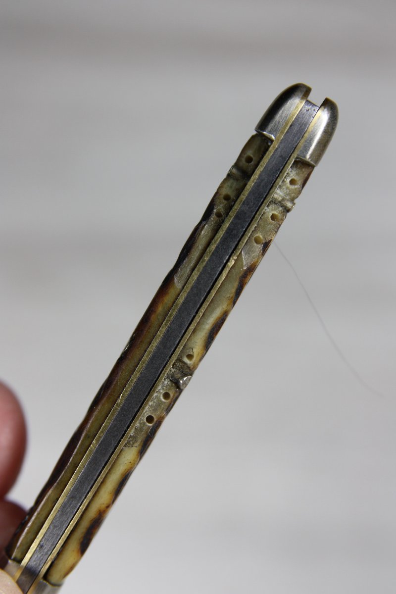

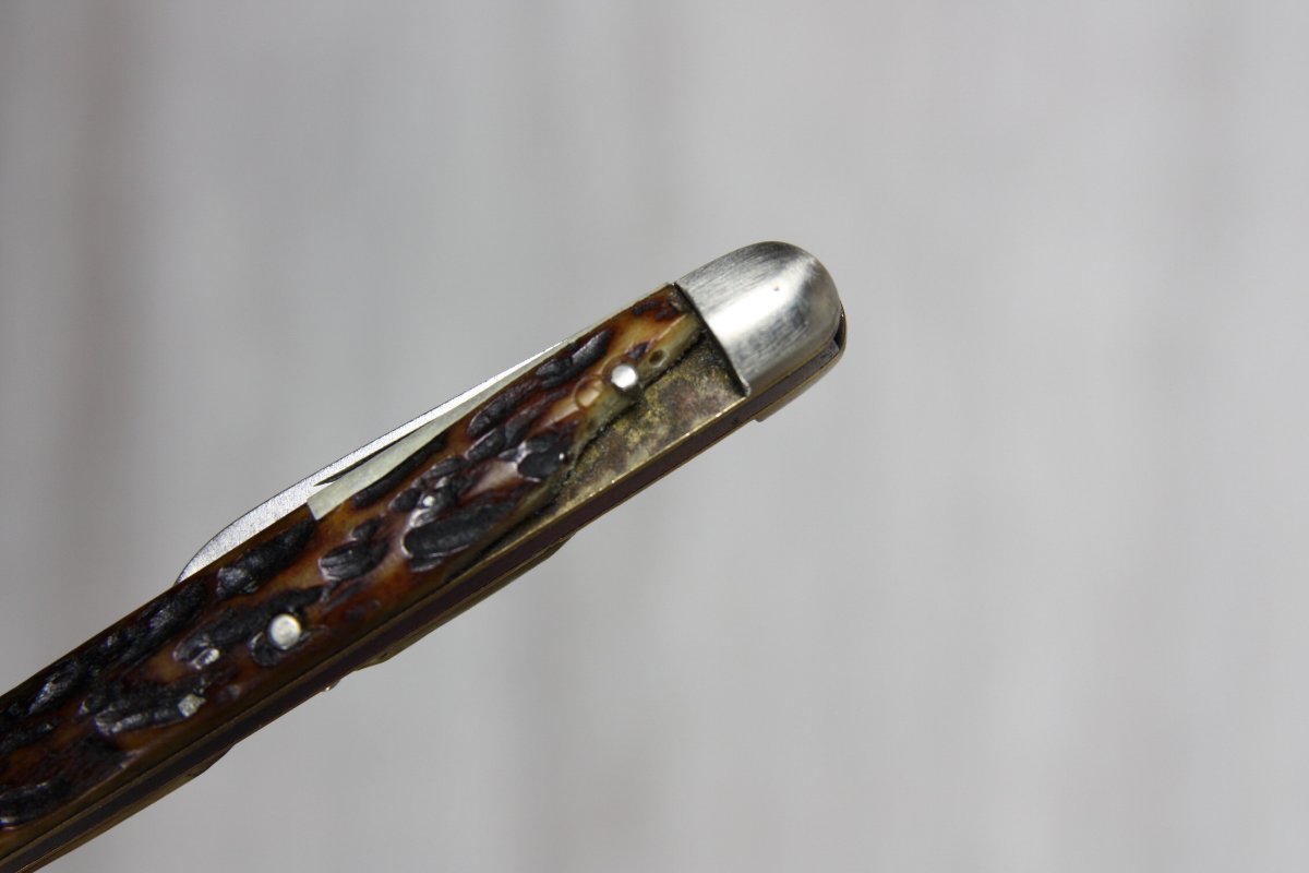

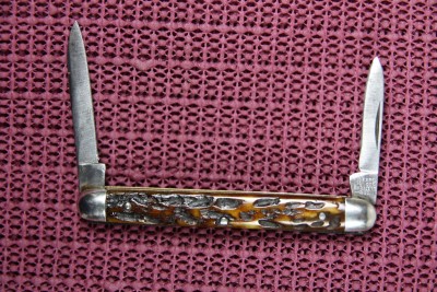

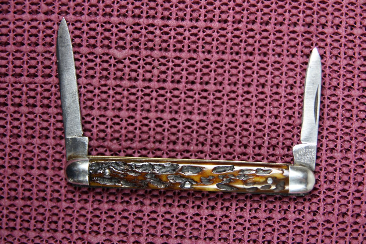

This is the latest Acra-Glas patch job I did on this 2 and 7/8" bone handled Hibbard, Spencer, & Bartlett pen knife that I picked up for $3 at the fleamarket. It had 3 pieces of bone missing, 2 on the mark side and 1 on the pile side.
1/32" holes to anchor the Acra-Glas
Finished

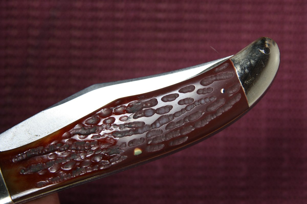

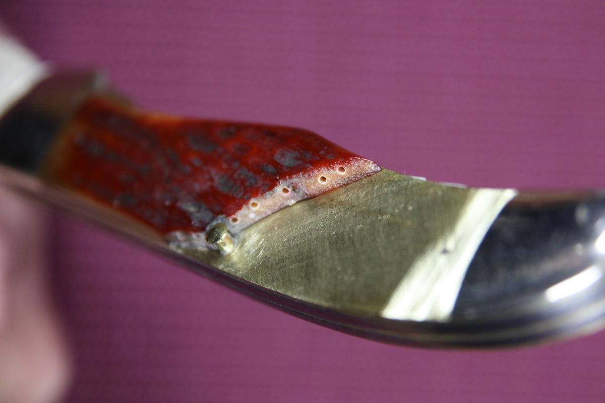

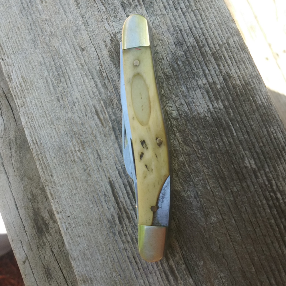

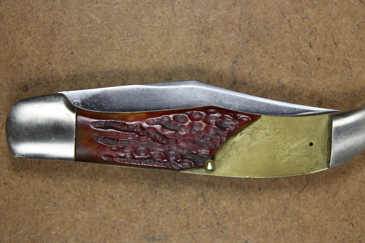

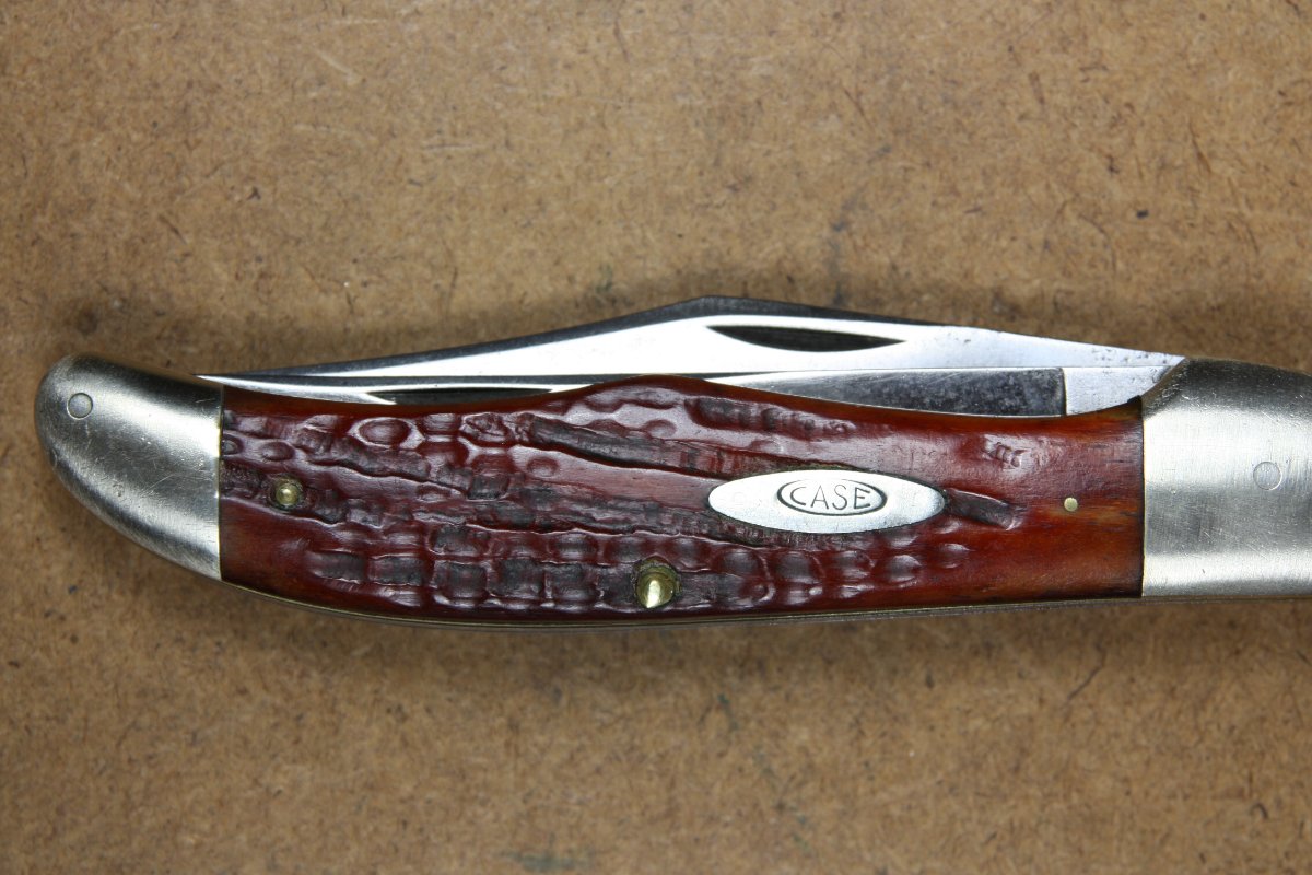

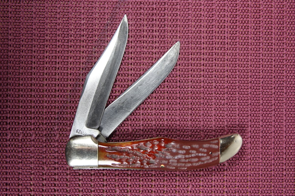

I got this Case XX 6265 from my brother in laws estate a few months ago. He had shown it to me years ago and wanted me to rehandle it for him WHEN he had found a donor knife to replace just the pile side scale. Well that never happened and I bought it from the estate to take on trying to fix it. After considering several ways to do it, I finally decided the best bet was to try to keep it as original as possible. So an Acra-Glas repair was done. This is the biggest "pour" I had done, but did not have any problems with it.
1/32 inch holes drilled into the bone to anchor the Acra-Glas. Pour a little of the Acra-Glas and use a toothpick to push it into these holes to remove trapped air.

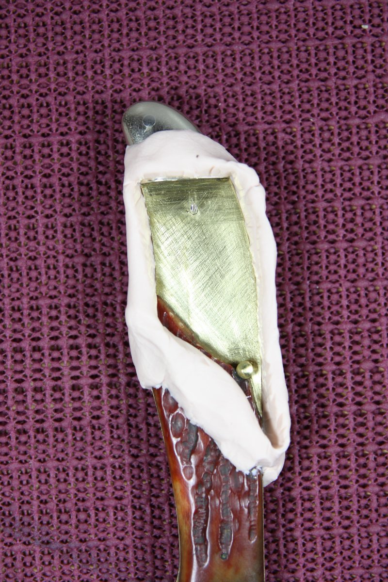

The "moat" to contain the Acra-Glas, used modeling clay.
The jigging on the front for comparison.
Finished product, Acra-Glas texture is somewhat different than bone, and polishing results in a different sheen, but the knife is back to being a user. Note handle pin embedded into the Acra-glas to also aid in anchoring it.
