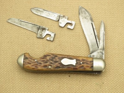

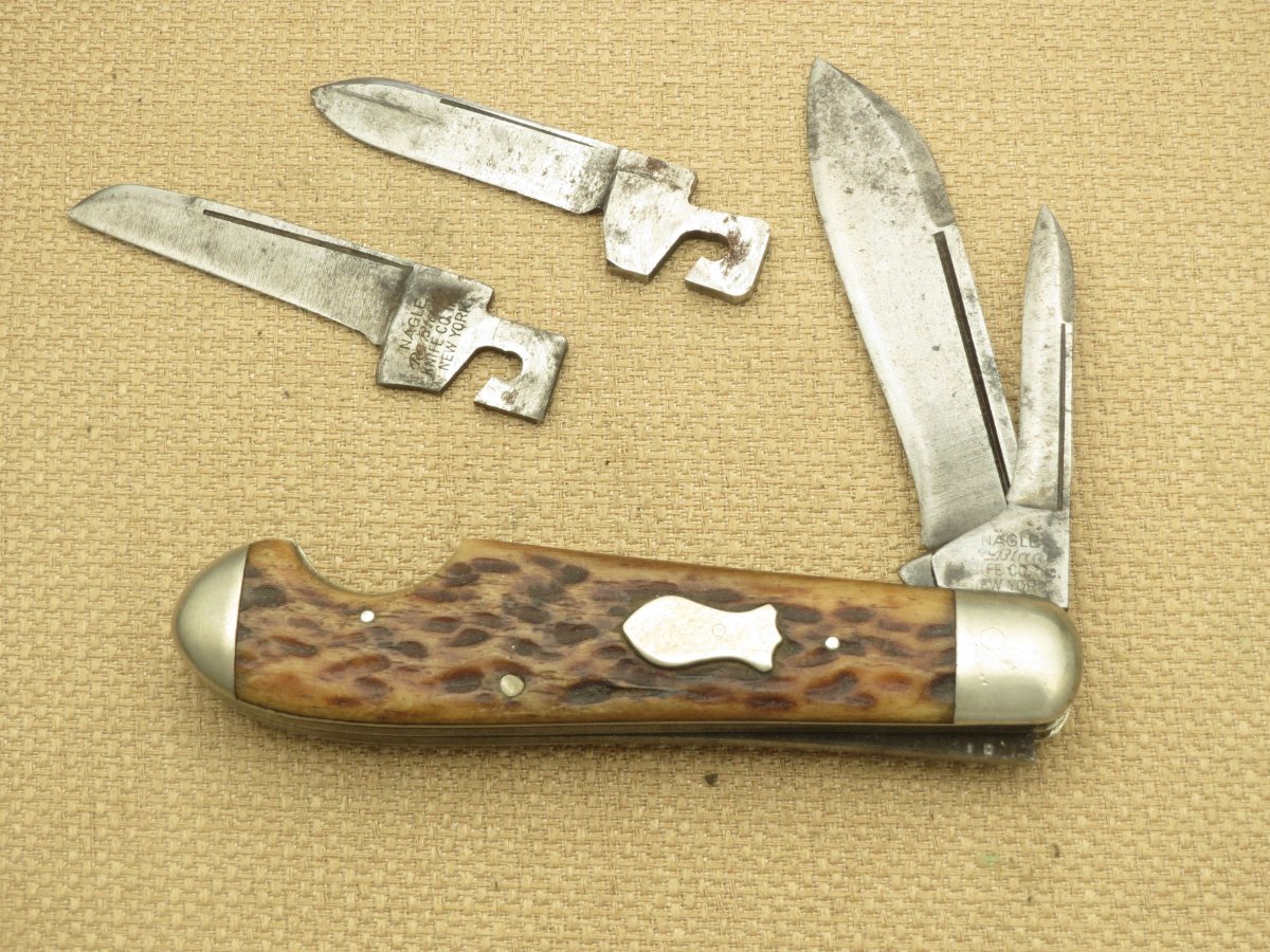

I recently got this Nagle Reblade knife with two extra blades. Can anyone instruct me as to how to get the blades out and put the replacement blades in?
I can't figure that out and I don't want to damage it.
