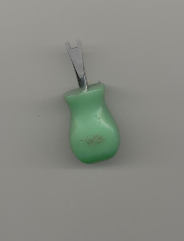

Easy to make. I used an old stub srewdriver and filed the notch in the blade with a pattern file.Takes about 10 minutes.You can buy cheap straight screwdrivers and convert them so you have different sizes if you like.This one fits a bunch of different knives I own. You don't need a lot of torque to tighten those nuts so the stubby works fine.

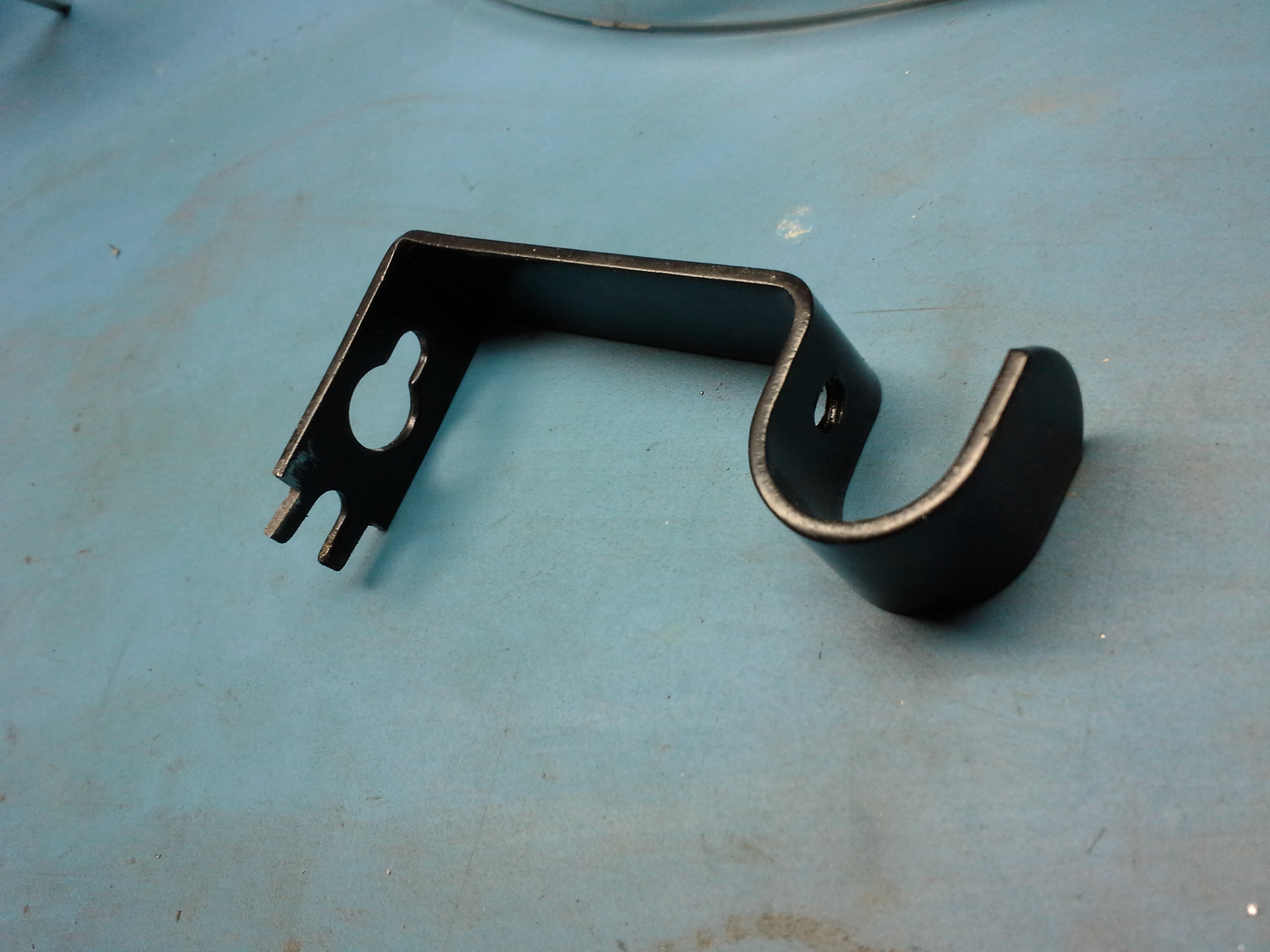

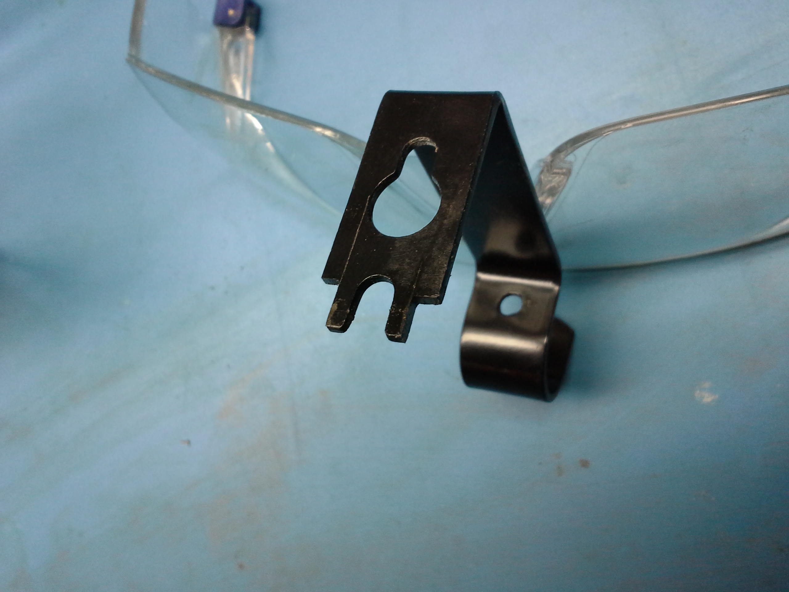

Made mine from a metal curtain rod bracket. Had this lying around in the junk drawer. Only needed to file the sides. The center slot was the right size.
Doug
