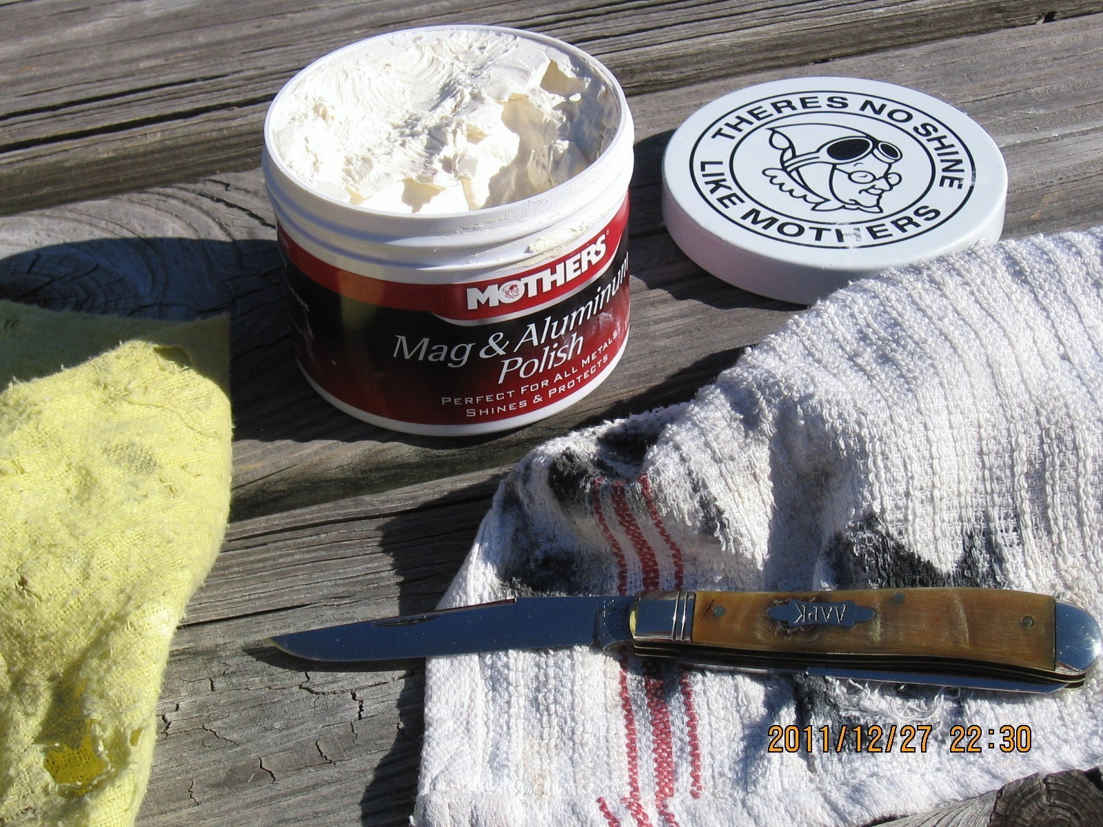

I use "Mother's"" to clean with--a drop or two of mineral oil on the joints,after cleaning--then Ren-Wax,the entire knife,for protection,before storage or display***
