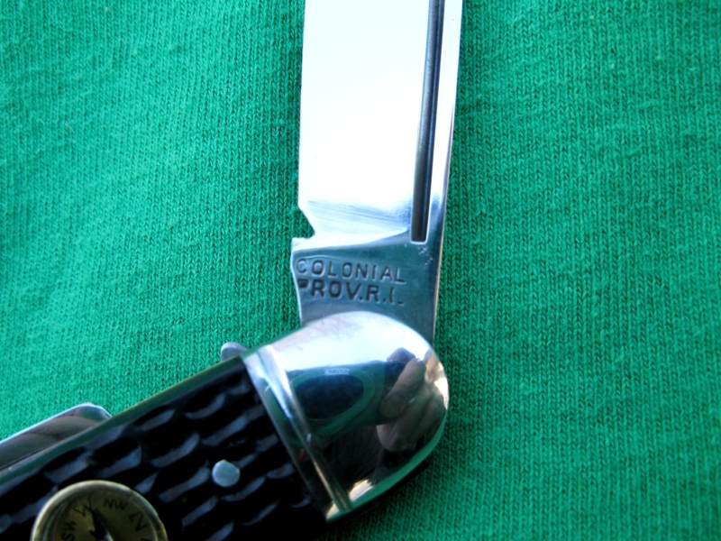

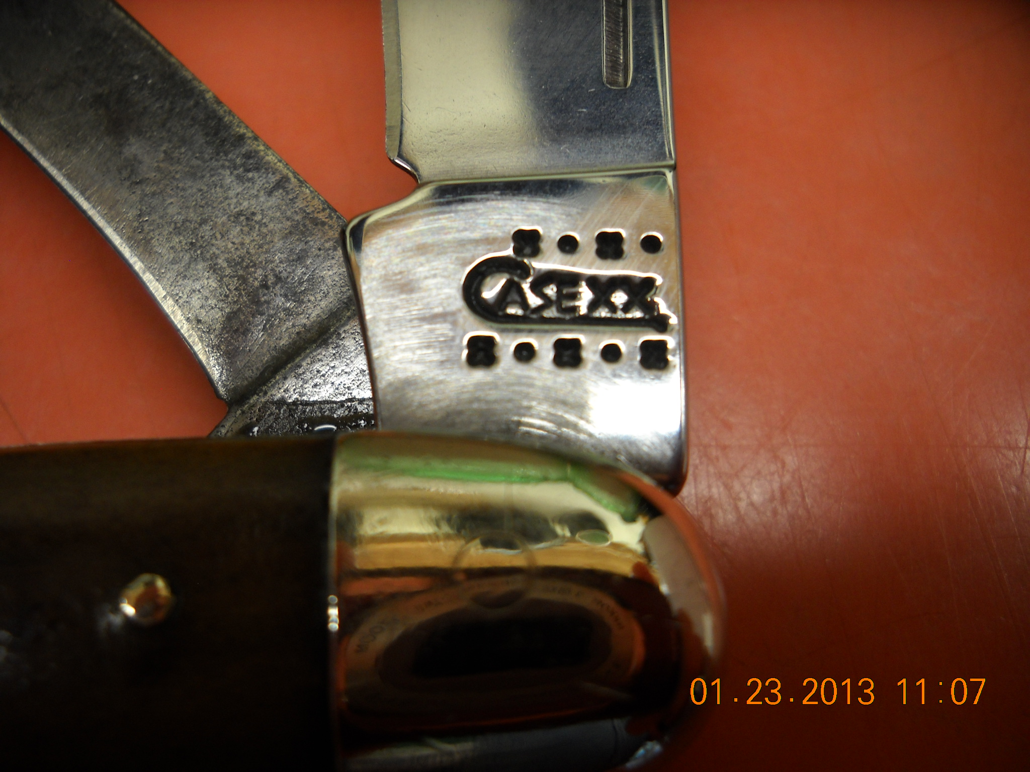

Jerry, my Case knives are from various era's, most all modern era (post-1969), and thus the stamps vary in design and are harder to compare but they do vary in depth of striking from "normal" to pretty deep. My biggest collection of knives with the same stamp are 300 series Bucks made by Camillus and 100 series made by Buck in CA - I look at a lot of them in addition to the ones I own. The tang stamp depth or "striking" certainly varies - a few will be quite light and some are very deep - most (of course) are right there at the "baby bear" level - not too deep, not too light. Some have extraneous marks on them - a stray mark that got there somehow unintentionally but didn't cause the knife to be rejected for sale. I have a recently bought (last summer) Bear & Son Stockman which has half of the asterisk mark they use for date codes - makes me unsure if it was intended to be there or not, but what was the year was made? OH
Ps. just check out 1970's Case "dots" - some are higher on the tang than others on the same model of knife - on some you can count them easily and on some they are so low you can only guess - the bolster hides them completely and you cannot see them at all (unless you disassemble the knife).

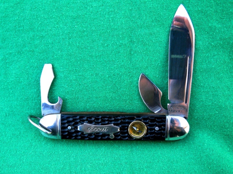

I am enjoying this fine discussion! Adding my 2 cents with a picture of a tang stamp on a blade that was replaced for me by an AAPK member. I asked him the question, "Was the replacement blade a 2nd?" The member said it was a blade out of a parts knife he had bought. This being a 2001 blade, shows again that placement of a tang stamp on a blade is not an exact science. All the logic that others have mentioned concerning manufacturing, era, condition of dies, financial condition, etc.. should certainly be factored into determining what is or is not a "real" knife. Takes a lot more knowledge than I have, but none the less it is very intresting. Treefarmer

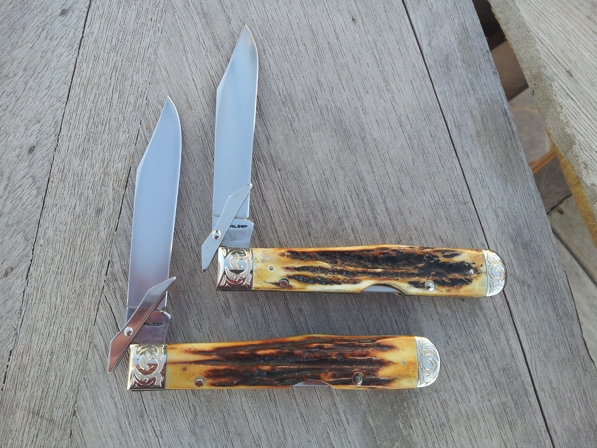

Back to off center stamps...

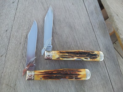

So i just got these 2 identical CASE 1977' 5111-1/2LSSP "Blue Scroll" Engraved Cheetah knives in on Friday. Identical besides serial numbers and stag fingerprint. Rare knives, 1000 made. Both stamped with serial number above tang shoulder. The blades and swinguards on theses knives have absolutely no play, wobble or slop. Very tight. Here is my point, please look at the attached pic. Tangs are the same hieght and width but the stamp location is different. You can really tell on the pile side model stamps. There is a 1/32" or more difference in the location of the stamp hieght. Don't have a pic but when the knives are locked and open, using the swing guard as reference, location difference is clearly seen. Top knive model stamp is about 1/32" above the swing guard where as the bottom knife's model stamp is partially obscured by the swing guard. Does not make either knife altered or a fake, just slighty different. Money back guarantee, seller cover all shipping, I kept both as it is rare knife. I have another example of this knife on the way, I will check it out and see how it compares.
This is where obviously reading the entire knife comes into play into play, in my opinion. I recently had a non CASE cattle whittler knife I gave to a knife buddy. The knife has been posted here and no one can pinpoint the stamp and blade etch as far as manufacturer through books, internet seraches and gained knowledge. Some very knowledge members researched it and chimed in. Mystery knife for now. No one knows at this time. The knife is solid and well made. My point is this, to my recollection, not one member stated "never seen one, not on the internet, not in my books, so it must be a fake. They read the rest of the knife.
Obvious unspoken common sense apllies here. If something looks totally off, that is one thing. I personally look at my knives very carefully to learn as much as I can. Sometimes for a couple of hours on one knife. My point is, I personally don't overanylze every minor imperfection if the knife "reads well as a whole", as they occurred sometimes as part of the manufacturing process for various reasons. Just they way I do it. Your approach and opinion may vary and I respect that.

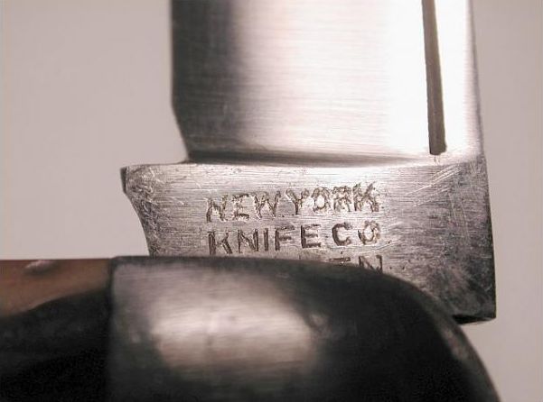

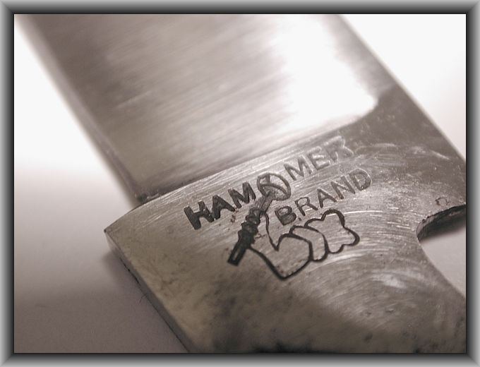

Good question, I would have thought there would be more responses than this.
Here is a picture of a tang stamp, question: is it real or counterfeit?

Dimitri:It looks like a genuine stamp that someone has tried to bring out by the use of a die grinder with a really small bit.It also looks like the choil has been reworked too.Blade looks to have been polished with fine sandpaper.Miller Bro`s wrote:Good question, I would have thought there would be more responses than this.

I really don't know enough about counterfit knives to be 100% sure on anything, but my thoughts are
that a genuine knife that has any amount of rust or pitting at the tang and is cleaned, ground, polished may
well end up with a stamp that looks worse than a high end fake. Any knife that shows that it has been cleaned
extensively can have the original stamp shallowed and the edges of the characters rolled or marred. The best
course of action when looking at a rough stamp is to read the entire knife. Not every original knife will have
a pristine stamp and not every fake will have a poor one. I know this is not a real straight forward answer
Jerry, but there isn't a single answer to your question. Look close, ask folks here and be careful is about
all a guy can do.

Miller Bros stamp looks like crap but is probably authentic. Like a lot of knives it appears that it has been heavily cleaned, this cleaning has left the tang stamp looking as it appears now. It may be that the "New York", being further out on the blade received the brunt of the cleaning whereas the "Knife Co" being closer to the bolster came through the process little worse for wear (notice the square ends of the letters). If you rely too heavily on tang stamps to determine authenticity, you're going to pass on a lot of authentic knives.
Bernard Levine's advice to "read the knife, not the stamp" is still the best guide.

All good responses so far.
I have intentionally not shown the rest of the knife so the focus is solely on the tang stamp, being this is what this thread is about.
Now would a tang stamp such as the one I posted be allowed out the door of a knife factory, assuming it is authentic??

Hey Dimitri,Miller Bro`s wrote: Now would a tang stamp such as the one I posted be allowed out the door of a knife factory, assuming it is authentic??
Assuming the knife is authentic, I would say "YES". If the rest of the knife was is expected good working order for it's intended purpose, as a "tool", absolutely out the factory door. Especially in depressed economic times and the whole " most important as a good working tool versus aesthetically perfect" factor. Not to say the cutlers did not take pride in their work and strive for perfection on all of the knife aspects. Just not going to throw away a good sharp, solid blade for that stamp, in my opinion, due to frugality.
What is the era of that knife? Going to speculate and say 1900' to 1930'. Timeframe of such stamp factors in, also, just my opinion.
Could be out in left field with my comments on this knife but if it were a CASE knife posted with a stamp like that, my answer is the same, right or wrong, assuming TESTED era or prior..
Regards, Jerry

I'd say, they would. In fact, other then making sure it's readable, i'd question if quality control in those days would really even include looking at the tang stamp. If they were proud of their product, then they would want the stamp to be identifiable. Beyond that, I can't think that they'd reject a knife for a weak or poorly struck stamp. JMHO

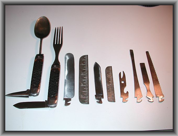

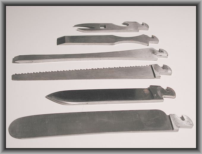

The picture of the stamped tang I posted is in fact an authentic N.Y. Knife Co. knife and is part of a tool kit with other implements.
The only other removable tool that is stamped is the spear point cutting blade and leather punch, see picture, usually all of these other tools are stamped, not the case here. Are the other tools fake? No, they just never got stamped, also note the brushed finish on the blades as was noted earlier by a member it looks like "they were polished with sand paper". In reality they came from the factory this way I have seen several of these kits with this finish, there is another member here that has the same kit with the same poor finish, not what you would expect from N.Y. Knife Co.
This kit is unused and almost as clean as the day it left the factory, so no one has played with it or tried to "clean it up" Take note of the other arm and hammer tang stamp, it is clear and as it should be, also the stamp on the leather punch is also clear.
N.Y Knife Co. made millions of knives during their years in business , and if the average knife has at least 2 blades then millions and millions of blades were made and stamped, if the stamp got worn they kept on using it till it broke or was completely illegible, the tang stamp used on the knife shown is not far from the end of it`s usable life. Knife companies were very frugal and never threw anything away, it usually went in the basement and sat there till they went out of business. The picture below is of dozens of these old tang stamps that I have that were found in the basement of an old knife factory in wooden boxes just quietly rusting away. Some are heavily worn and others look like they have never been used or only used a few times for a certain client then put away.
The lesson in the story and to answer the question posed by this thread is that many, many knives went out the door of knife factories back in the day that were FAR from perfect, lightly stamped, off center, misspelled, and badly worn. Always read the entire knife first, then worry about the tang stamp, with experience you will be able to tell if the tang stamp is fake, has been altered, or is original.

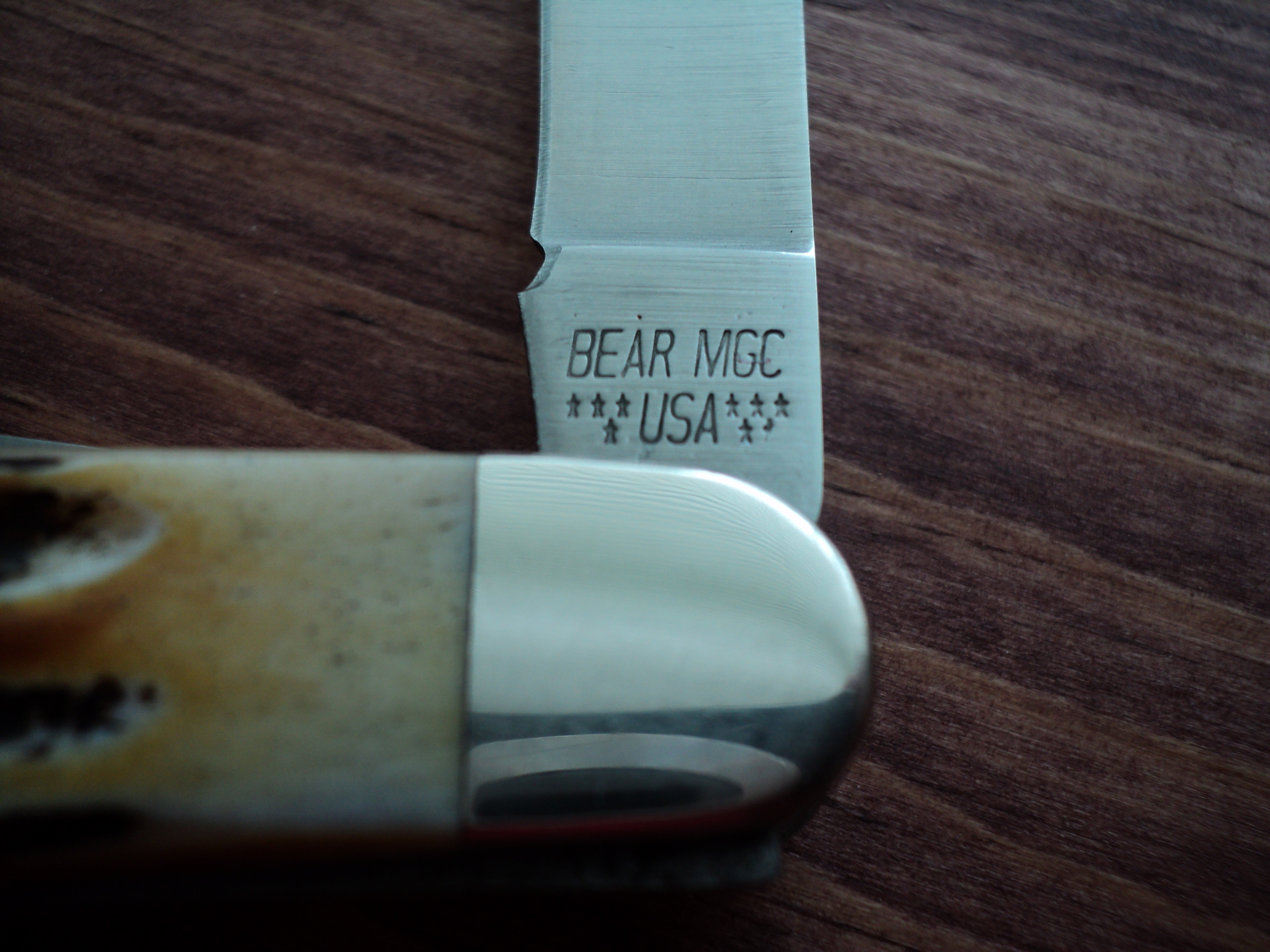

One more example of a well made knife with a poorly executed tang stamp that shipped; I've been following this Colonial Scout Knife on e-bay (out of curiosity, I'm not bidding on it). The tang stamp is clear, the old knife is nearly new, but the poorly centered tang stamp caused most of the letter "P" in PROV to be missed. OH
