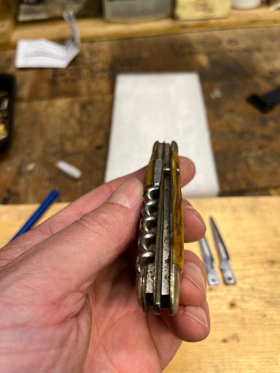

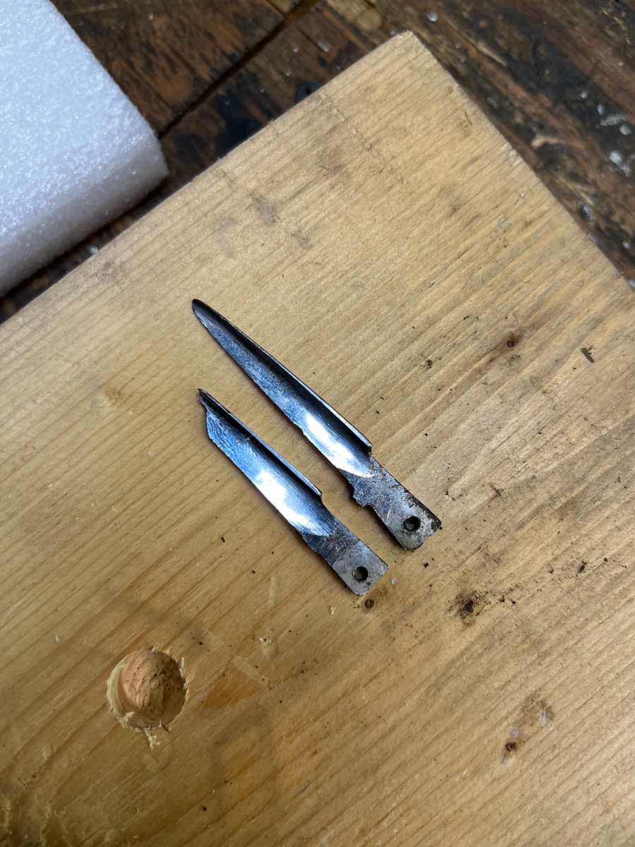

Here you can see the broken awl next to the donor awl.

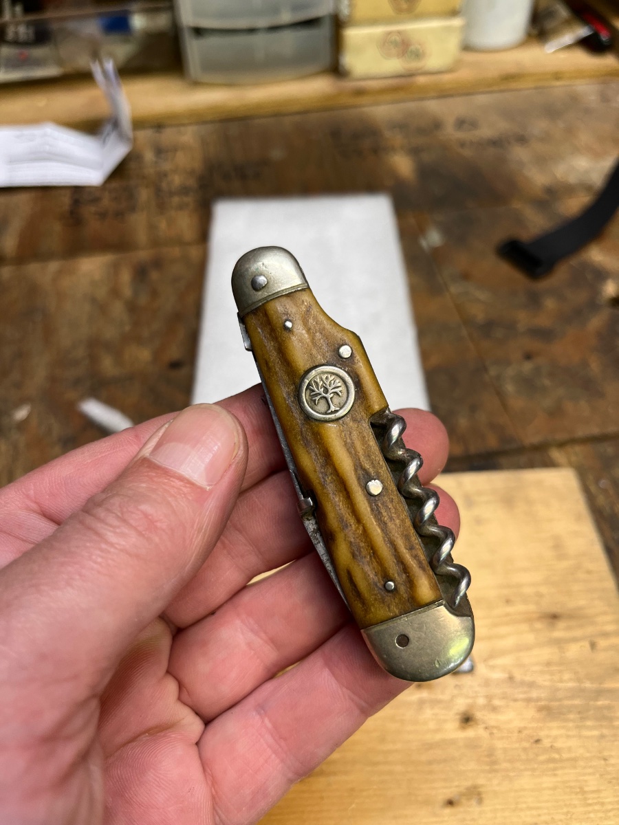

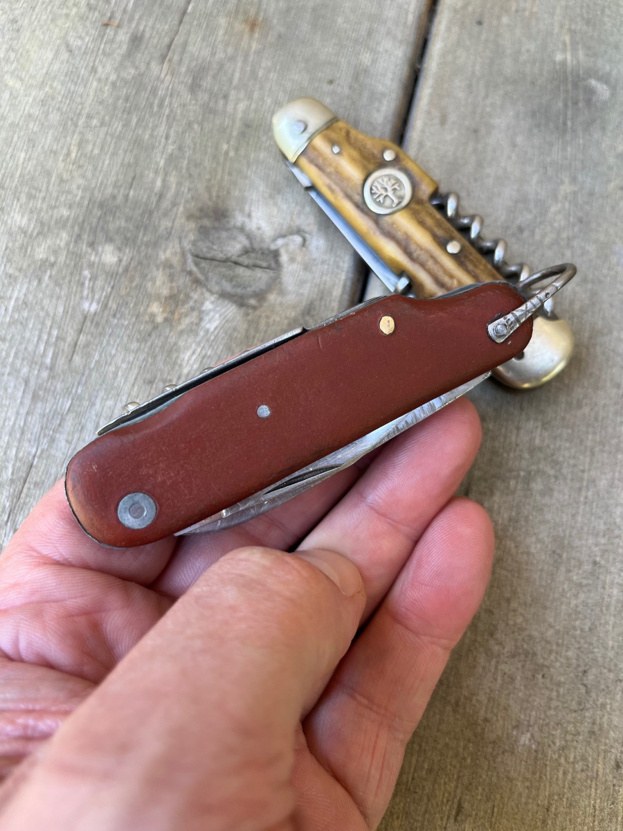

Here's the donor stag-scaled 182. Even broken these things are worth a lot of money.

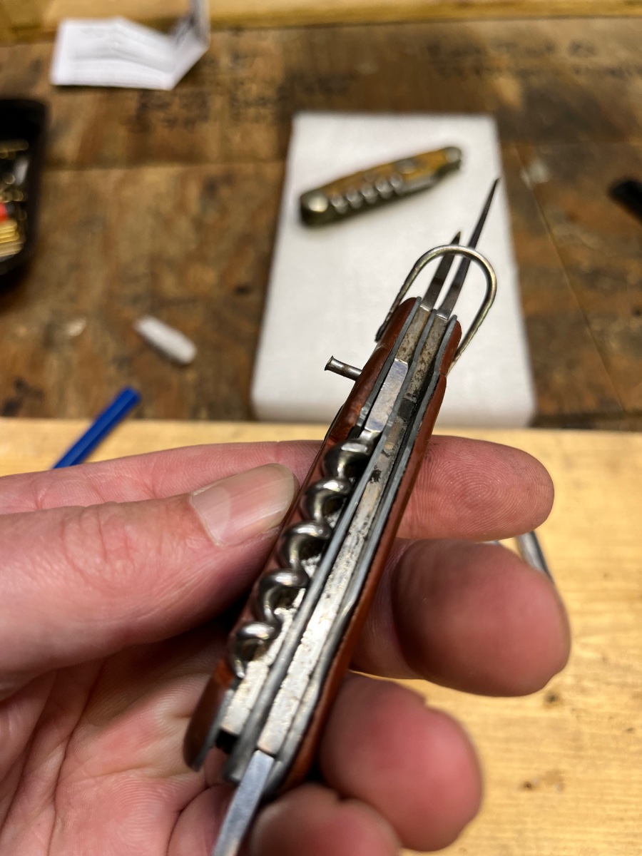

Using a pin drift, I carefully tapped the pin through the fiber knife. It looks like it's made of steel, which is a bummer because I only have brass pin stock to work with. Decision time -- Re-use the steel pin, which was a little too short anyway, give up and send the knife off to a pro, or substitute brass pin stock? I decided to replace the whole pin with the brass pin stock that I had. Here's the fiber 182 with the steel pin halfway removed and awl taken out.

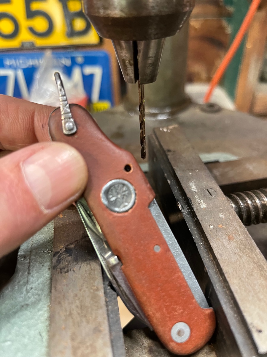

Test fitting revealed that the holes for the scales, liners, and implements were a just a hair misaligned and wonky. I thought long and hard before doing this, but finally decided to run a drill bit through the knife body and then the implements individually. My technique worked and further test fitting showed everything lined up.

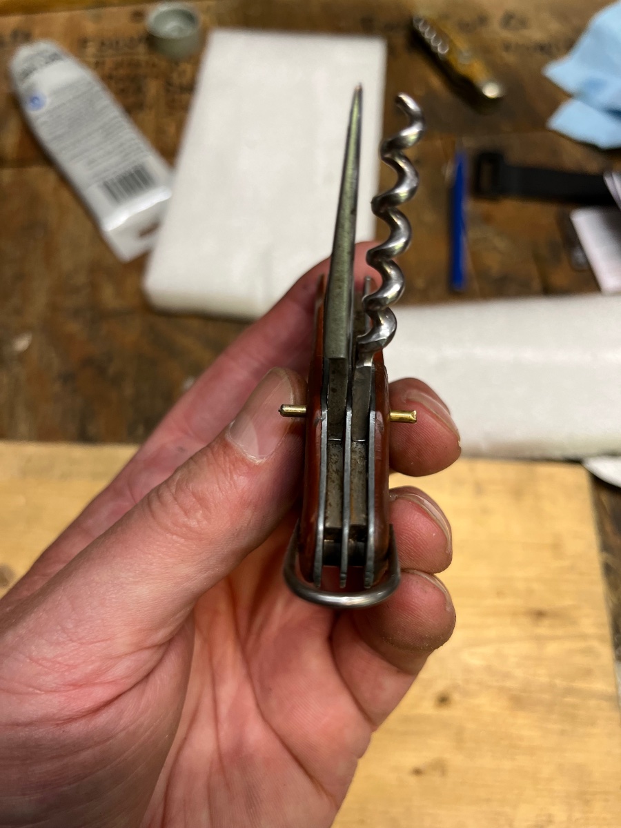

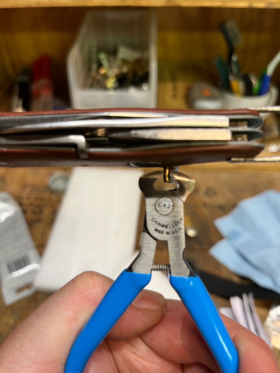

With the brass pin in place, I nipped off the ends using these micro nippers. Then all I had to do was peen them flush with the scales.

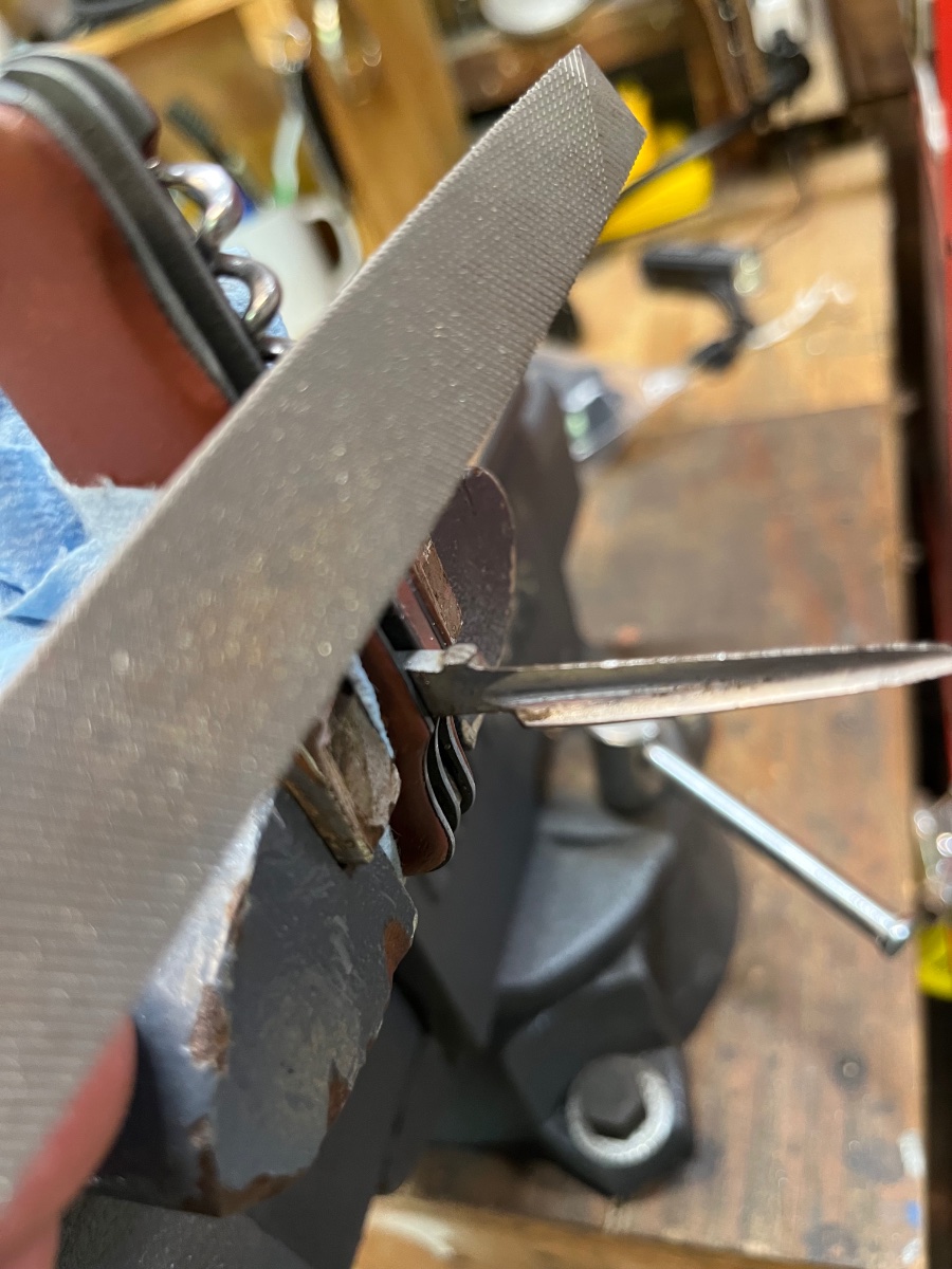

The knife was now very snappy, and I was happy with my flush-peening and the color of the brass, but there was another problem. The tip of the awl sat proud of the profile of the knife in its closed position. Enough that it would catch your pocket or your finger. Closer inspection revealed the cause -- there was a knob at the base of the awl that rests on the spring and keeps the awl in just the right position when folded in. The same knob on the original awl was much less pronounced. I get the feeling that back when this knife was made the knob was probably custom finished to each individual knife. Anyway, a few passes over it with a file reduced its profile just so, and now the awl fits perfectly in its happy place when folded in.

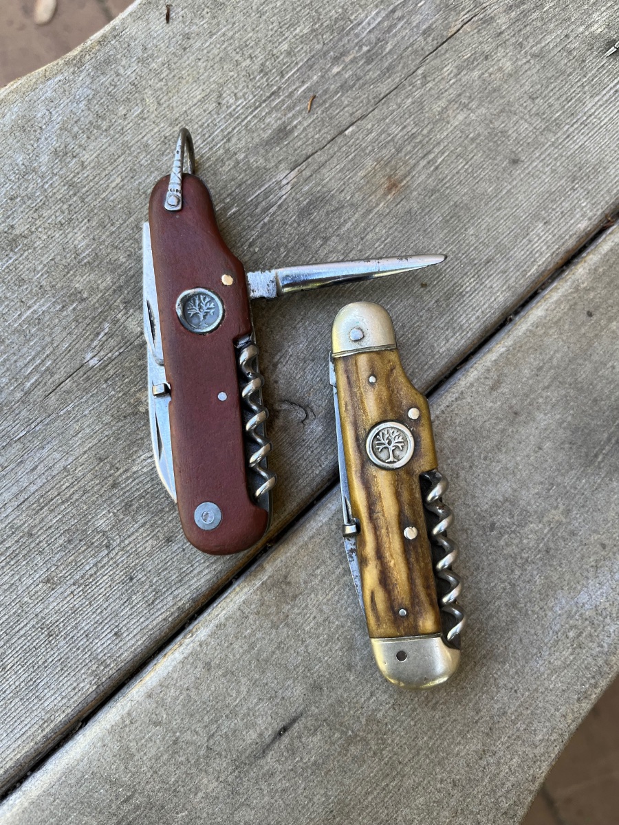

Ok, here's the completed knife next to the donor:
And here's the tidy fit of the new awl when folded in.

FYI, whenever I reassemble a knife with steel or cast iron bolsters I use steel nails for pinstock. Between the various sizes of common and finishing nails, I've got most sizes covered. I've even used them in a pinch when I didn't have the right size for NS bolsters and I didn't care about the color not matching. And another thing - that "knob" you mentioned at the base of the punch is called the "kick", and you did exactly the right thing by filing the kick down until the punch closed to the position you wanted it to sit in the frame. Most blades have a "kick", and that's what they are there for.
