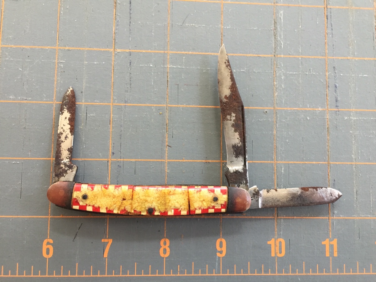

Purina Rehab...?

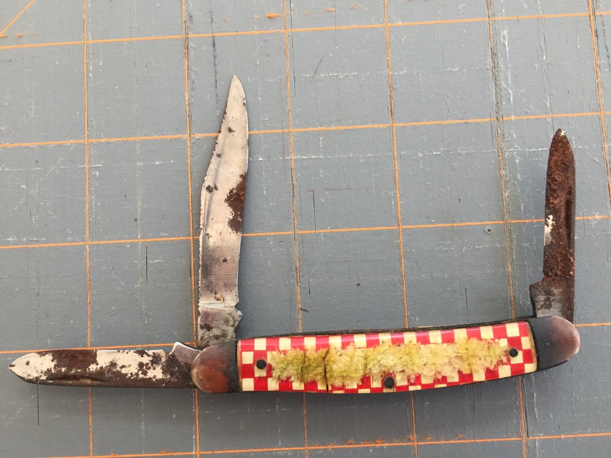

Someone didn't get the message about oiling the joints...or any other part, for that matter.
Recently TPK, AAPK's own poet...gave away several knives. Given, postage rates from Germany...his offer was extra generous. He offered up this Purina, if anyone thought they could do anything with it. I told him, my hallucination was I might be able to improve on it; but, I'd send it back to him. Tom has a special connection to the Purina knives, because his grandfather carried them. I set a personal record, for number of pieces, that a handle came off in... The corrosion was so extensive, the liners cracked and broke...almost by looking at them..
Sometimes I hallucinate a little too much. Stayed tuned.

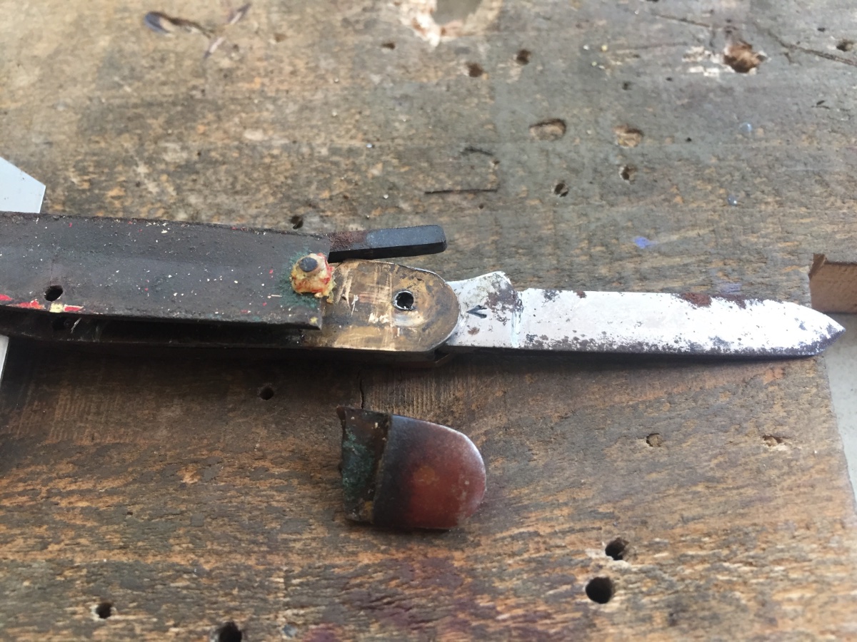

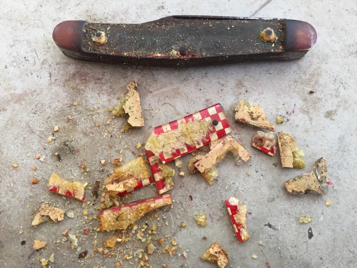

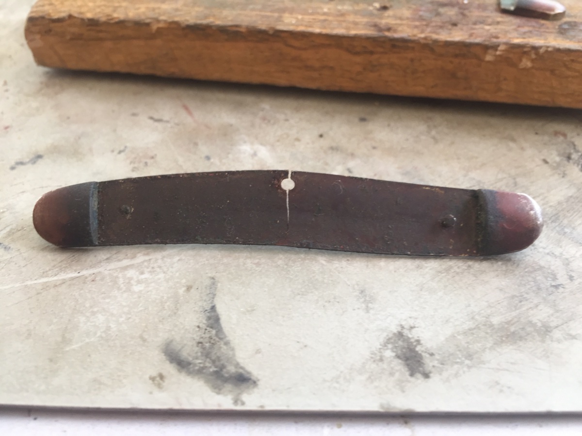

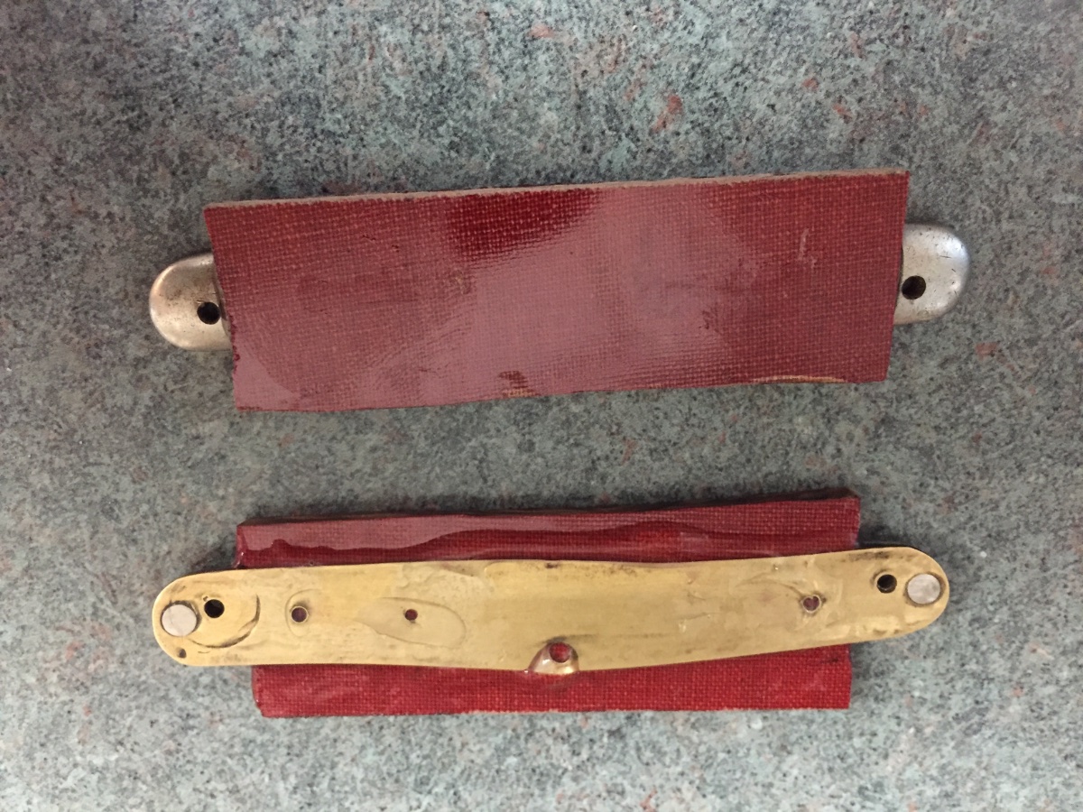

So...I got wondering...if I could solder a piece of old liner, across the cracks. Guess I lost the pictures of that failure. The soldered piece, across the crack seemed to work...but the soldered piece across the entire broken component, near the bolsters, didn't have any strength. I think it was good it failed, because it would have been a serious pain to retrofit the handle, over the raised patch.

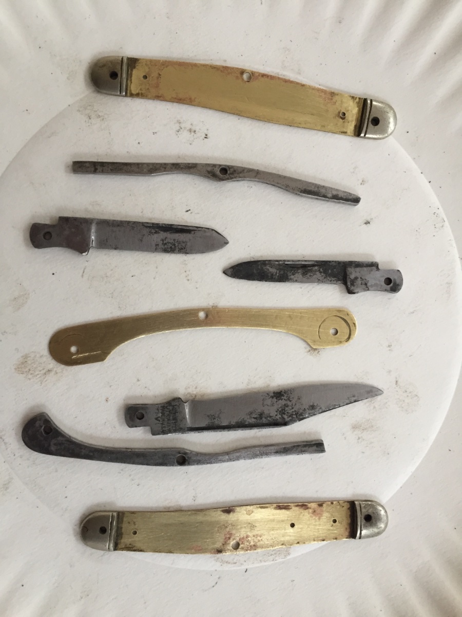

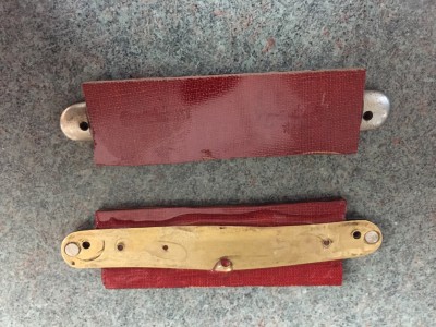

I had no brass material for fabricating new liners...so I got to digging around some old boxes.
Came up with this worn-out Boker, blades mostly used up and wobbly. It looked pretty close in size... Got things all pulled apart , cleaned up. Blades had some deep pitting in ares. I selectively sanded...but removing all of the darkness, on the blades, would have entailed removing a lot of metal. I mocked things up, with several different combinations, of blades, springs, etc.
I ended up using the liners and springs from the Boker. One of the initial problems of the Purina, was a poor snap. I found by using the Boker springs and making some minor modifications, It made the snap, better than it had been originally.

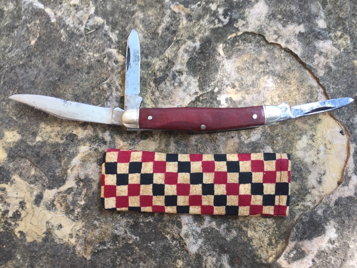

Thought I'd go with a "Red" micarta...staying with some original color, in the Purina. Then I thought about making a shield...that would give a nod to the old checkerboard pattern...

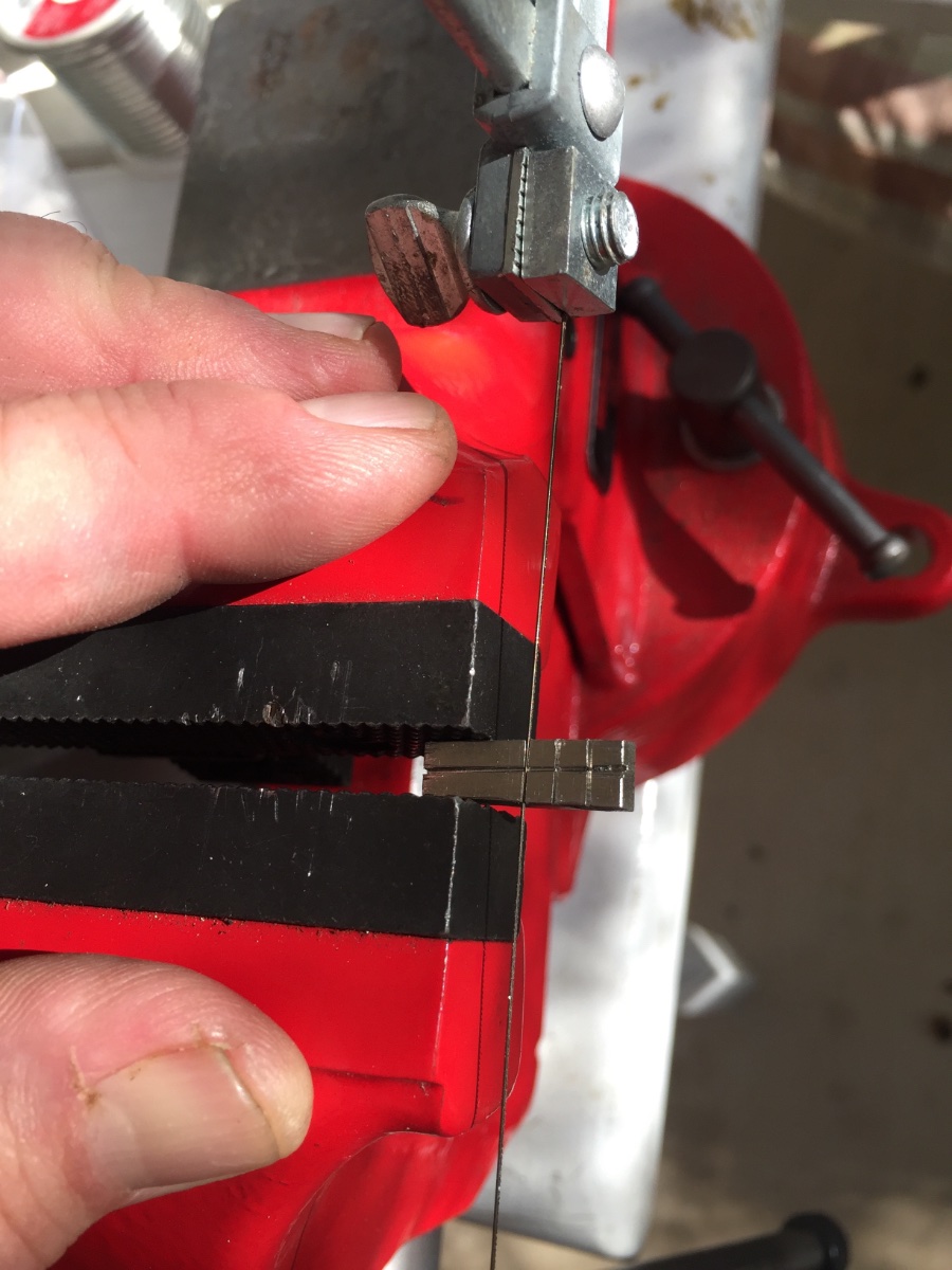

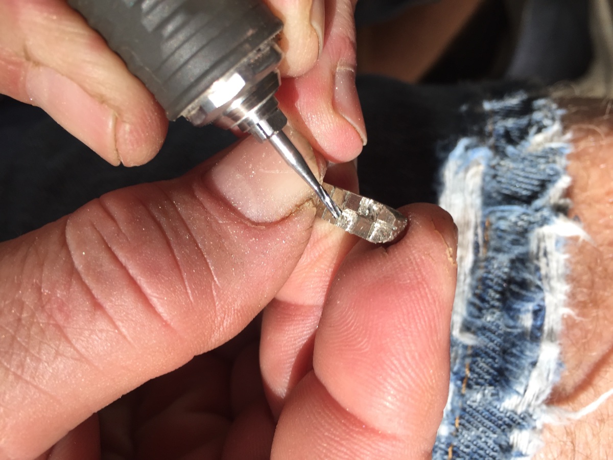

Initially sawing on a piece of nickle silver, with a thin jeweler's saw.. More to come.

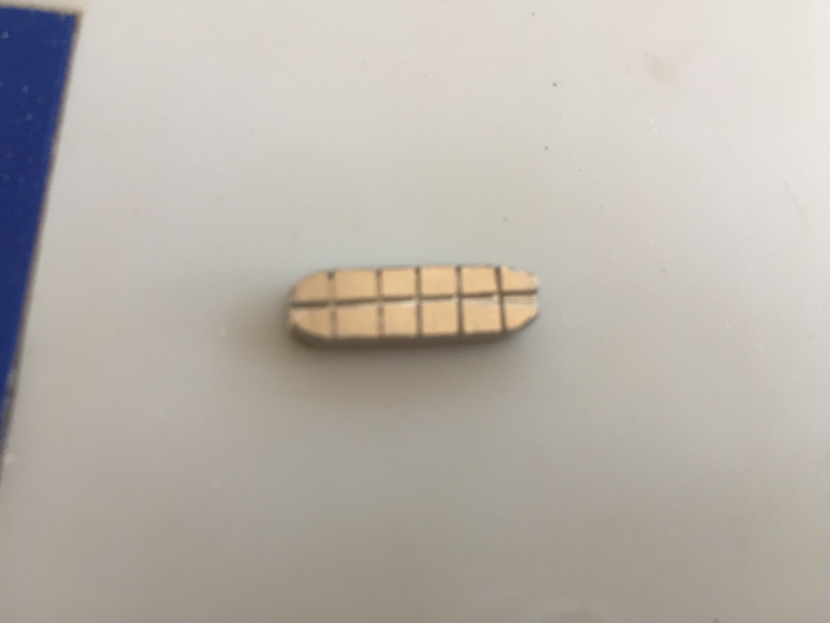

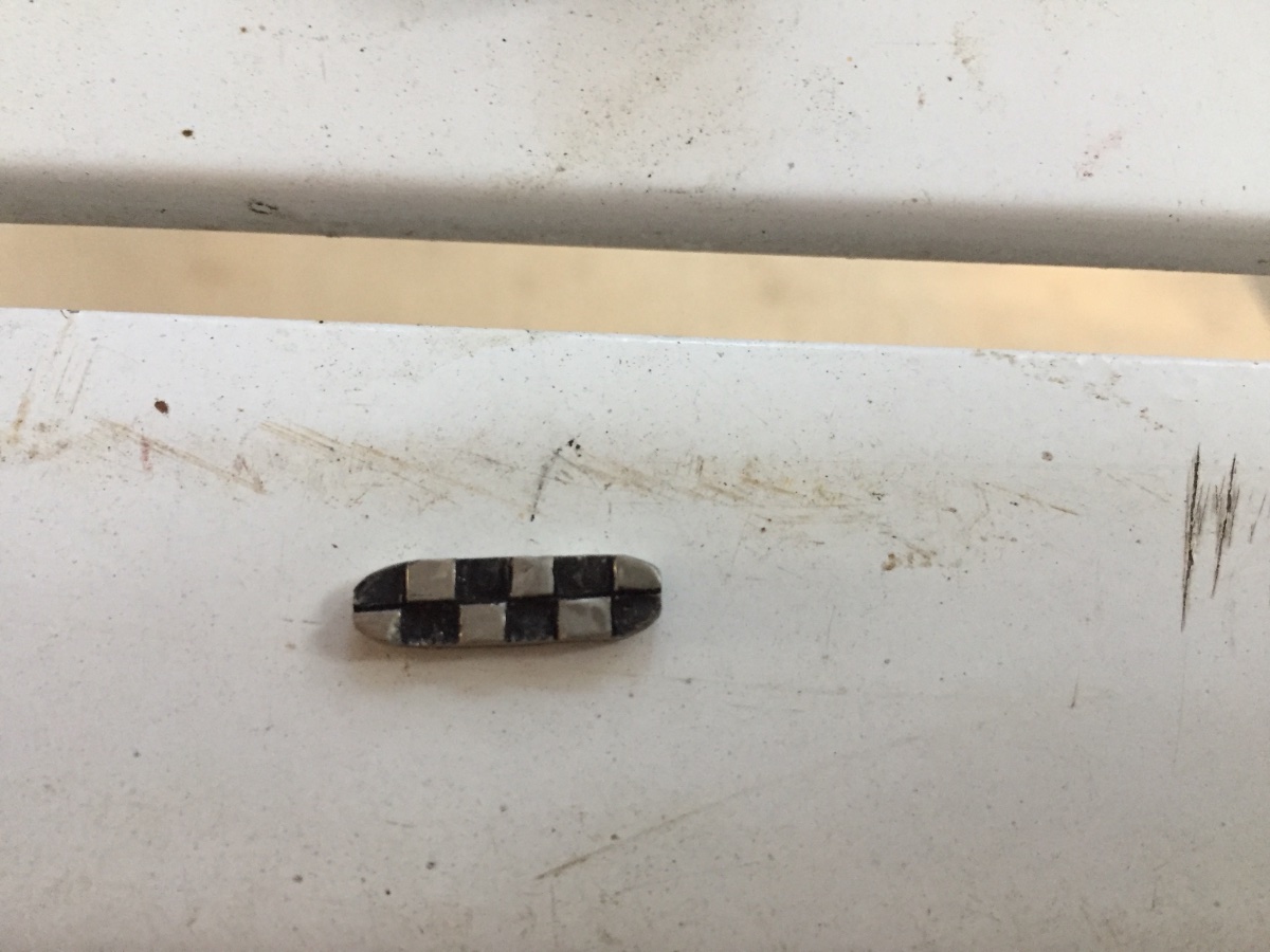

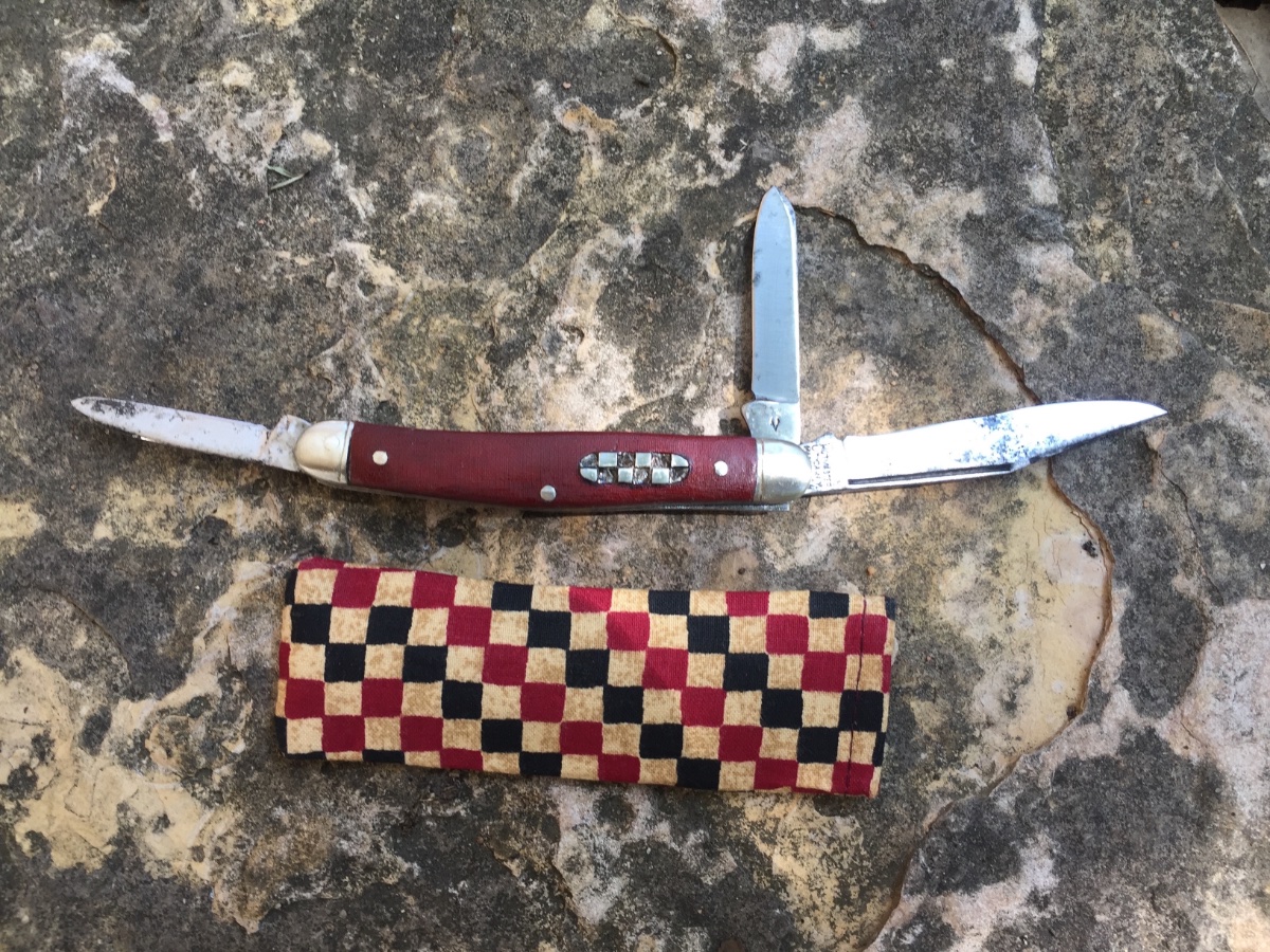

Scribed with saw and rounded...
Reducing every other square...
I oxidized the entire thing, with gun bluing...then polished off the high points.
Finished it out...and Mama (the sew-a-holic) wanted to make a checkerboard slip.
I enjoyed working on it...and thinking about our Grandfather's and their knives. Hope it reminds you of your granddad, Tom.

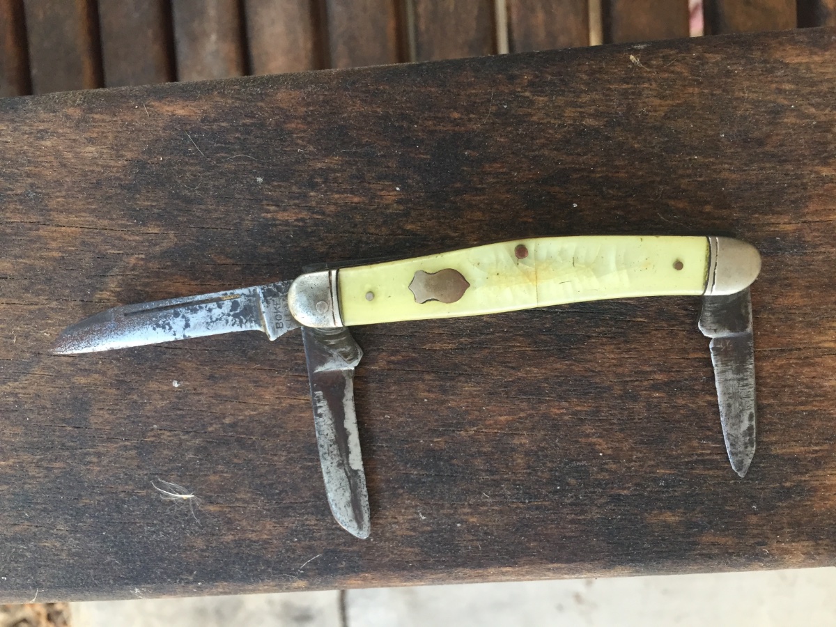

I knew how the story ends cause it came in the mail yesterday.
What I didn't know was how much work was behind it all.
As you all can see by those pictures, it turned out very nice and I am totally stoked!!!
I sat on the couch yesterday evening handling & admiring it for well over an hour. Felt like I was some kind of "Knife-Pervert" or something.
The Böker springs or Boker springs turned out to be just what she needed. It has great snap on all three blades now.
Plus, the thought of having Tree Brand parts or shell (with their strong ties to Germany) mixed together with blades from a N.Y. knife (with me being an American with strong ties to Germany) is kind of a cool thing for me as well.
Great idea, and a good thing you had that Boker. That worked out perfect!
It's definitly a one of a kind now...
A BOKER/KUTMASTER HYBRID!!!
Awesome!!!
And the shield is the hit!!! I thought he took something like a zipper or a filed off chain but WOW that's hand made. It's so darn cool you should give those a name Jim. I'm gonna call it a...... "Jim-Zip-Shield".
Thanks for all the hard work Jim!
It's a very beautiful knife now that will remind me of both my Grandfather and a great man from Texas who rebuilt it for me. Thanks to your wife as well for the awesome little pouch she made for it! The checker pattern in it and the "Jim-Zip-Shield" relate back to the original Purina checkerboard pattern.
Plus, the Slip is in Red-White-&-Blue.
It's the "Cherry on Top"!
If I could sew, I'd make myself a few more of those. They are cool and protective as well.
I also understand the meaning of the abbreviation "HOK" now because I own one.
Take care & have a nice weekend everbody,
Tom
