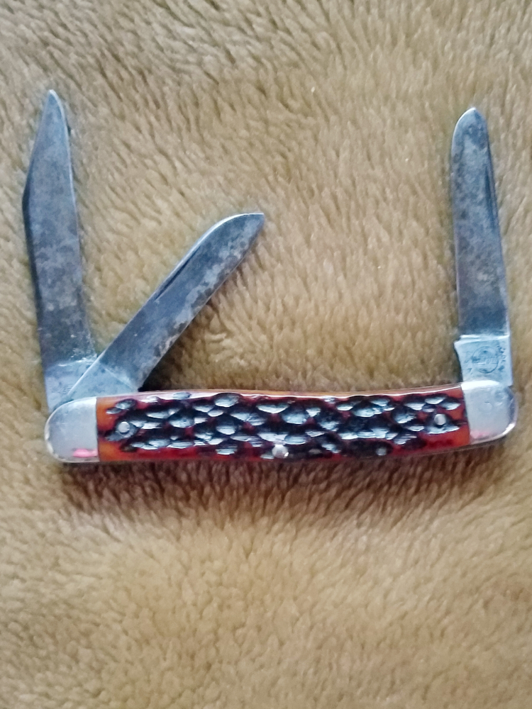

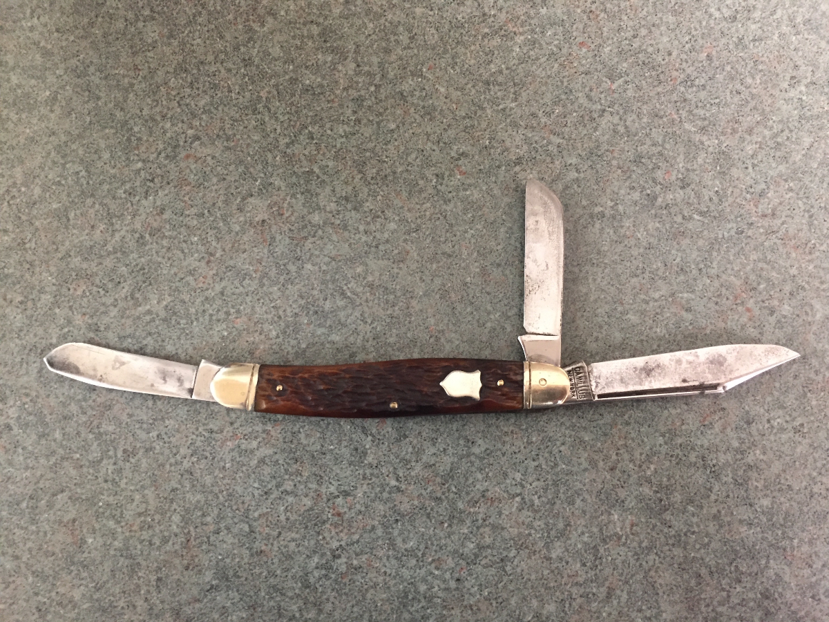

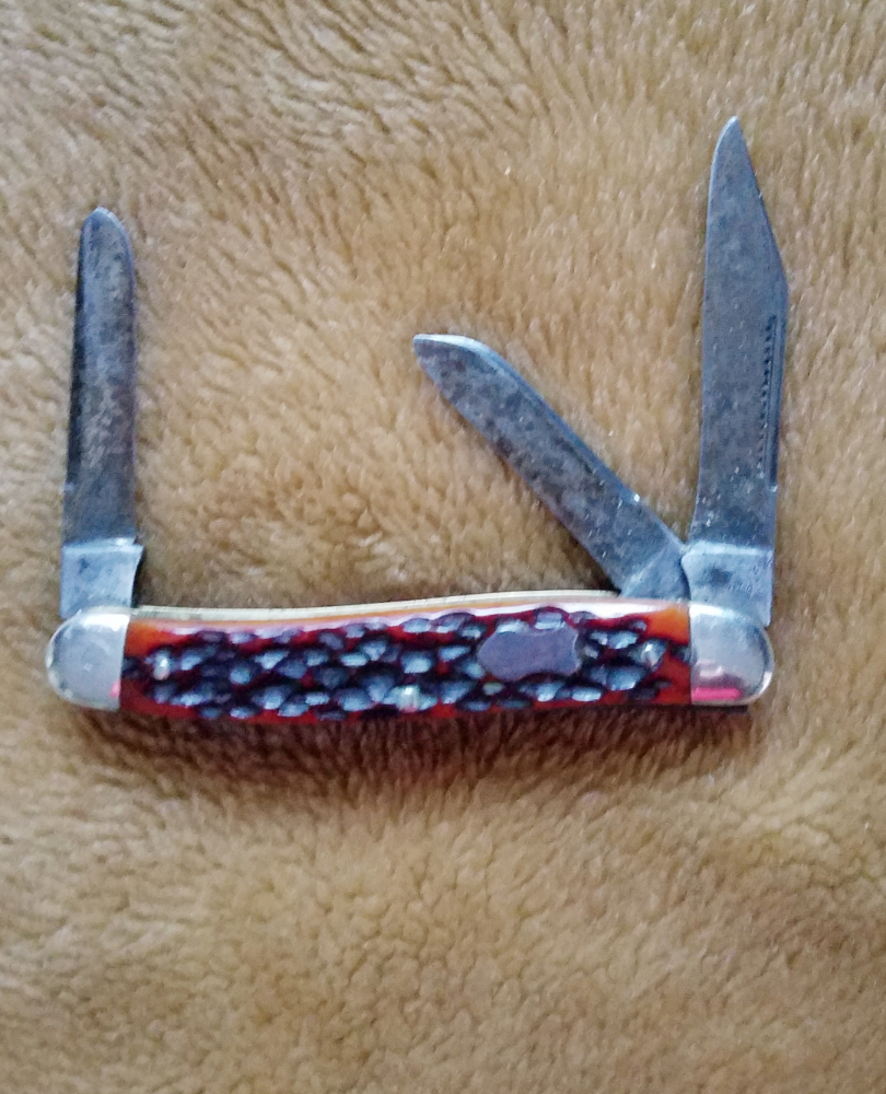

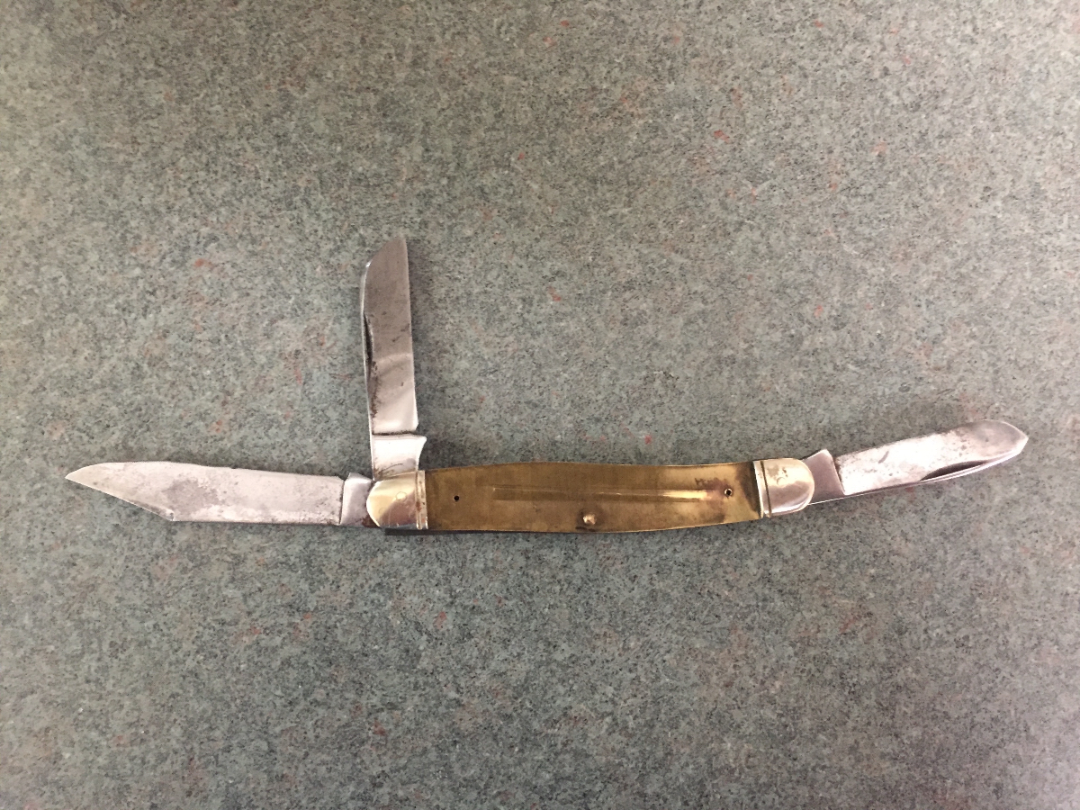

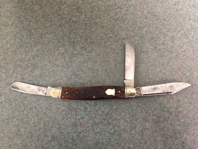

So here's my dilemma...I picked this knife up for 10 bucks. It's a Camillus Stockman. The front side is beautiful...appears to be Roger's Bone. Sadly, the back side is missing it's scale. I'll probably fix it and gift it. The beauty of gifting (to the people I give them to) is they don't "know any better" and are usually happy at the "before and after" transformation.
So what are' y'all's thoughts?
1) Get over it...throw the front scale in a "parts pile" and replace both with matching scales.
2) Replace only the missing scale with some other type of scale?
3) Watch "the Bay" for another donor knife?
And...could someone help me with the pattern number on this (3 7/8" closed length).
Any thoughts on years of manufacture?
Many thanks, in advance, for your thoughts!

I believe what you have there is a Camillus 67 and the handles are Delrin®, not bone. Were I in your shoes, I would put some nice bone on there. What ever shines your shoes. JMHO

Well, that would definitely get me to pull the front off, if it were Delrin. I looked at it with a 60x loupe. Sure thought I could see haversion canals and cell formation. Did they make any of this pattern with bone?
Edit: Just back...from outside, in bright sunlight, with the 60x. Both cross sectional and smooth areas on the top...It sure looks like bone.

Nice find for $10! I haven't seen one of those that wasn't delrin, but since you don't have the other scale I'd go with a complete rehandle. Many possibilities. Maybe smooth red bone or maybe OD green canvas micarta. From your picture, it looks like the front pivot pin is sinking into the bolster, so probably time for the full monty anyway. Just my humble opinion.

You are correct on the "sunken" pin...so good thoughts there.herbva wrote:Nice find for $10! I haven't seen one of those that wasn't delrin, but since you don't have the other scale I'd go with a complete rehandle. Many possibilities. Maybe smooth red bone or maybe OD green canvas micarta. From your picture, it looks like the front pivot pin is sinking into the bolster, so probably time for the full monty anyway. Just my humble opinion.

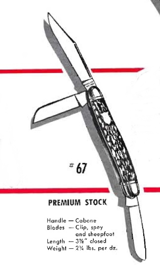

I found older Camillus catalogues (Pre 1960 / Pre Delrin)...with the 67 pattern listed as "Brownstag". I'm assuming that is some synthetic material. I'm guessing this may be it? It sure doesn't look like the more recent Delrin covers, that I've seen in Google images...that kind of orangish smooth Delrin.

By repairing this knife you are putting your own time and skill into it. This makes it a more special gift than one that had both original handles. The pre Delrin "brownstag" handles are a dull brown color, not like the front handle on this knife. If you are seeing dots when examined with a loupe it is bone. It is possible that someone removed the Delrin handles and replaced the front side with bone but did not get the rear handle installed.
I think matching jigged bone handles with the same shield on the front would be best for this knife.
