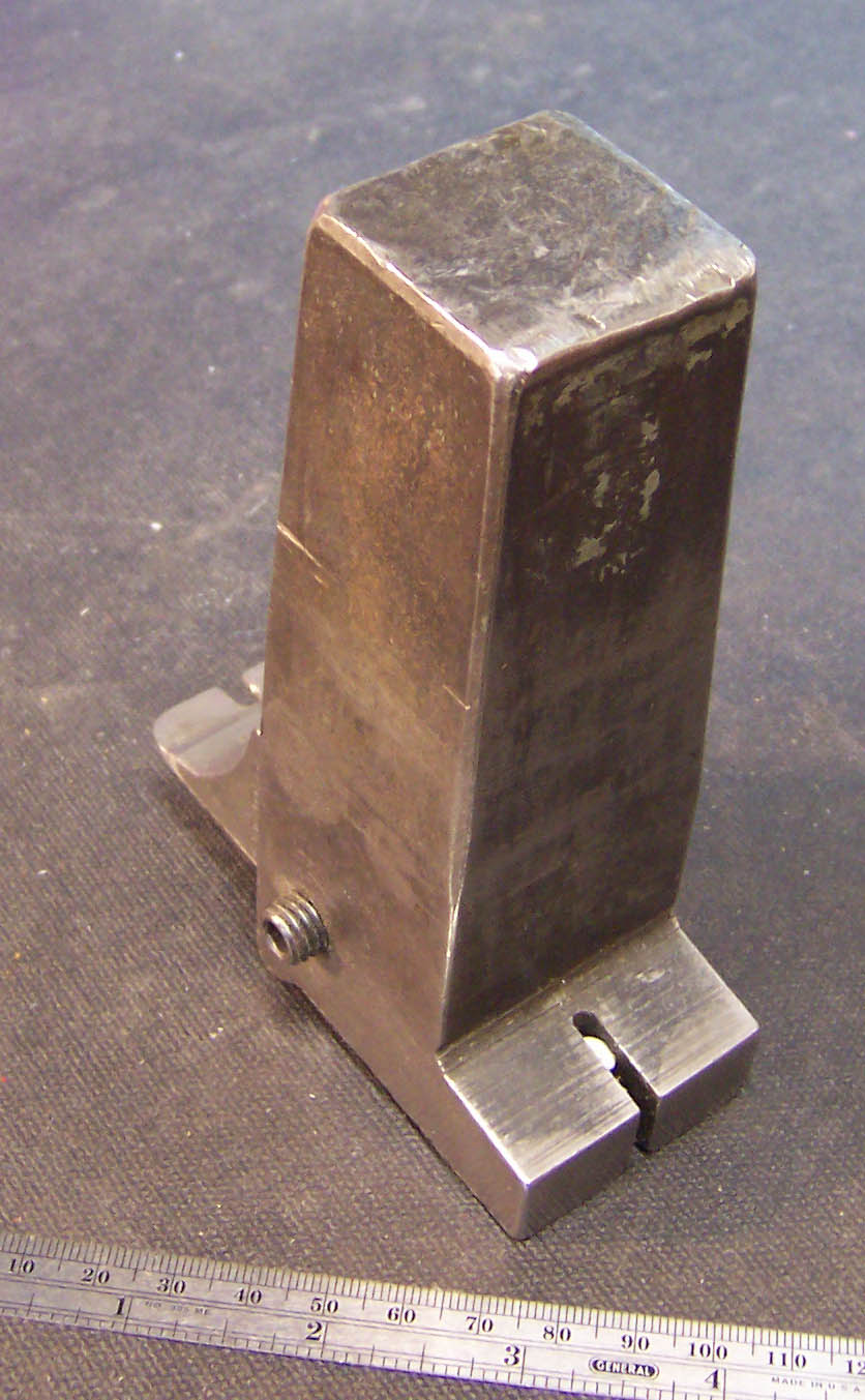

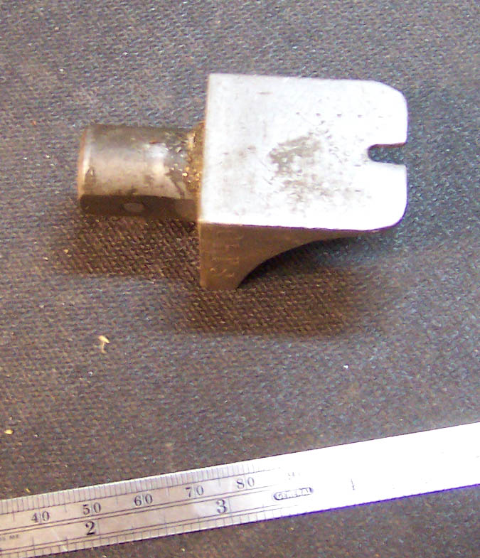

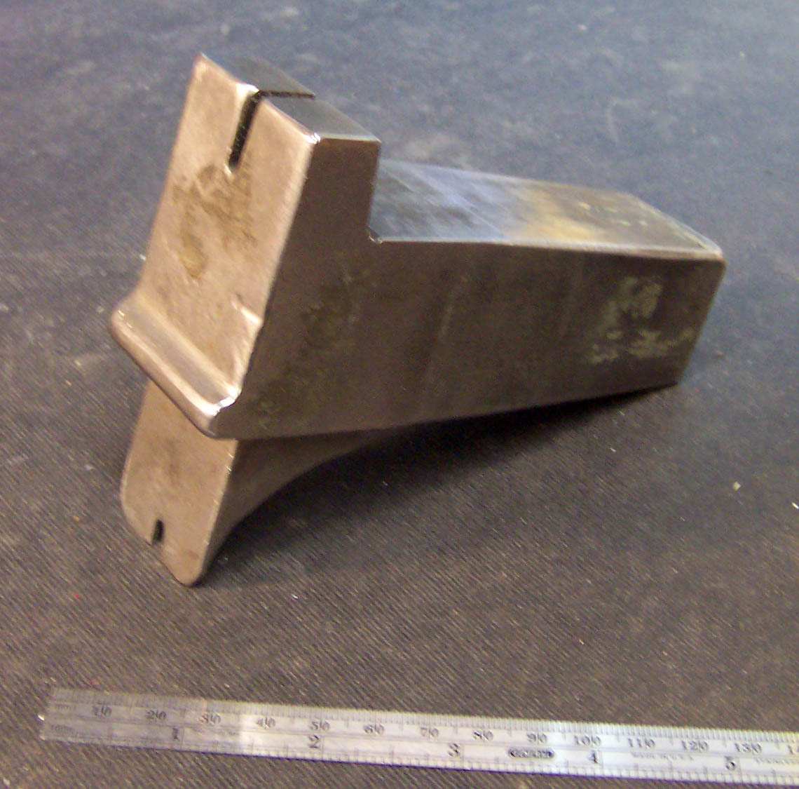

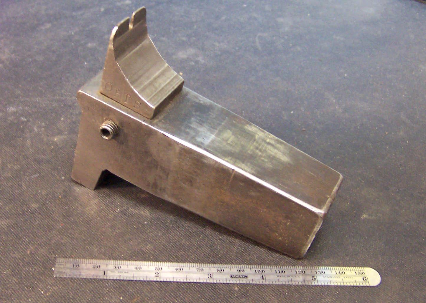

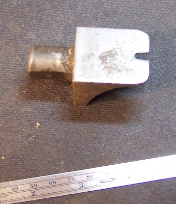

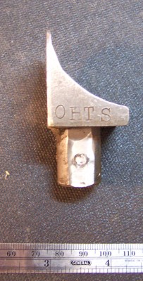

All this is to introduce an artifact from the Camillus Cutlery that has recently found it’s way onto my workbench.
I have taken several pictures and would like to thank Tom Williams (CAMCO) for introducing me to Wallace Rockwell, one of his fellow former Camillus co-workers.

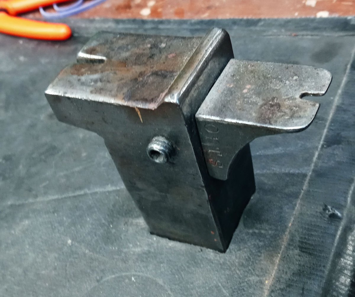

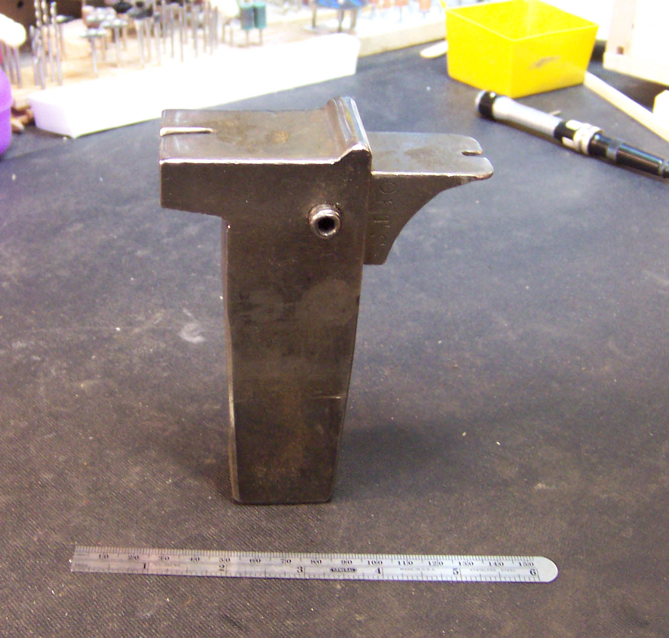

Tom had told me about a tool used at Camillus to compress the backsprings of knives while being assembled for repaired. He told me I should have one for my repair work.
Tom introduced me to Wallace over the telephone, and Wallace generously agreed to send me a Camillus knife vise. I will post this knife vise in a different thread. I say this by way of introduction because Wallace also sent me a cutler's stiddy that was made at Camillus.

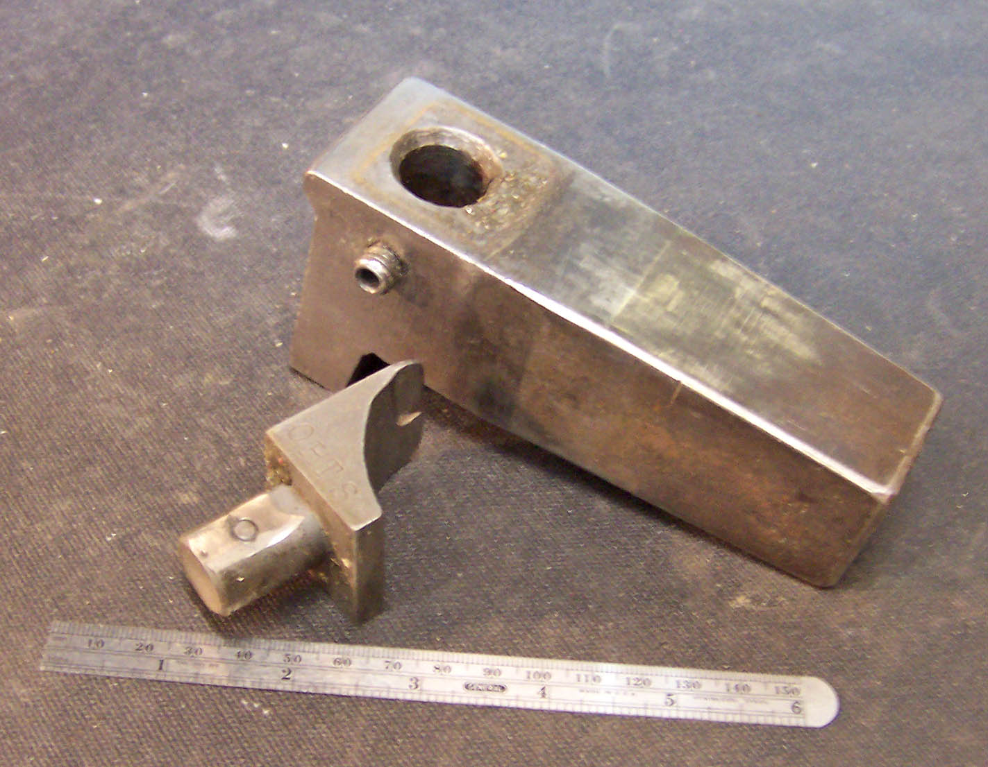

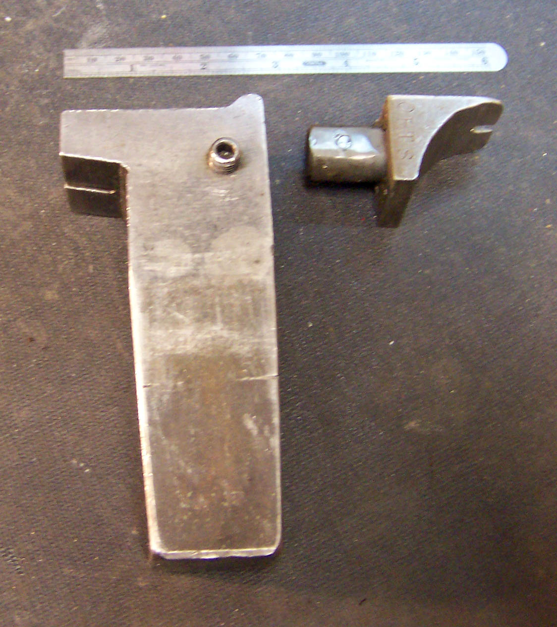

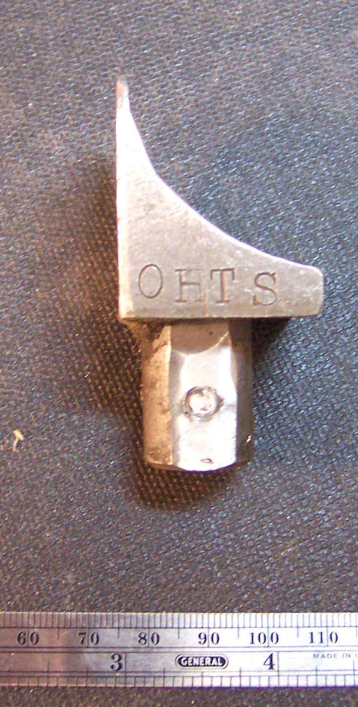

You'll notice in the pictures that this stiddy has no base, but has a tapered leg that fits into a hole cut in the top of a workbench. The horn of the stiddy (the part used to peen handle pins without disassembling the knife) is detachable by the means of an Alan screw. I thought this was quite ingenious, and makes it much easier to make a stiddy such as this one rather than the one-piece type that I had. I am hoping this winter to fashion a few stiddy's based loosely on this Camillus design.
Wallace told me that this stiddy and many others were made at Camillus Cutlery and were used there. As you can see in these pictures, this stiddy has been used and even has some dirt/grease from the cutlery still attached.
I thought some of you here might enjoy seeing the pictures of a Camillus stiddy.
I would like to thank Tom for introducing me to Wallace, and especially to thank Wallace for his generosity and sharing such a unique artifact.
I hope you enjoy the pictures,

That's very interesting Dale
. I believe Stiddy is an old Sheffield term for a cutler's anvil.

It may have been steady, but you know how funny our friends in the U.K. speak.smiling-knife wrote:That's very interesting Dale. I believe Stiddy is an old Sheffield term for a cutler's anvil.
s-k
I missed a great opportunity once, because I didn't know what the heck a girl from Manchester was saying.
I have an older book here, The Story of Cutlery written by J.B.Himsworth, a " Freeman of the Company of Cutlers in Hallamshire".
He uses the term ' stiddy ', and many other interesting words for the tools, materials, and processes of the trade.
Terminology aside, you have a great tool, and an enviable piece of American cutlery history.

Very Nice! That's a great tool to have as well as a nice piece of history. I like that set screw set up, it allows you to make custom tools to mount on the stiddy. CONGRATULATIONS!

Dale, I'd like to see a pic or two of a knife in/on the stiddy just to get an idea of it's operation. Thanks, J.O'.

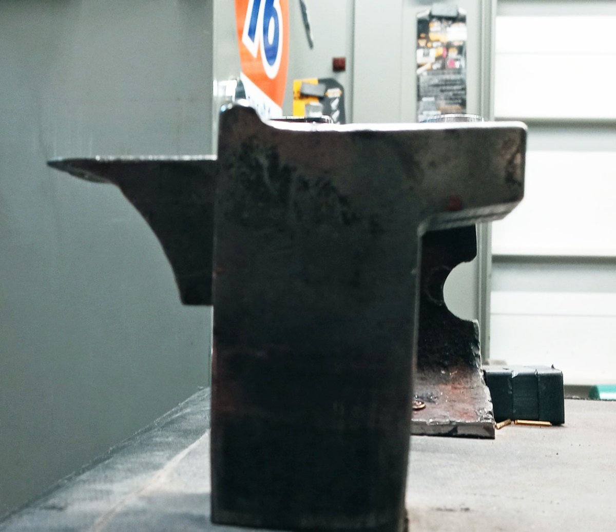

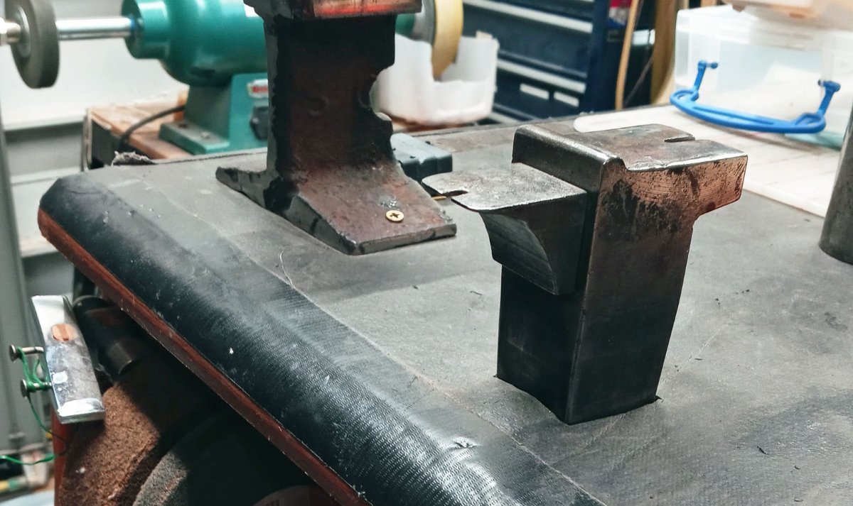

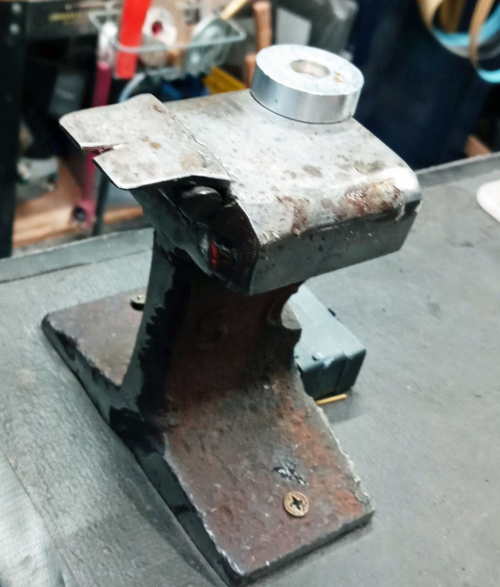

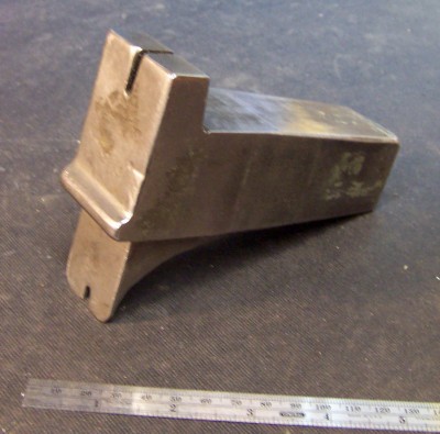

Sorry it has taken me so long to get these pictures posted.
The Camillus stiddy of course sets in the workbench in a tapered socket. It can be easily removed by tapping at lightly on the bottom and it pops right out if you want to move it somewhere else to use it. I'm sure the workbenches that Camillus had tapered square holes in them, so it was probably not an issue for them.
I have two stiddies on this bench, The one to the left is rather crude but it was the first of a number of stiddies I made it home from railroad track. The last picture shows that stiddy best.
This homemade steady is rather crude and as you can tell by looking at it the welding is pretty sloppy. It turns out the railroad track has a certain ally in it that makes it very difficult to weld unless you have railroad welding rod, specially formulated for welding railroad track. This first steady was a gift to Johnnie Fain, (jonet143), my mentor in being a moderator. When he passed in 09 his wife sent me several of the tools he used as well as a lot of parts knives. I have had many stiddies over the years and I believe I made over a dozen of them myself, but this does this old thing does everything I really need it to.
Since someone always asks, the heavy aluminum washer is what I used to peen the handle pins when attaching spun pins to handles. The soft aluminum provides support to the head of the pin without deforming the brass head like a steel support would.
In truth that thick piece of aluminum does get in the way sometimes that's when I use the Camillus stiddy.
The Camillus stiddy is far prettier and much more historic than the first one I made, I keep it for sentimental and functional reasons.

Not sure if its really a weld rod issue. If you preheat the railroad track, you may have better results.
Just an idea.
thanks for sharing your stiddies. I need to make one myself someday.
