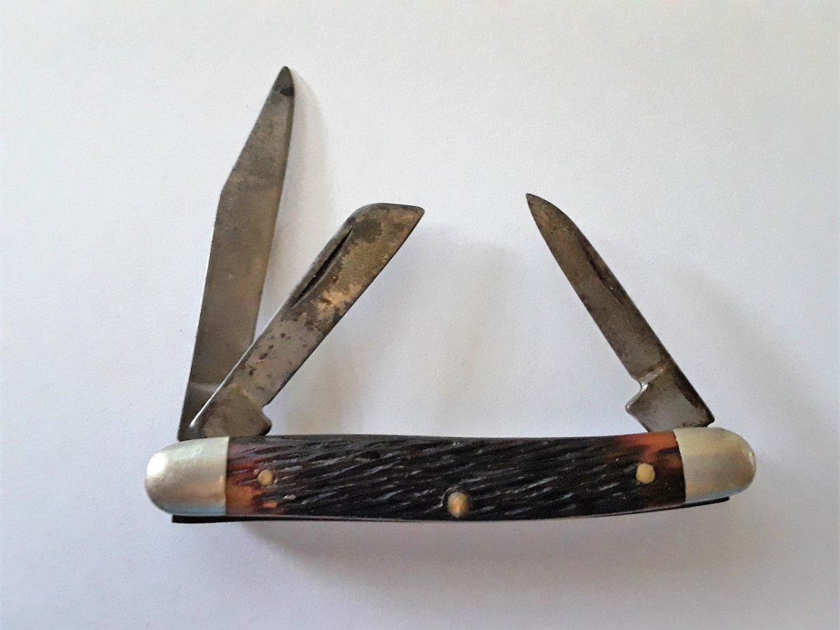

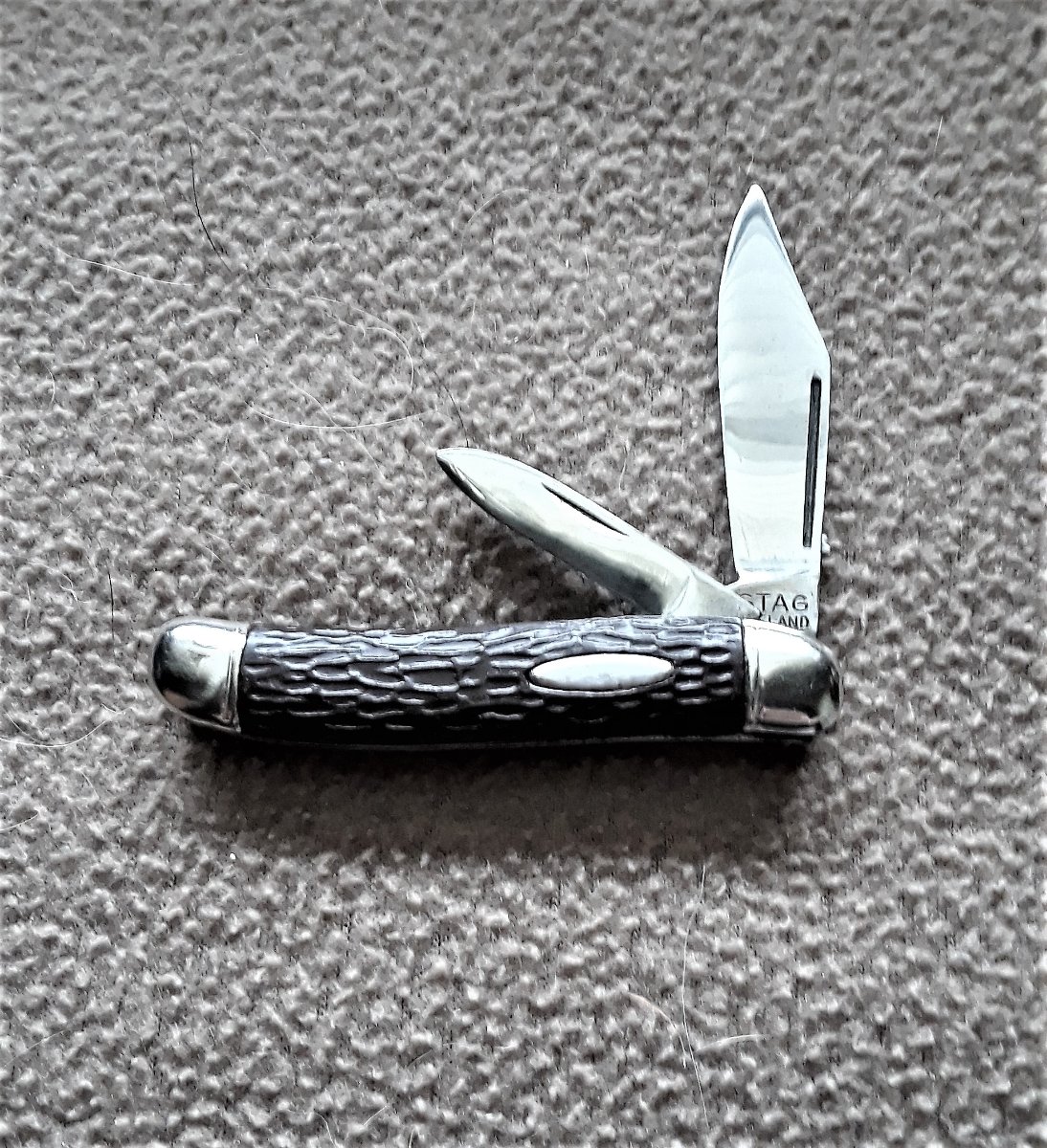

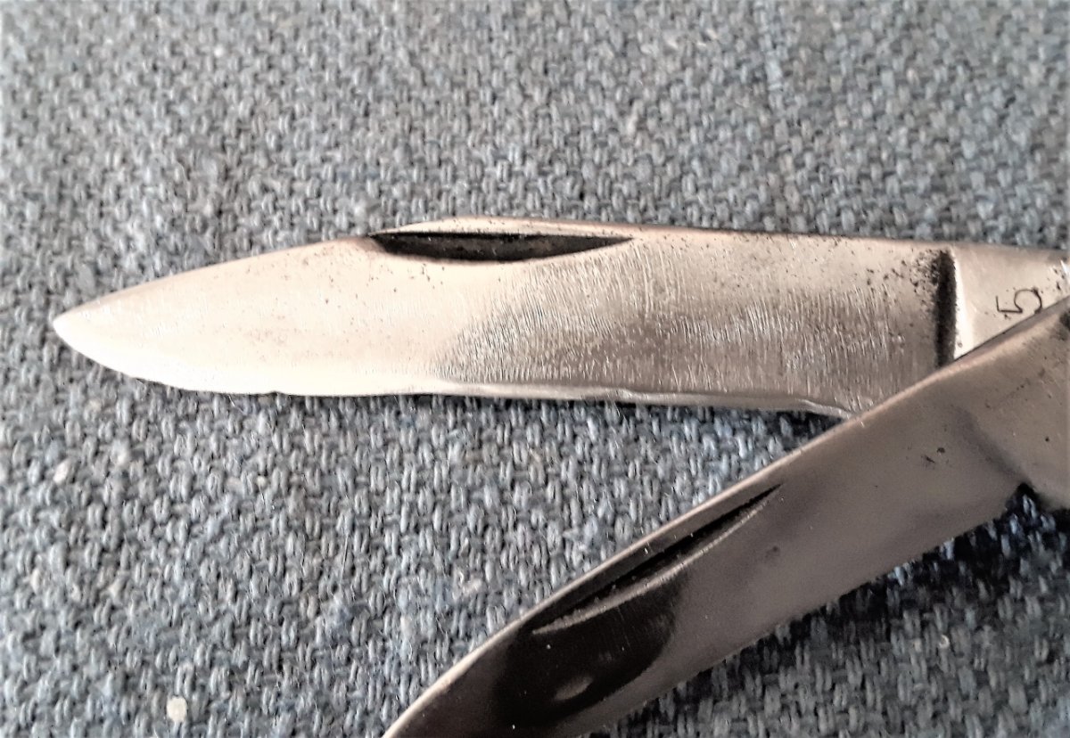

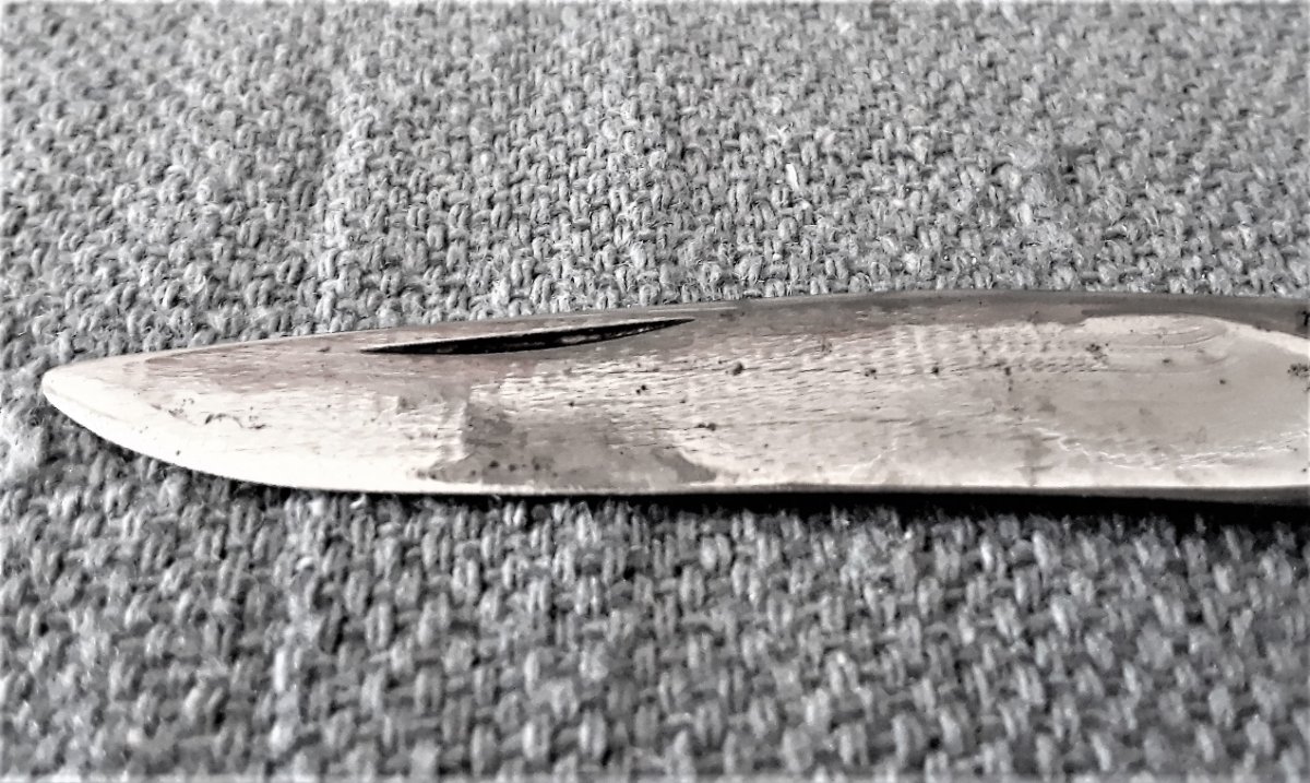

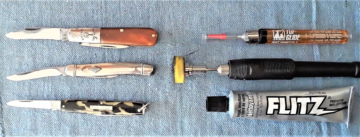

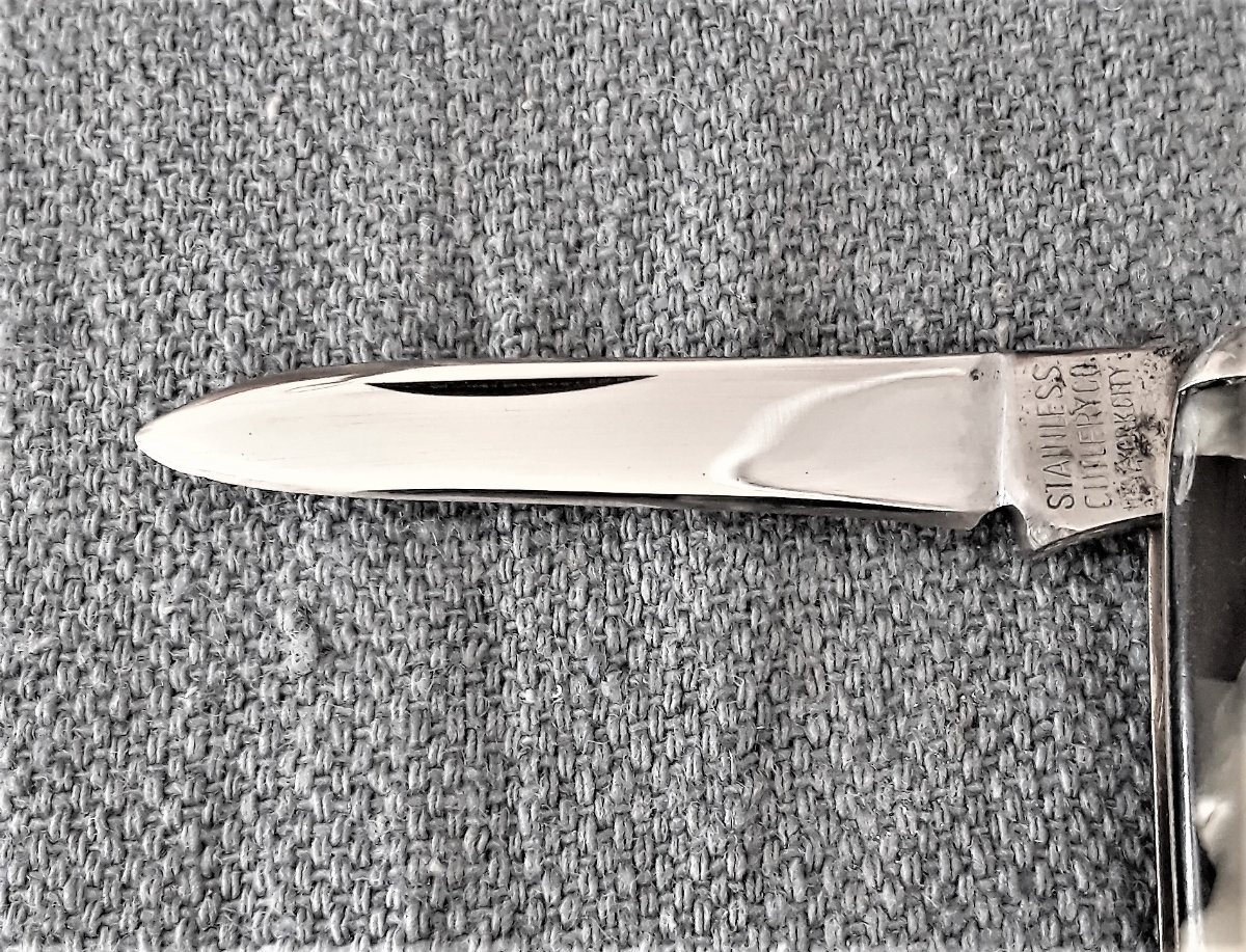

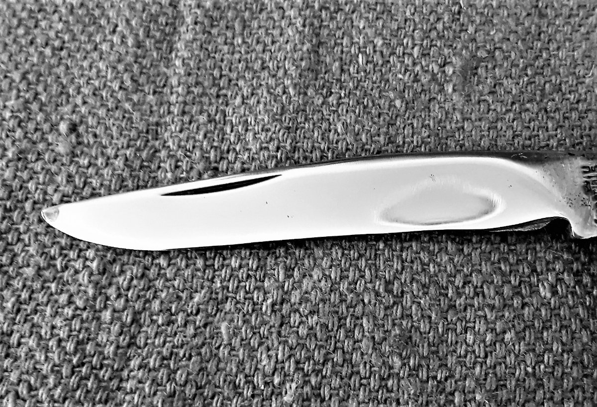

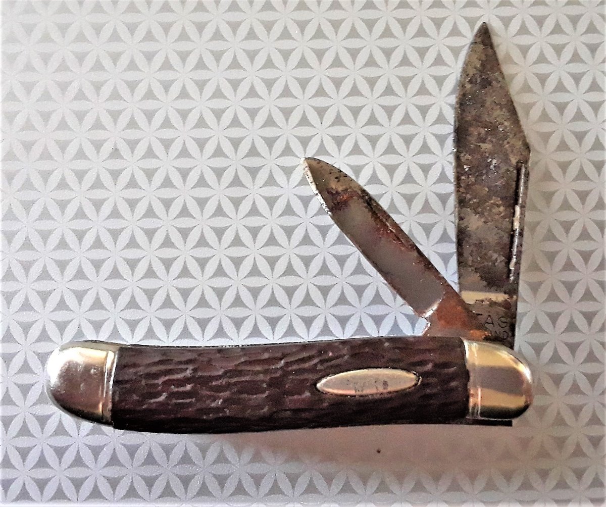

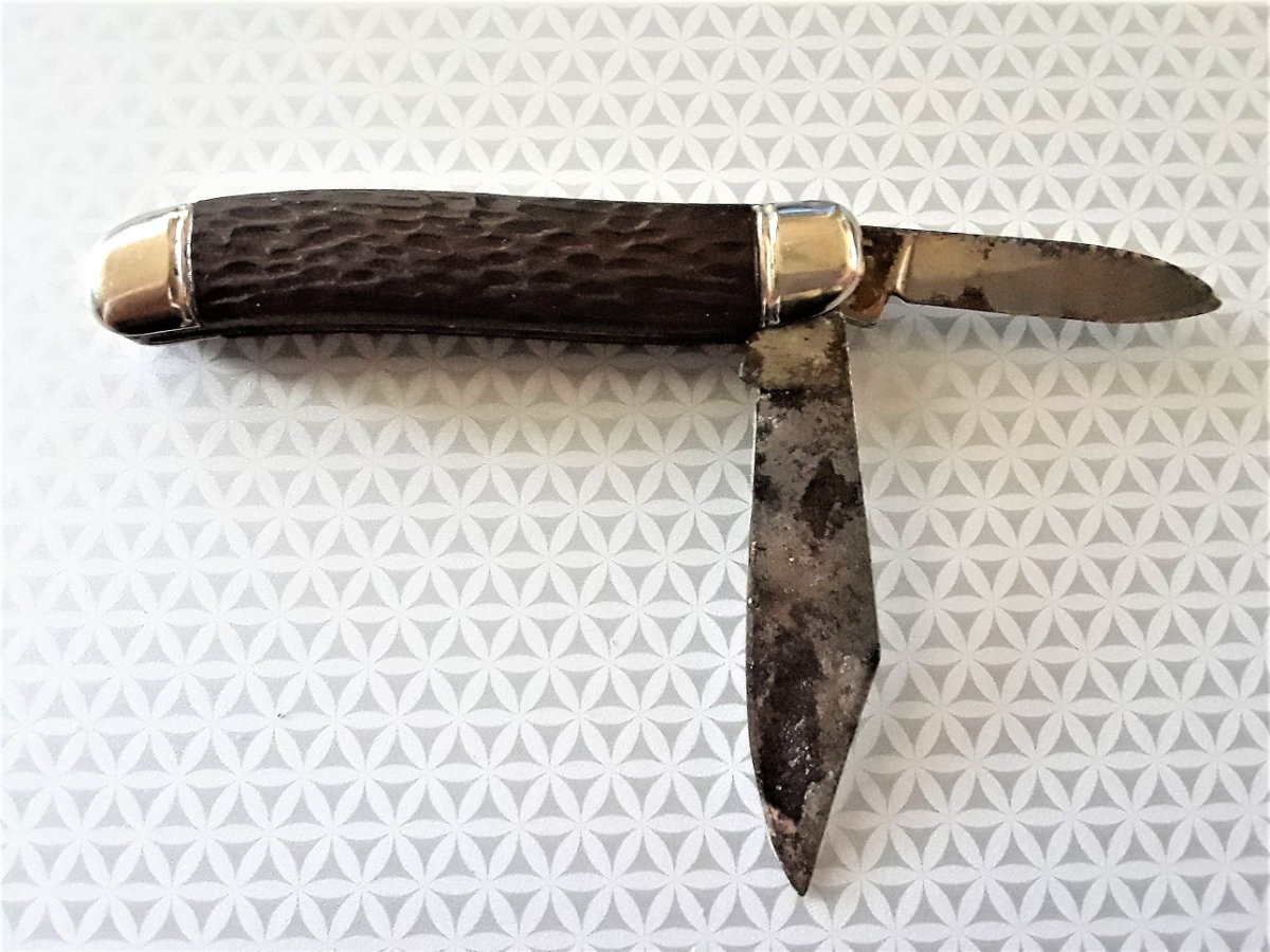

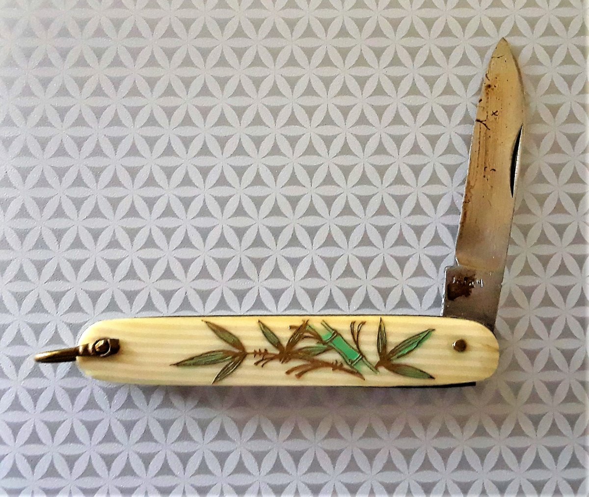

Just want to show how I'm cleaning blades. These were some old knives I had in the bottom draw that were in poor shape and I wanted to show how I go about cleaning the blades. 1) I use a "Super Eraser" on the blades and bolsters. 2) I then put a light film of "Sentry Tuf-Glide" oil on the surface of the blade. 3) Depending on the condition of the blade I will start with 240 to 400 grit paper on my dremel tool. Heavy pressure at first and in one direction from tang to tip moving very slowly. Then only lightly touching the blade moving slowly tang to tip. 4) Now add more oil and go up to the next grit and repeat step 3) again. After 400 grit I will use a combination of 600, 800, 1000, 1200, 1500, 2000, 3000, 5000, 7000, and 10,000 girt paper depending on how the blade is looking. When I've achieved the finish I want with the paper I will finish by polishing the blade with FLITZ polish and buff clean.
Sometimes there are cases that I only use the Super Eraser and the FLITZ polish on the blade, because of the overall condition of the knife. Anyway here are 3 knives I just finished the main blades.
Before
After
Before
After
Before
After
David Roberts
Prayer Changes Everything
jmh58
Posts: 14252
Location: Pgh,Pa
Re: Knife Cleaning
Post by jmh58 »
Well done David!!! ::tu:: 8) ::tu::
John :D
Not all who wander are lost!!
bladecollectorr
Posts: 620
Joined: Tue Jan 22, 2019 1:11 am
Location: Canada
Re: Knife Cleaning
Post by bladecollectorr »
dlr110 wrote: Sun Jun 28, 2020 9:18 pm Just want to show how I'm cleaning blades...
Nice work! I use a similar process. Using a Dremel on them always scares me a bit. You have to be so careful that you keep the wheel spinning in the right direction or it could catch and throw the knife at you. Same deal on a standard buffing wheel. There is some risk involved.
Due to this I usually hand-sand the blades up to 10,000 grit. Often they are submerged in water (if that won't wreck the particular handle material) during the sanding so the paper doesn't clog and the black sanding residue doesn't stain anything. I use my Dremel with some Flitz for the final polish. Similar results. I expect using the Dremel throughout would be much faster.
I don't always respond to great posts but I always appreciate seeing them. Thanks for posting! ::tu::

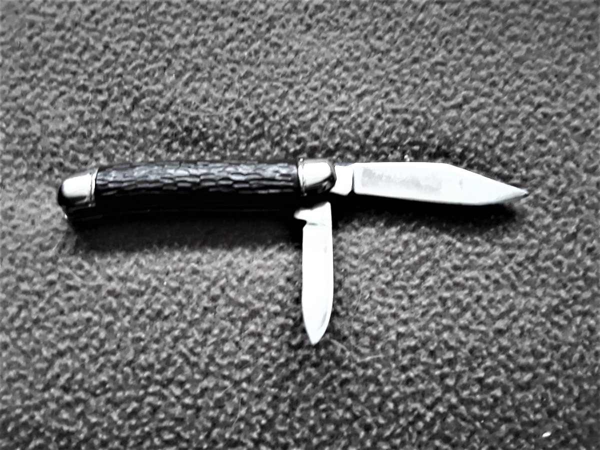

I love a challenge, what'da think?
This was a mistake I received from an ebay seller.
After I finish, I'll post more pic's.

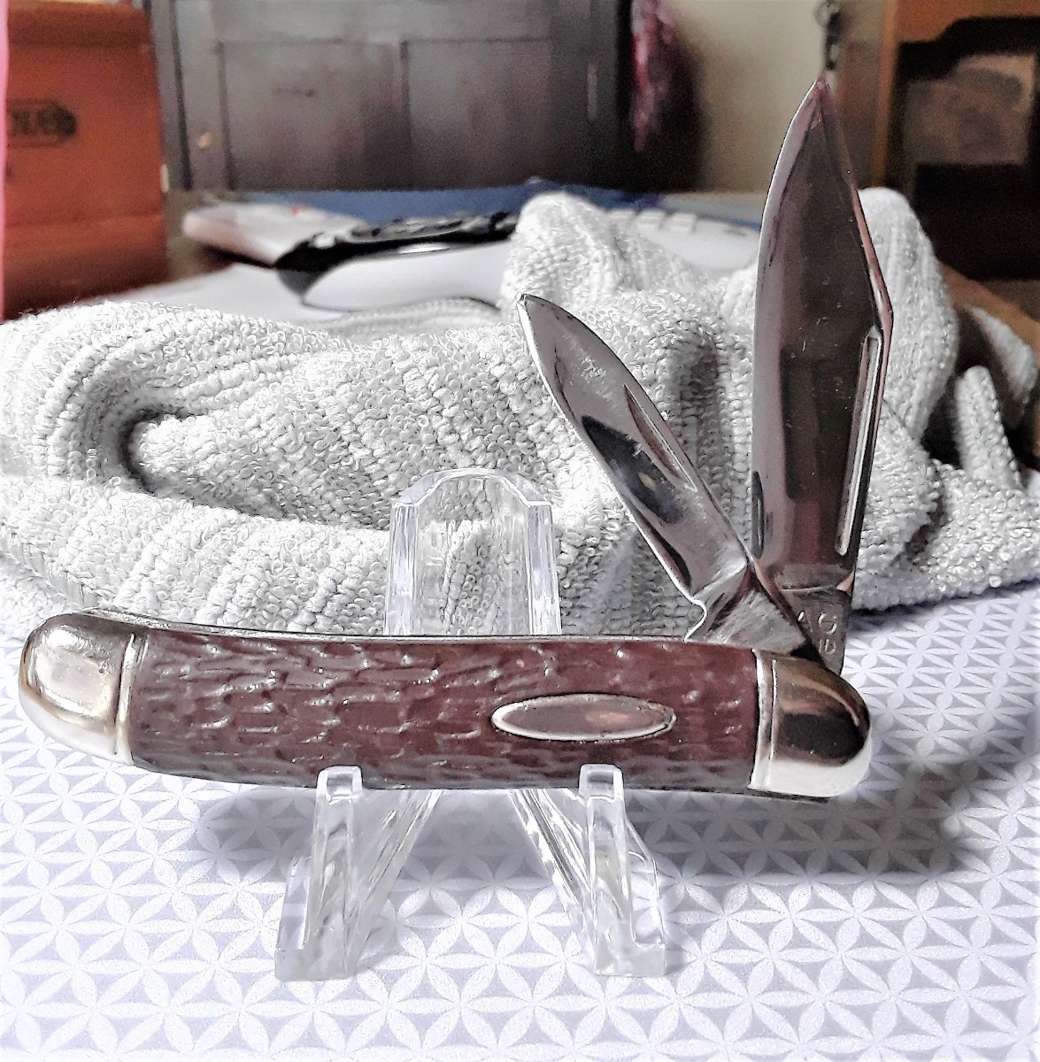

Okay, believe it or not this is the same knife 6 hours later. I wish I could take better pictures, because this knife looks much better in person than it does in my poor photos. There are no stains on the blades, that is shadows. Those blades have a mirror finish on them with only a couple of pits and scratches left in them.
Now this is a good knife ready for more years of use.

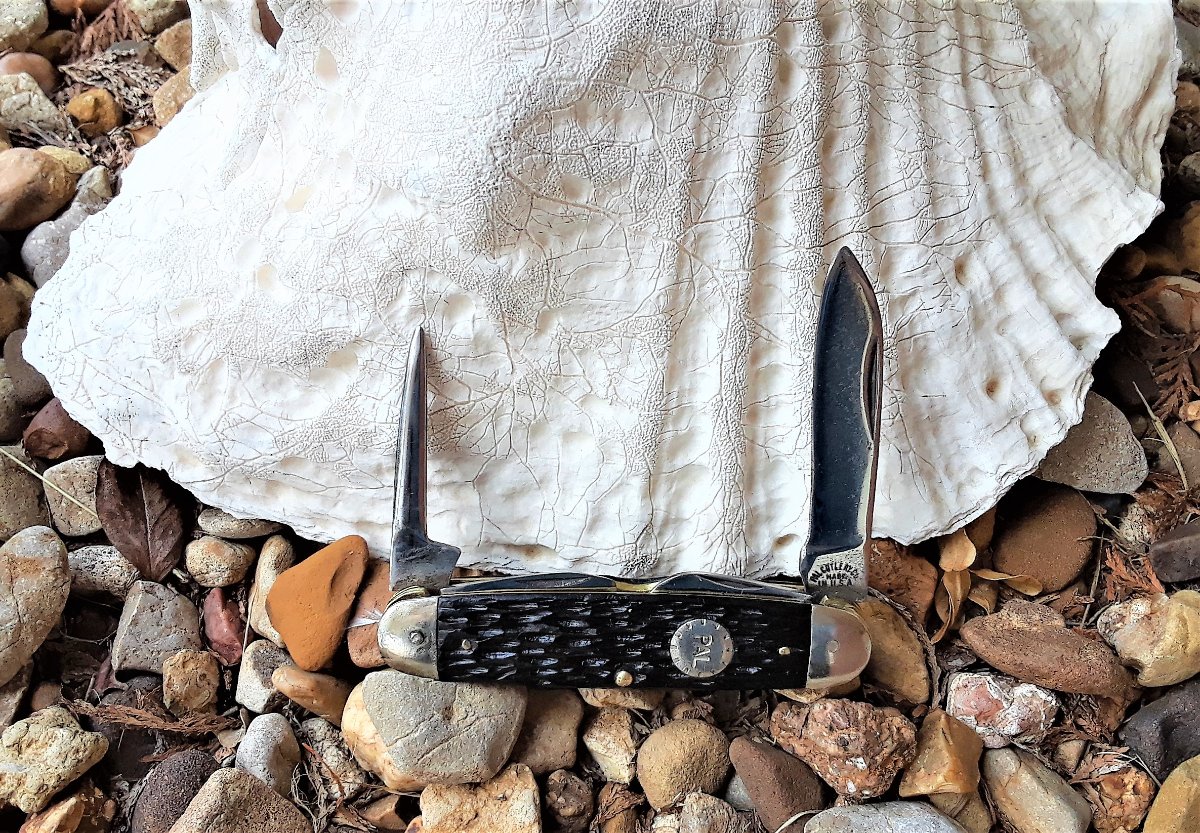

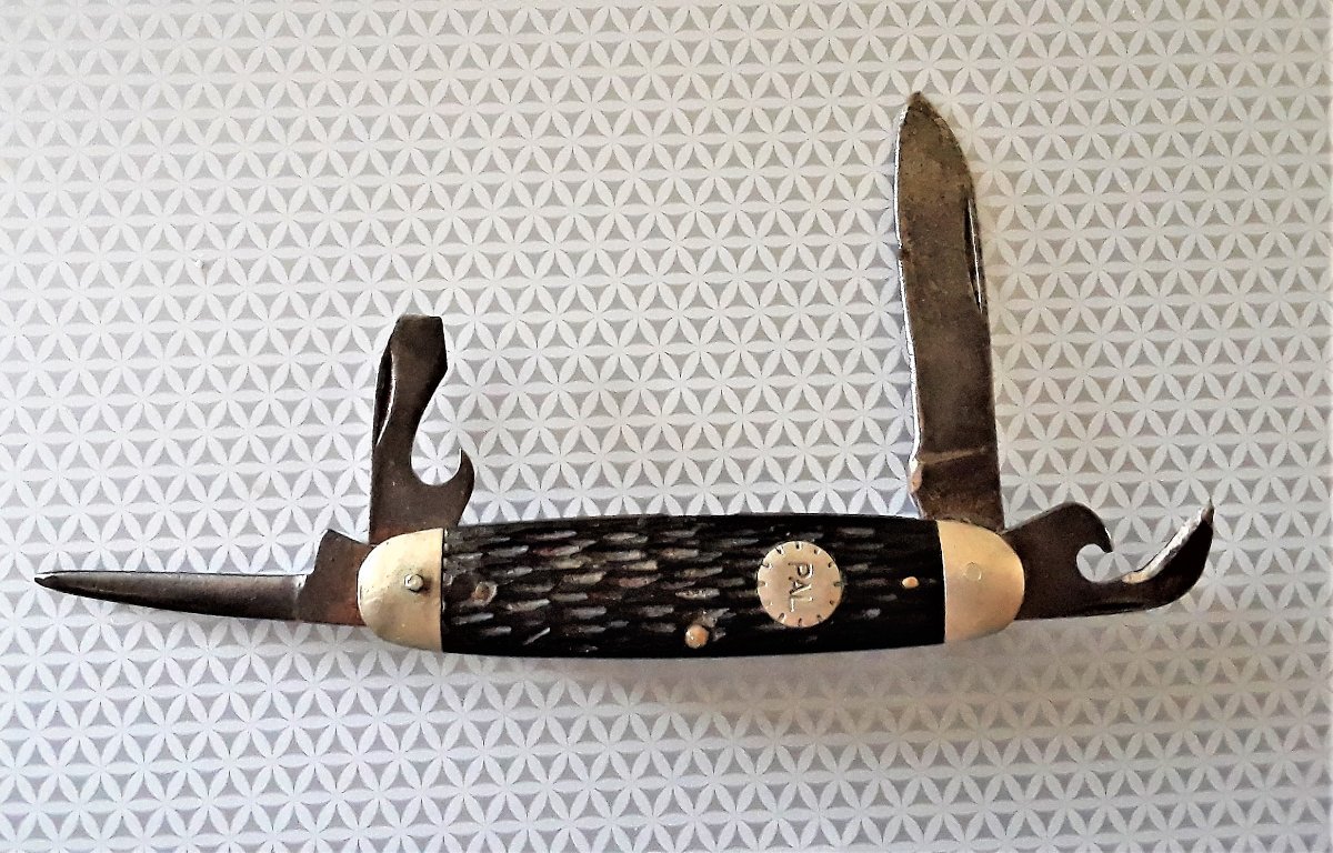

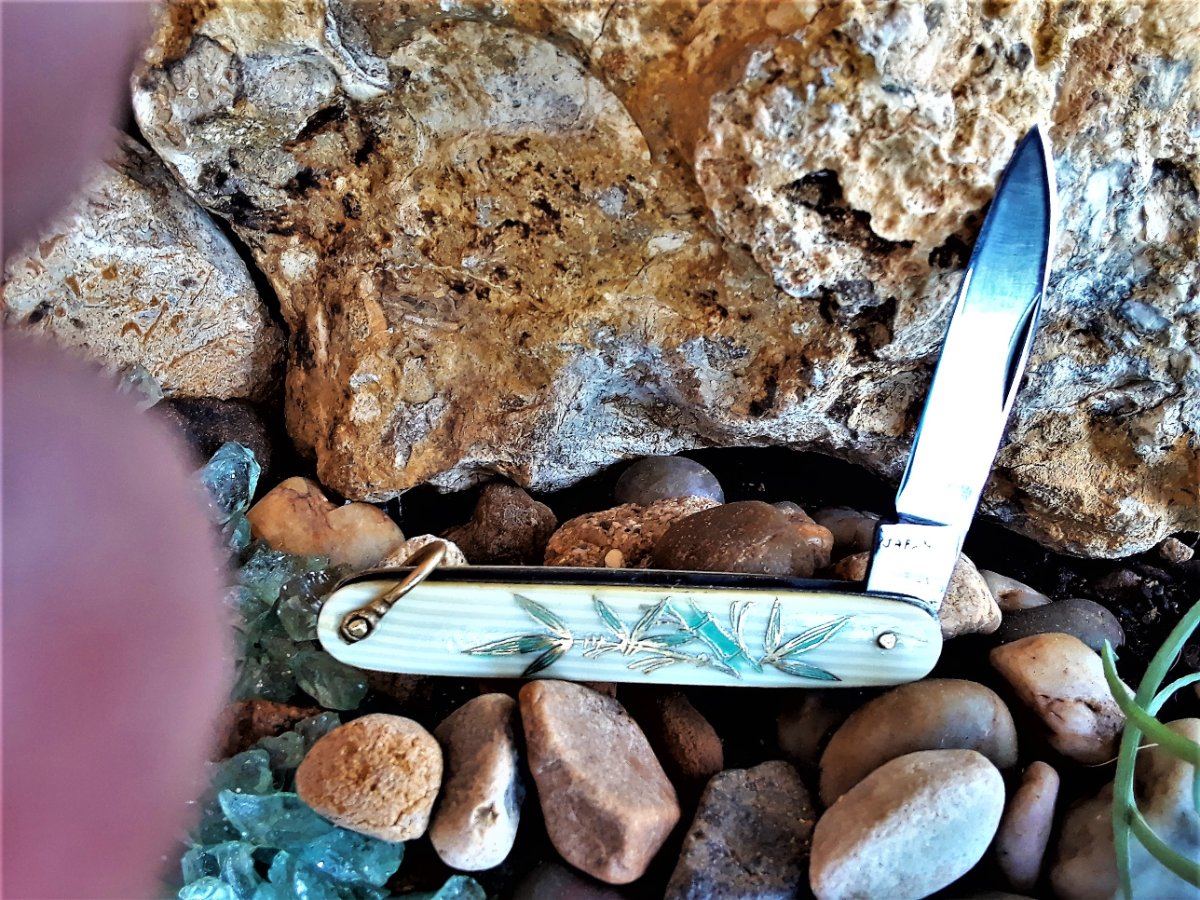

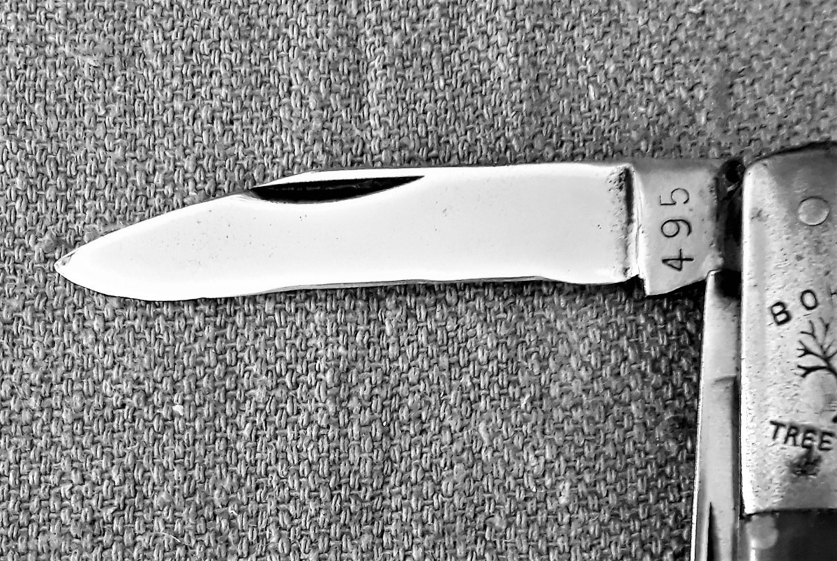

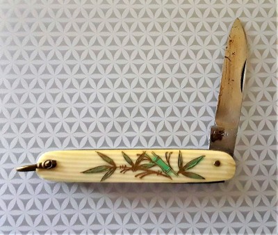

The little souvenir knife was easy to clean, but the PAL was a challenge. It still has a log of
pitting and scratches on the main blade and the bolsters were in bad shape. So that is about
the extent of my knife cleaning abilities.
Before....
After....
Before.....
After....

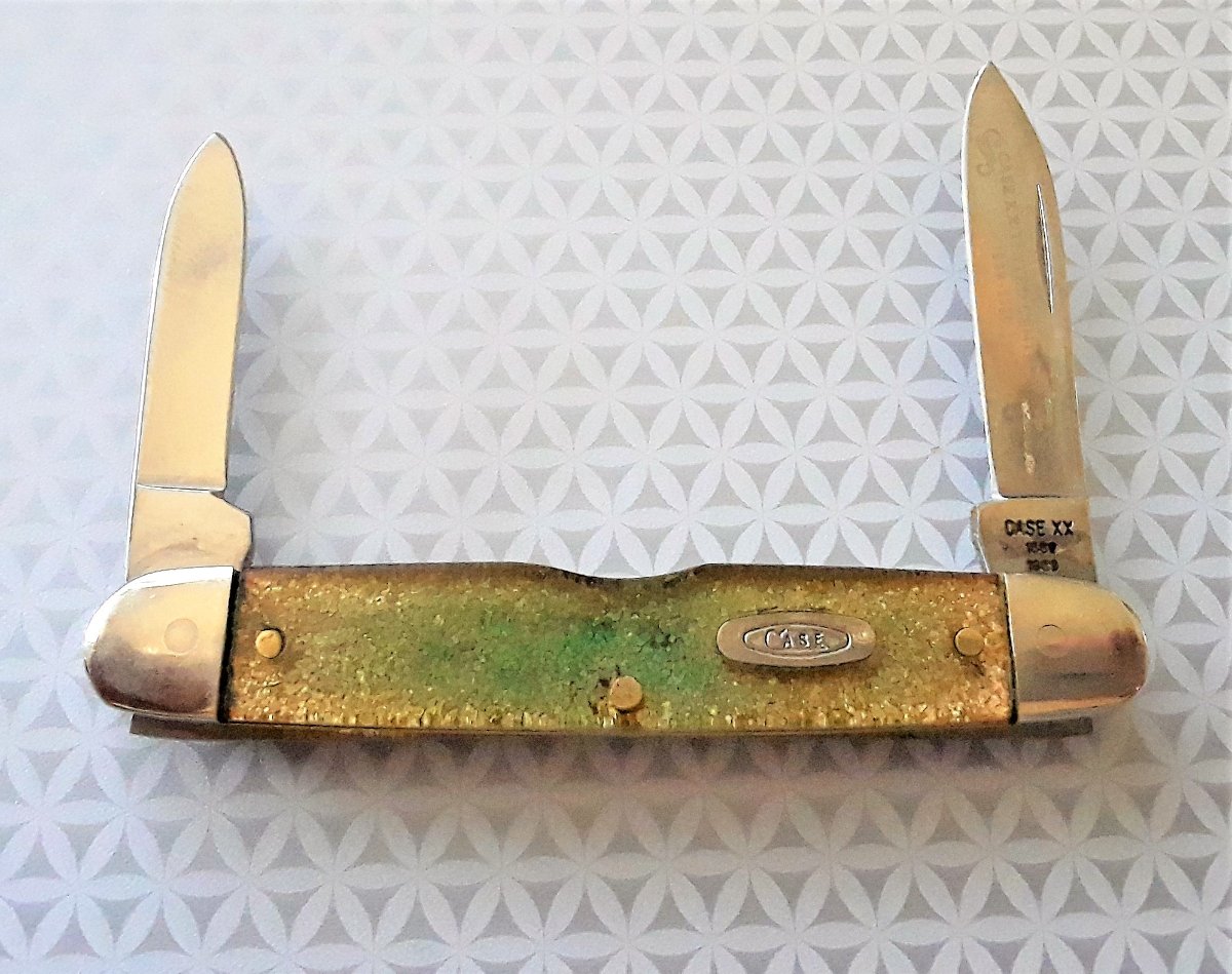

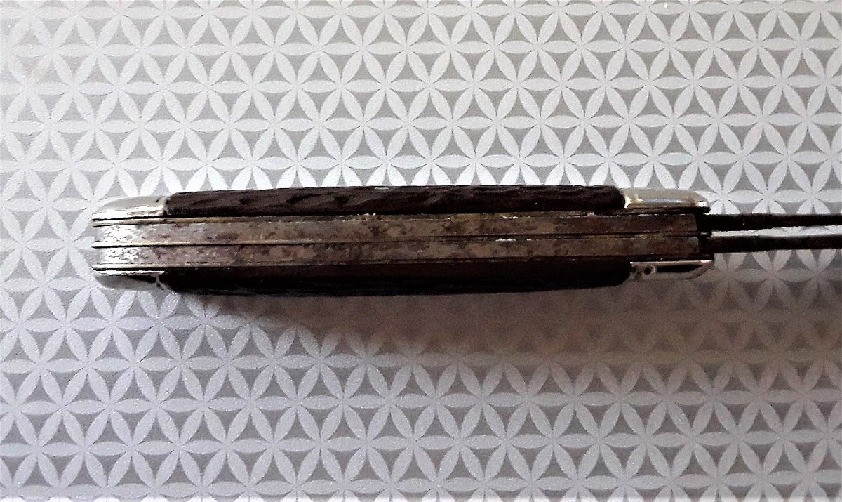

Here is a little CASE that I was able to clean up with some polishing cream.
I'm going to go out on a limb and say that short of new scales there is no
way to correct the green tarnishing.

dlr110 wrote: Mon Jul 06, 2020 3:08 pm Here is a little CASE that I was able to clean up with some polishing cream.
You are correct. From my experience it will only get worse.

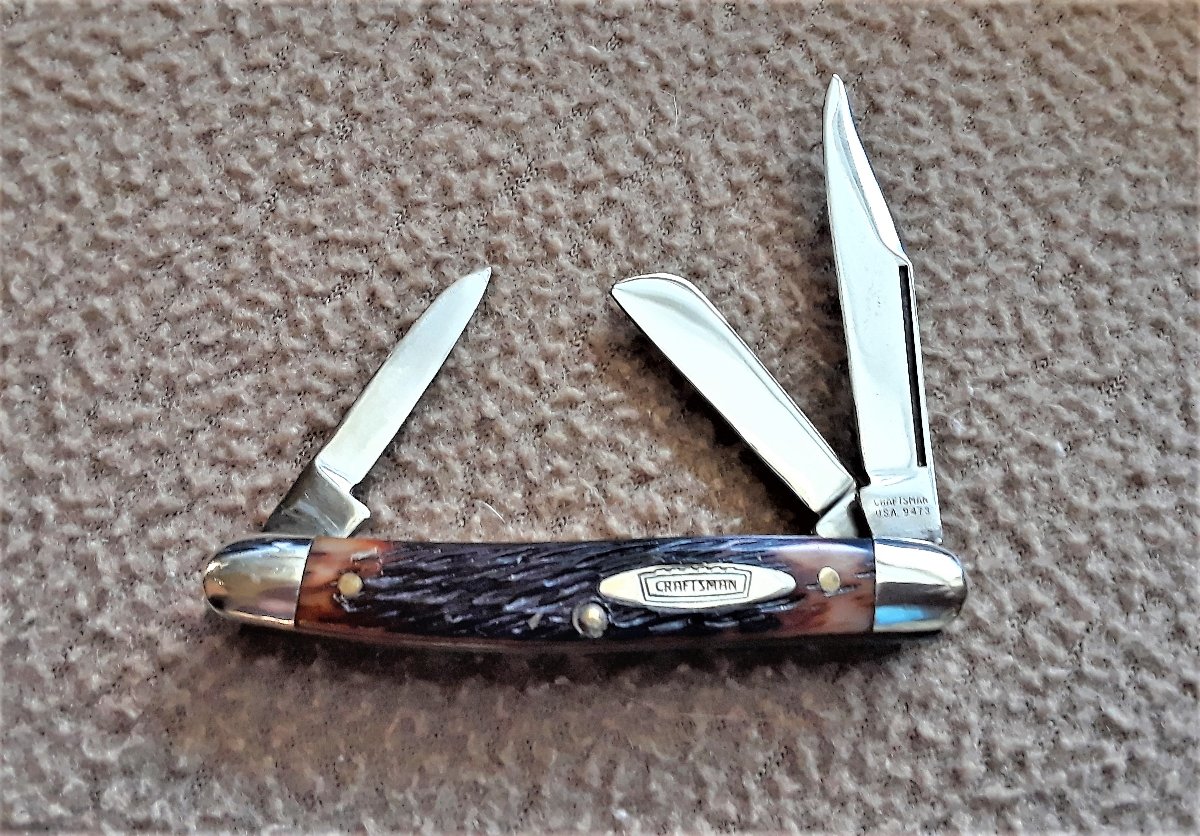

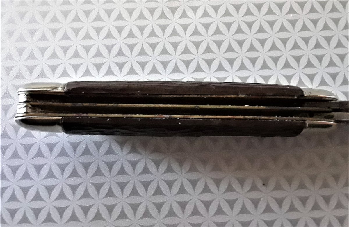

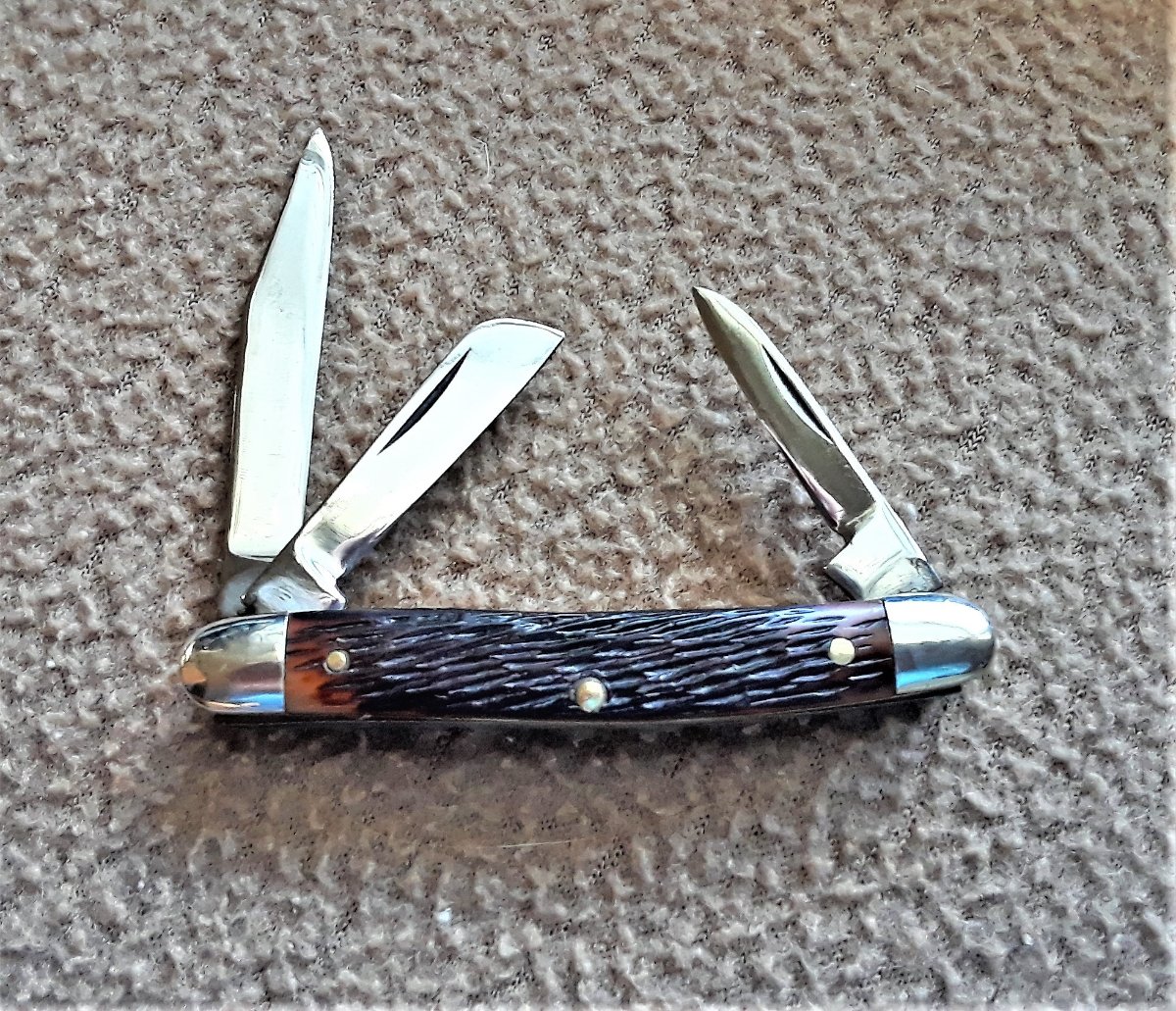

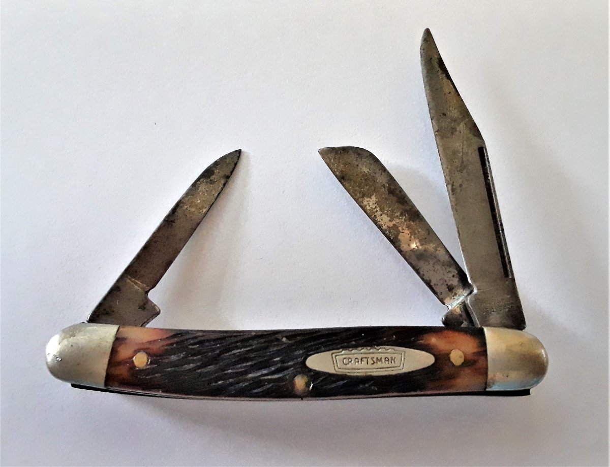

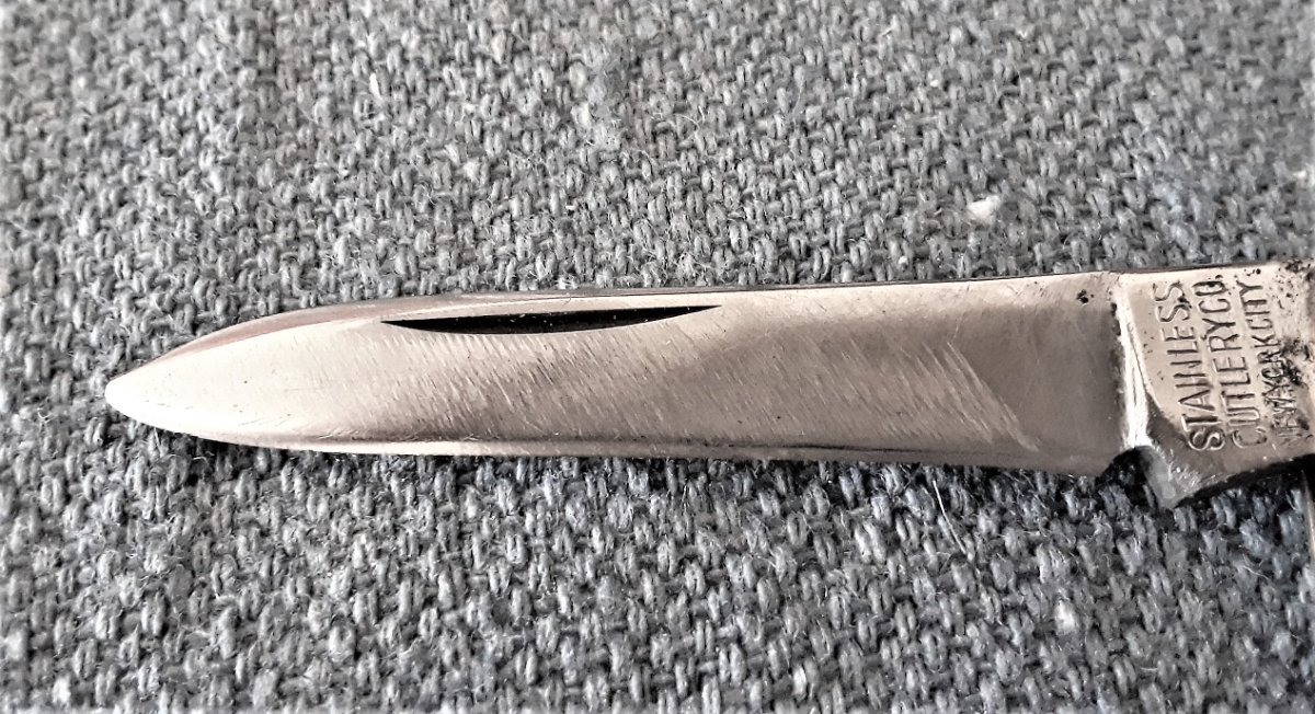

Craftsman U.S.A. 9473 Mini-Stockman 2 2/4" Long Closed.
After I cleaned this little knife up it was almost as if it came alive.
Everything is in great shape. It's tight, no wobble and the snap is
crisp in every blade. I think this was one of my best finds in a while
Now if I can find out who the exact maker was and around what year.
BEFORE
BEFORE
BEFORE
BEFORE
AFTER
AFTER
AFTER
AFTER
