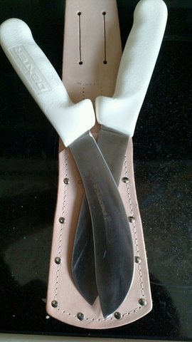

All mine go into the dishwasher. If they get ruined, I'll replace the handles. 17 years now and they are all fine. I don't use stag knives in the kitchen.
If I buy new kitchen knives they will be Dexter sani knives. They are dishwasher safe.
