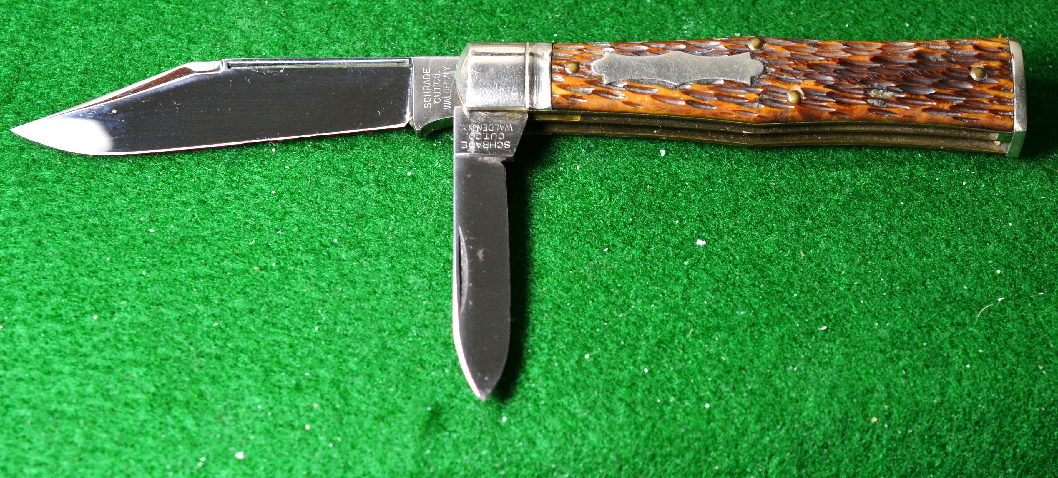

Some of this knife may be real?
The small blade has definitely got a bad stamp.
Guy calls it "mint".
http://www.ebay.com/itm/Old-Vtg-RARE-19 ... 43b9c87fba

That isn't anywhere near mint and it's not a doctor's knife/pill crusher either. Having a butt cap has no medical significance what so ever.
Nice looking knife but it just doesn't sign true.

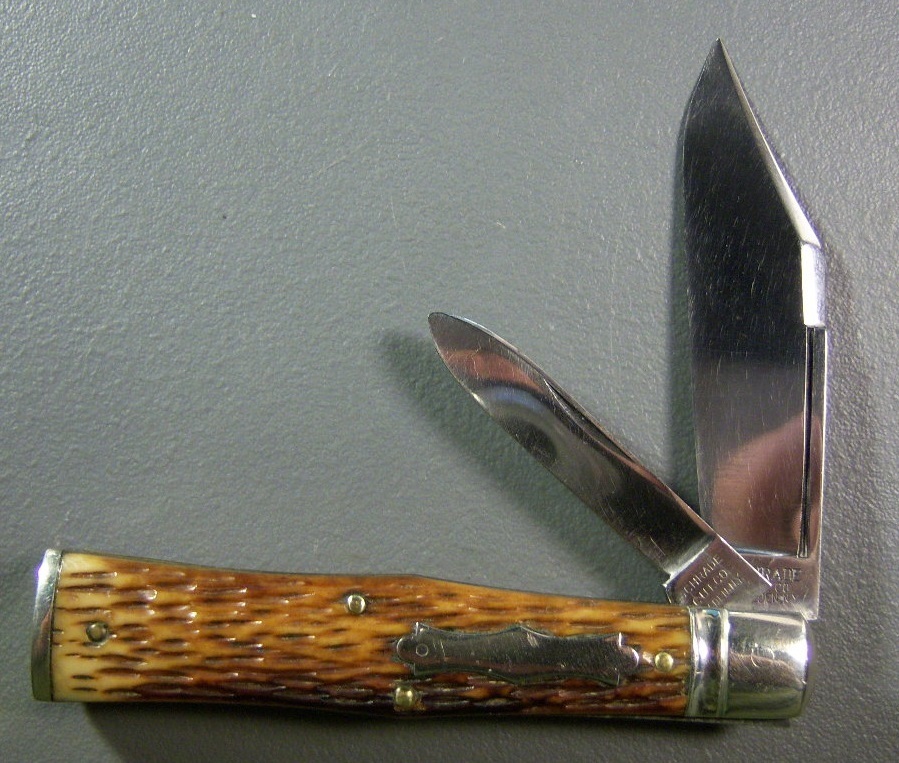

My repro Schrade catalog has a knife like this on page 90. Listed as No. 2643 3/4
Balloon pattern jack knife, seal cap, 4" long.
But the bolster looks round. This one looks flattened.

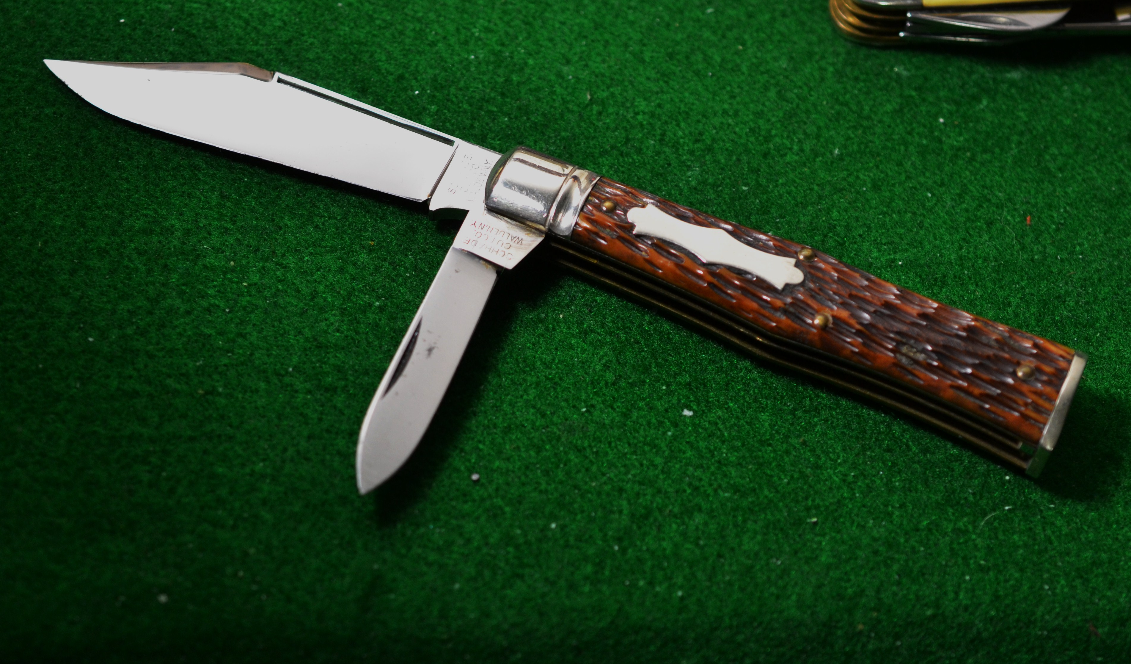

How could the bolster be flat on one side, and round on the other?
PigSticker
- Posts: 1296
- Joined: Thu Jun 24, 2010 3:37 pm
- Location: Burton,Michigan
Re: Schrade Cut Co. Doctor's Knife
Does look round in the pic you've posted but looks flat in his first pic--Pic of it with blades closed the main blade tip is ridin kinda high if you ask me for being in unused condition

Some of these big Cut Cos are extremely rare. I've never seen any of the 4-5/16" stock knives, either. They're all 4".
But this one has been messed with. For sure the smaller blade's been replaced. And the big blade with the serif stamp doesn't look right either. It should have a sans-serif stamp with the letters the same size as the others. And $1750? Pretty outrageous.

If you blow up the stamp on the smaller blade, you can see that it's been carved with a machine. It's very shiny and full of evenly spaced dots from an etcher. I also think the larger blade is from a repro knife.
And it's certainly not mint.

THE knife is a Swell-Center Jack page 174 Blades Guide to Knives Value $350
Now we can see the difference in the shape of the master clip blade.
It's always a bad sign when the handles are worn more than the blades.
