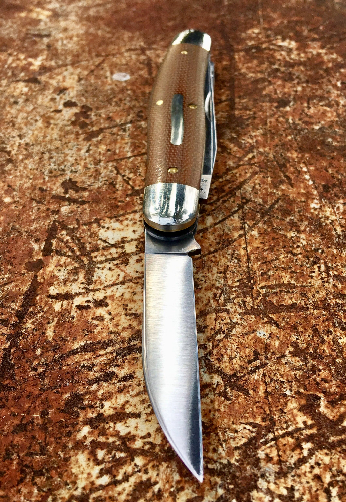

I like to sharpen to as low an angle as I can without having a very wide bevel. I'm very picky about the way my edges look, not really the finish but more so having it straight, even and narrow. I usually do around 18-20 degrees per side but I do 15 or less when I can.
This is a good example of how I like my edges. All the blades on this knife profiled beautifully when I took it to 18 dps. A very nice straight and narrow bevel on all three blades. The blades are ground well and I'm pleased with the way they cut. The bevel is narrow enough that I may take them down to 15 in the future for even better performance but we'll see.

Paul, that is a very handsome knife. I think it’s a GEC, but wanted to make sure? I love the color, the blade, shape and shield of that one.KnifeSlinger#81 wrote:I like to sharpen to as low an angle as I can without having a very wide bevel. I'm very picky about the way my edges look, not really the finish but more so having it straight, even and narrow. I usually do around 18-20 degrees per side but I do 15 or less when I can.
Very nice.

Thank you. Yes it's a gec, a micarta 82 stockman. It has been my edc since I bought it.Sharpnshinyknives wrote:Paul, that is a very handsome knife. I think it’s a GEC, but wanted to make sure? I love the color, the blade, shape and shield of that one.KnifeSlinger#81 wrote:I like to sharpen to as low an angle as I can without having a very wide bevel. I'm very picky about the way my edges look, not really the finish but more so having it straight, even and narrow. I usually do around 18-20 degrees per side but I do 15 or less when I can.
Very nice.

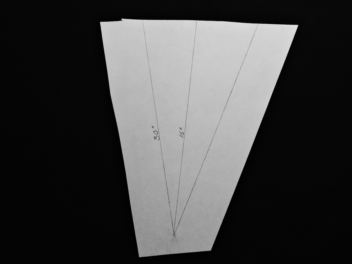

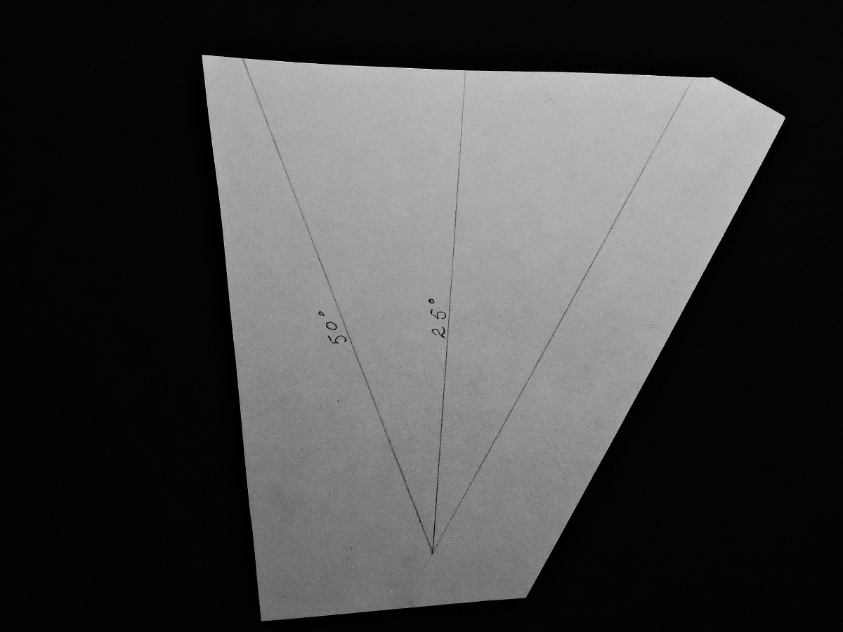

Anybody else lay them flat on the stone and rub them back and forth, for a full flat grind? Then a very slight secondary bevel at the edge. Not right for every knife but it’s great for some of them.
- FRJ
- Posts: 17132
- Location: Ct.
- Colonel26
- Bronze Tier
- Posts: 10404
- Location: Kentucky
Re: 15? 20? 25?
Joe thanks for that visual. I sharpen mine closer to the 30° inclusive one.
