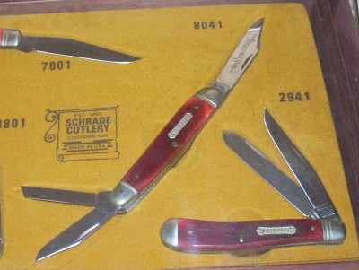

Did Schrade have the 8041 whittler made by some other company.The blades have pin in either end.I have two of these knives with pins .So decide to check to see if they where made this way because they are seconds.I found this picture on Ebay and it shows pins.I was wondering if anyone had any ideas on this knife

I have two of the Redbone Sets and both of the 8041's have pins through the bolsters. I don't know why, however, these two sets came direct from the factory right after they were made!
I hope that helps some.....Maybe Dale (ORVET) will come along and give us his expert opinion!

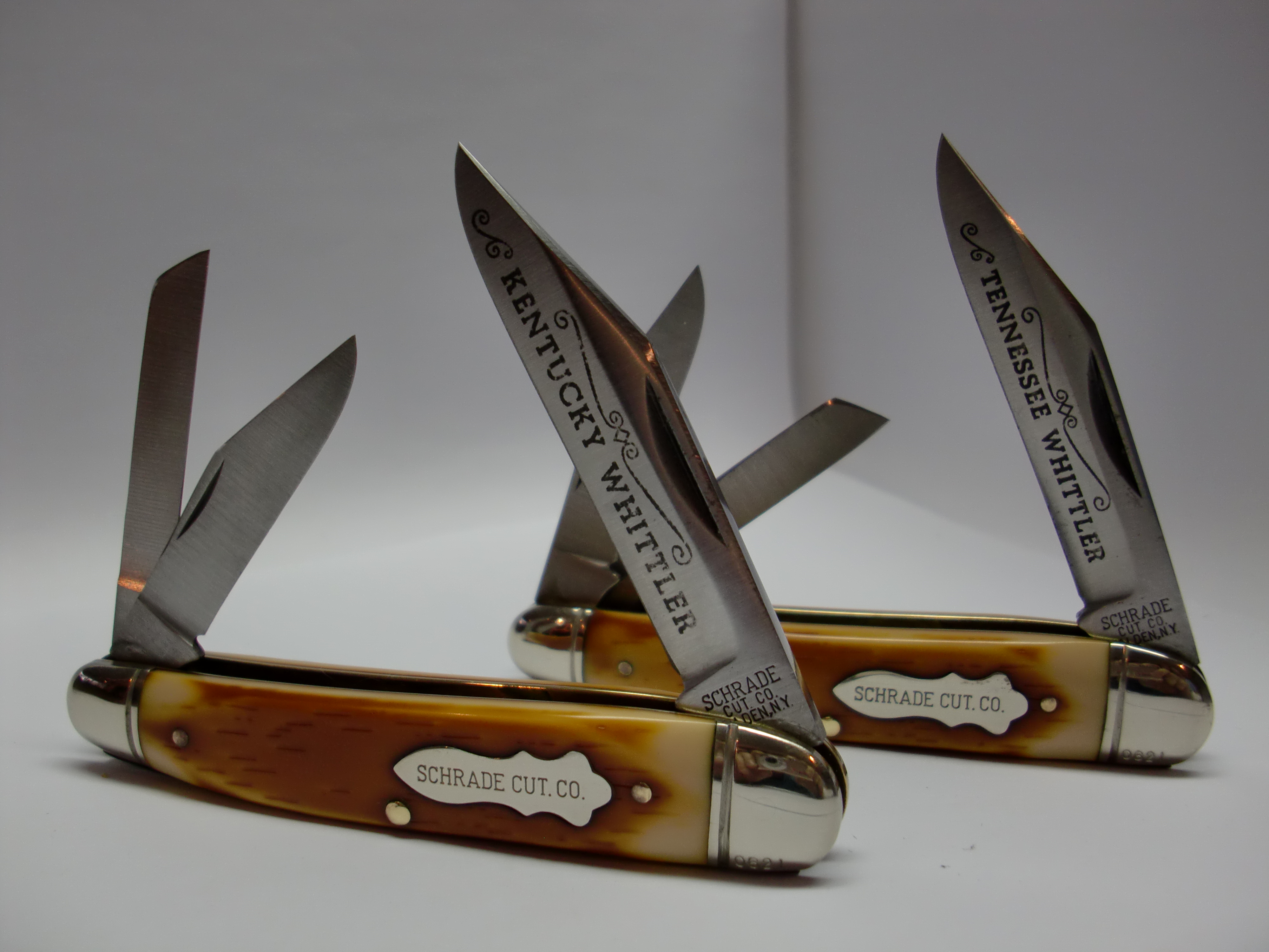

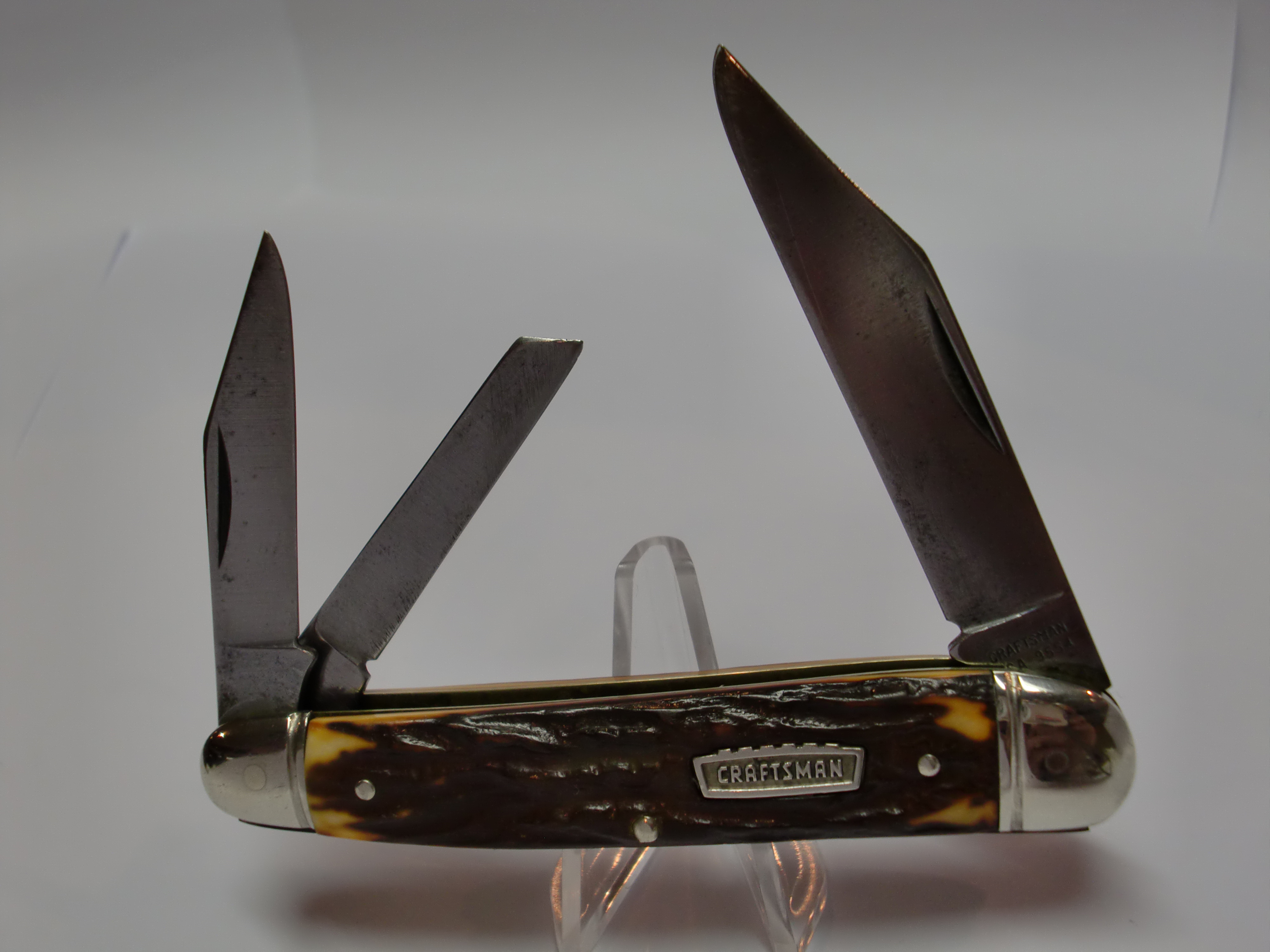

good question Shearer , I have never noticed the pins before , after checking some other whittlers i found the 9554 Craftsman is showing the pins also , but not Tennessee/Kentuckey whittlers nor the SW804......

The pins can show up if they are made with different steel types, when polished you may find the difference comes out that way. I have other Schrade knives as well as other manufacturers that show the pins this way. You can actually see the pins in the Tennessee/Kentucky whittlers if you enlarge the picture.
