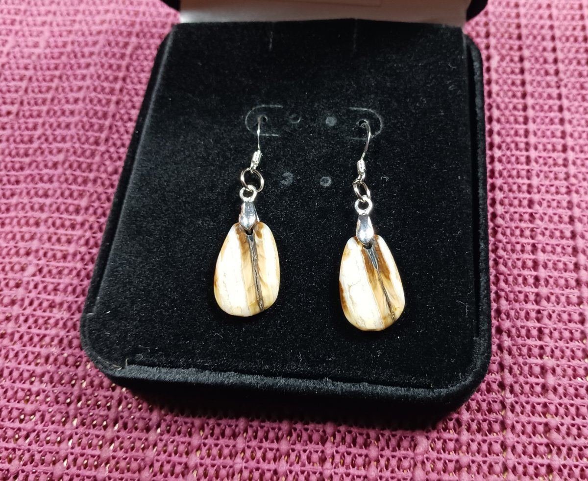

As happened with my previous wooly mammoth tooth rehandle, I saved a couple of small leftover pieces and made a pair of ear rings for my nieces birthday present tomorrow.

by doglegg
OLDE CUTLER wrote: Thu Apr 03, 2025 1:09 pm As happened with my previous wooly mammoth tooth rehandle, I saved a couple of small leftover pieces and made a pair of ear rings for my nieces birthday present tomorrow.
Knife restorer,
Miniature duck decoy maker,
And now Jeweler!
Wonderful work!
