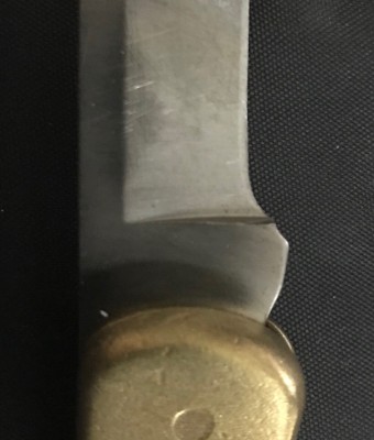

My apologies for the vague title. But I couldn’t think of a short title that explains this. Basically I hate recurves even subtle ones created by a bad choil area.
I think it’s caused by round corners on the stones at the factory. The trouble is these knives ruin the corners on good stones which ruins knives sharpened after that. If you are not careful.
It grows with each sharpening.
Each time you sharpen the curved part gets longer and longer. Or farther and farther from the ricasso.
Even worse it will lift the blade off the stone so it only contacts the belly leaving an inch of blade that doesn’t contact. And premature wear on the contact point.
I don’t necessarily like sharpening choils, but if they are very small they are ok.

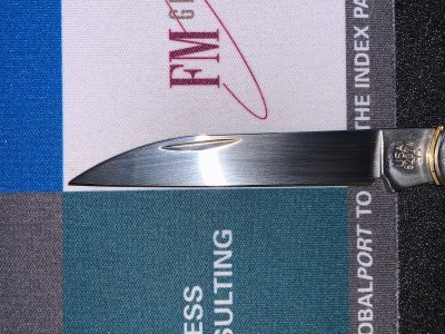

Small choil cut
Small choil cut
After sharpening.
After sharpening.
I cut the offending part out with a cut off wheel. Very careful to not go too deep. Then sharpen them normal on a diamond bench stone being sure to keep the corner pressed against the ricasso. Then I sharpen the belly to the point separately.
If done right after several sharpenings my little choil is gone and if carefully sharpened I won’t ever have to cut another one.

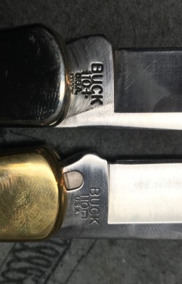

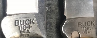

If the edge is not straight from the ricasso to the belly I am not happy. In kitchen knives I think this is caused by sharpening steels. Or generally bad sharpening. Ever seen a recurve wharncliffe? ::facepalm::

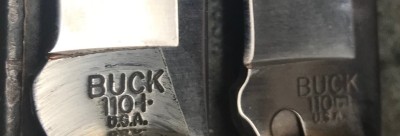

Also I try to keep the edge parallel with the spine. So the basic blade shape stays the same for its entire life it just gets narrower. As opposed to becoming a stiletto shape. Like the 110 below. This is caused by the slicing motion while sharpening. The closer to the ricasso the less time the blade is in contact with the stone. Again keep the corner of the stone against the ricasso.
Loss of belly.
Loss of belly.
For me it is about maintaining the integrity of the blade even as it’s sharpened down.
These things bother me much more that getting a shaving sharp mirror edge. Which seems to be what others care most about.

If you’re saying these came like that new, it sounds more like a manufacturing defect than a sharpening defect. Most factories do not use flat stones, they use sanding belts, or in some cases wheel/grind stones.
