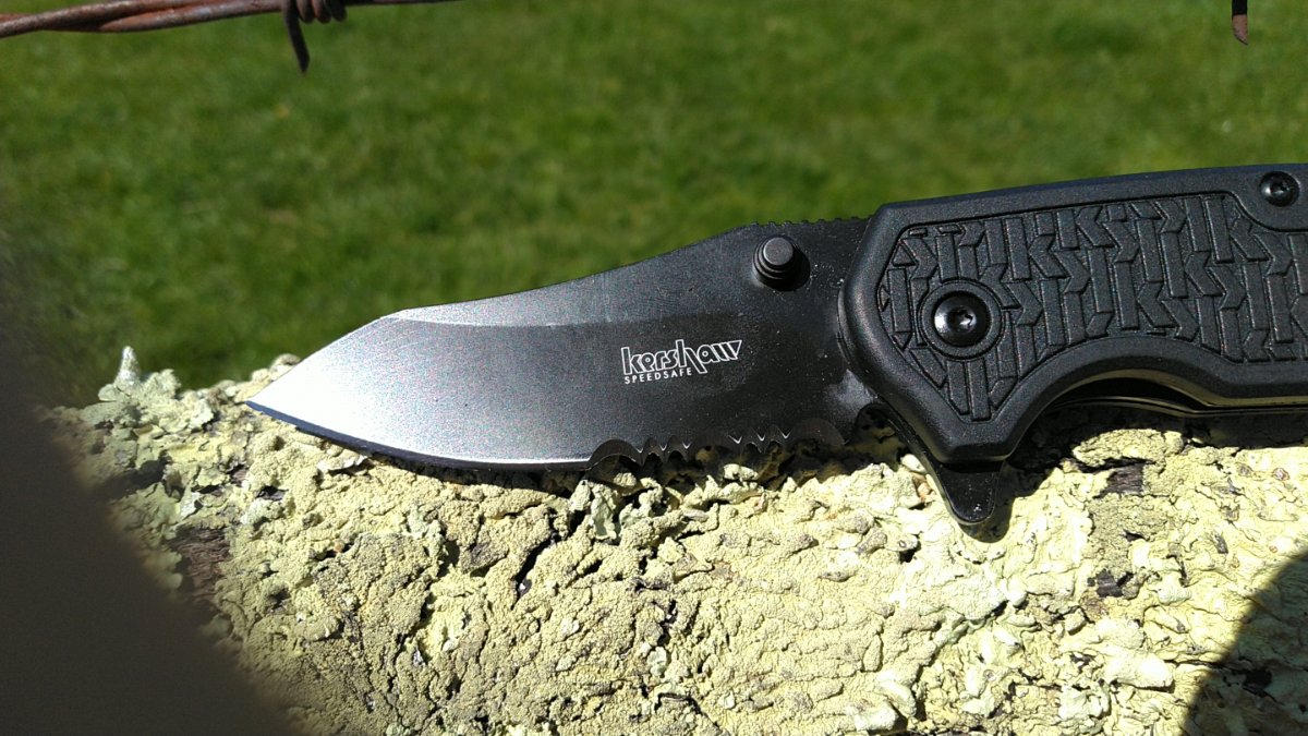

It has a 3" modified sheepsfoot blade with Speedsafe opening. It fires out pretty quick. Action isn't as smooth as my USA Kershaws, but pretty decent given this is a budget model. I love the blade shape. Work knives, by my choice and taste, almost always have serrated blades for rope and brush.
Note back of blade says "3Cr13" and "3100WM". Given Kershaw's website says it uses the good 8Cr13MOV and my knowledge of Kershaw model numbers; I presume Kershaw had a cheaper version for Walmart that is 3Cr13 steel. From what I'm seeing 3Cr13MOV is equal to 420J2, which as I understand, is some pretty cheap stuff. Given this knife is so cheap, it is "no holds barred" and will be a work beater, thus it will be seeing real edge retention and toughness tests (within reasonable limits--I never pry with a knife or use it as a screwdriver).

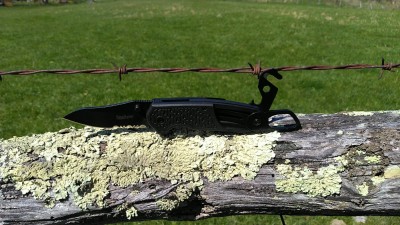

The main selling point of it being an "EMT" knife is the strap cutter. It is designed for the cutting of straps, cordage, clothing, and seatbelts. I mostly use it on paracord and baler twine.
The cutter itself is very sharp, and works great. I think it could have been reversed in its positioning in the tool. The 1/4 hex bit driver is a joke, does not work. The large slotted SD on the tip works great. Bottle opener not yet tested.
Both the carabiner and cutter have linerlocks. The cutter I can open easily with just my left hand.
The carabiner. I mostly use it as a tip lock in a similar way as to my Chive, to keep something from nudging the flipper, and firing the blade open. That's intended to keep one from trying to use it with the carabiner open, but an improvised use for me. It's a really thin, and flimsy carabiner. As you can see, it has no problem clipping it into the tiny hole on my coat zipper. I prefer lanyard hole, and heavy duty carabiner of my choosing. One of my other rescue knives is designed with an oversized lanyard ring just for carabiners.
