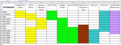

Don't know if this will help you on your specific question, but you might find this information helpful in the future. (Click on the image to get a closer look).
