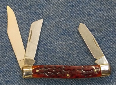

I have been buying and collecting Schrade parts for almost as long as I have been buying and collecting Schrades. Over the years I have accumulated some handles for the 8OT and some new blades as well. I decided to put them together with some Amber MBC jigged bone that Culpepper did in a very limited run several years ago. I like it because it looks a lot like worn Rogers bone. It's not something I have seen more than once or twice from Culpepper's and I think the last set I got was about 8 years ago.
So I'm starting out putting together a brand-new 8OT made brand-new parts, with the exception of the secondary blades spring; that I had to rob from a donor knife, and I have several of them. I got the new bone on the handle assemblies and I put the new Swinden assembly, (center liner/master blade spring/& blades) between the two handle assemblies and fitted together. It went together more easily than I expected. I did some rough shaping on the handle and test fit it several times, up to and including installing the rocker pin and checking the walk and talk; it was all a go, everything was working great.
If you haven't worked with new Schrade parts, they are oversized from what you find in a finished knife. You have to grind down the extra handle material and the new backsprings so everything fits properly. I did that and was really getting excited. Everything was great, I spun the rocker pin and my spinner kicked off of the pin and "walked" on the handle leaving definite markings that were deep enough I couldn't sand them out.
I thought "oh well, it still looks really good!" I made one last pass over the backsprings with a 220 belt and walked to my bench to admire it in better light. I was quite pleased with the results until I happen to rotate it just perfectly under the 15 power lighted magnifying glass and I saw "IT!" There is a very tiny and tight crack right through the rocker pin about half the width of a human hair. If you didn't know it was there you wouldn't be able to find it unless you were inspecting it closely for flaws, as I was.

Here are some pictures of the 8OT and one picture that even as the crack circled and highlighted so you can find it. I have begun to repair the West to go, replacing the bone that I dyed. Fortunately I had a piece large enough to replace that handle. I’ll have to get some pictures of it when I’m done. I don’t think it can eat before pictures.
