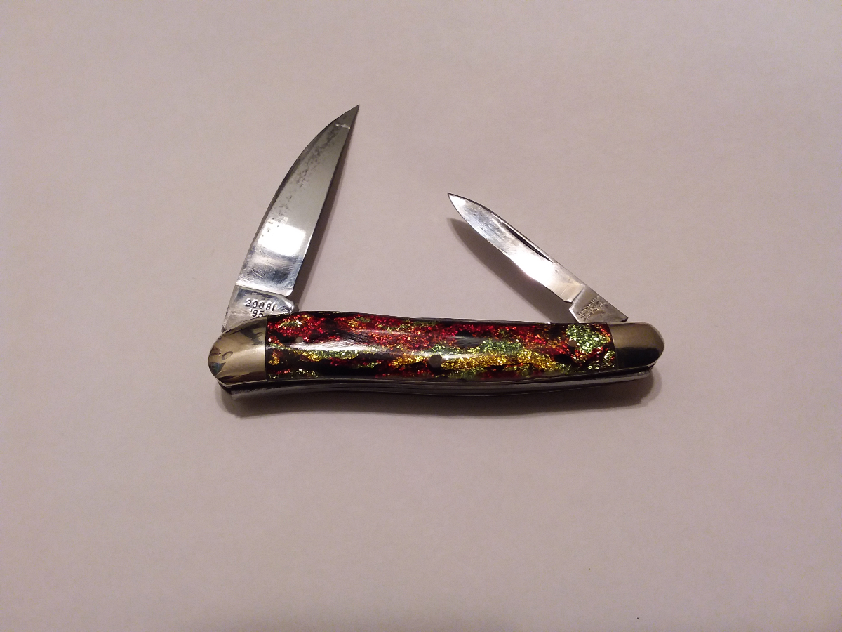

I know all about the pitfalls of celluloid and am experiencing some problems right now with a celluloid knife. What I wanted was thoughts on newer modern celluloid handled knives. I know that no one has a crystal ball and can look into the future, so this question could be answered with just opinions, and I understand this. I have an opportunity to purchase a Case Christmas Tree Cheetah (celluloid), and a Case Gold Sparkle Cheetah (Is it celluloid?). I'm really attracted to the Christmas tree knife. It's celluloid, but modern celluloid. Does anyone know if this material has been made more stable in our modern era, or is it still the same old miserable stuff. The gold sparkle knife looks to be celluloid as well, but I don't know this for sure. I'm really on the fence with this purchase. I have some pretty old celluloid knives that are still in great shape and a few that are bad and one that is only about 20 years old that is deteriorating. I rarely sell knives, I keep them, so it would be a knife that would be in my collection for years to come. I was just looking for some insight before I make my decision. I haven't purchased a celluloid knife in quite a few years because of their reputation, I usually pass over them. What are your thoughts. Thanks.

Since no one seems to know what triggers celluloid to self-destruct, or what causes it, I have to doubt that the material is more stable now. ::shrug:: Anecdotal evidence would say it's not - for example the German Bulldogs with celluloid handles, and the Case Classics (all but a few of which were actually made by Queen, to Parker's specifications).
Case goldstone is celluloid, and fairly well known for outgassing. Is gold sparkle something different? Christmas tree and candy stripe seems to be some of the more stable stuff. YMMV. And that's why I don't buy anything celluloid unless it's inexpensive - you could wake up one day and find your money has gone up in gas. ::facepalm:: With celluloid you never know.

The Case candy stripe from the early 2000s can outgas. Although the ones I have , have not gassed yet.
Case " goldstone" does outgas.
The new gold sparkle is kirinite, it does not out gas.

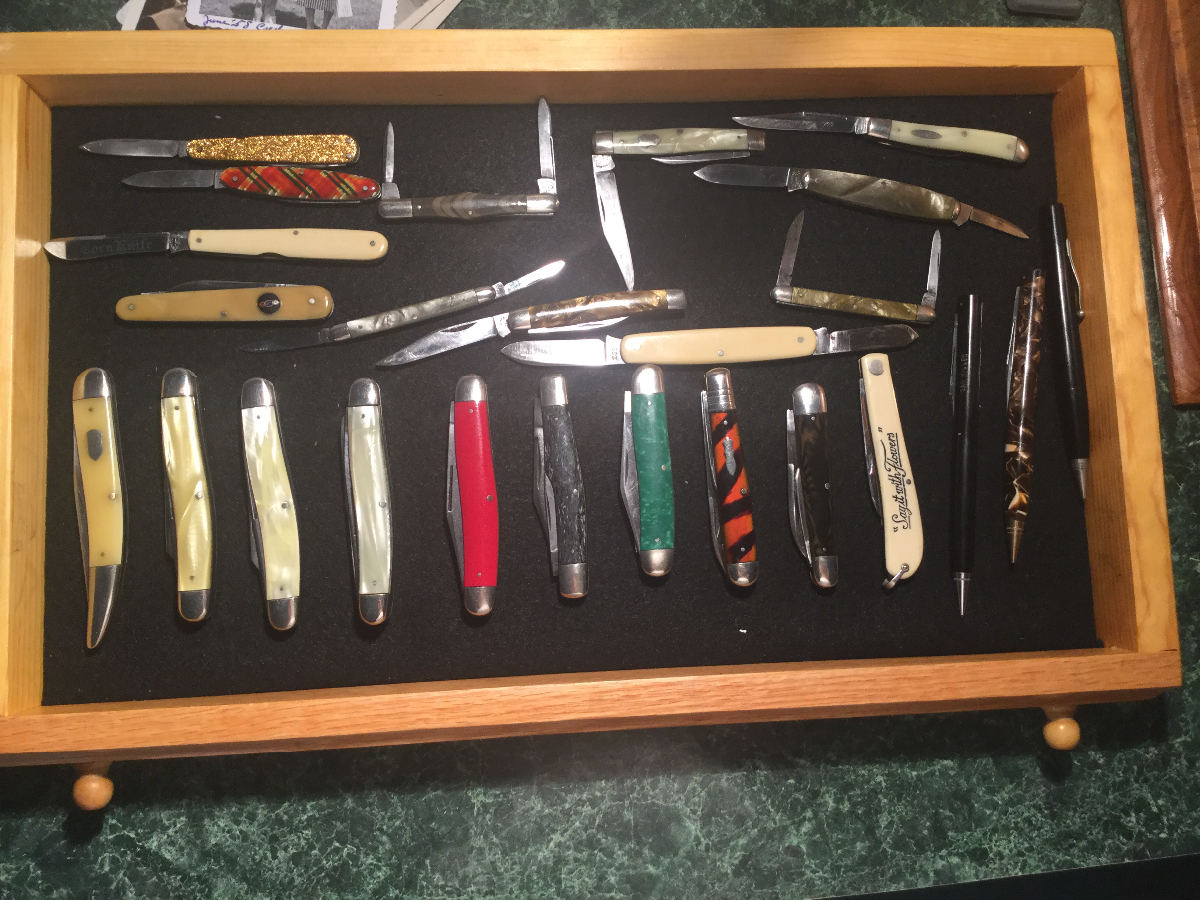

I think I have close to 200, 1920-40 Remington celluloid knives and I've only seen one that was gassing. It was purchased in a large group and I don't own it any more. Not saying they couldn't start at anytime but the way I store my knives it doesn't bother me to own the old ones.
