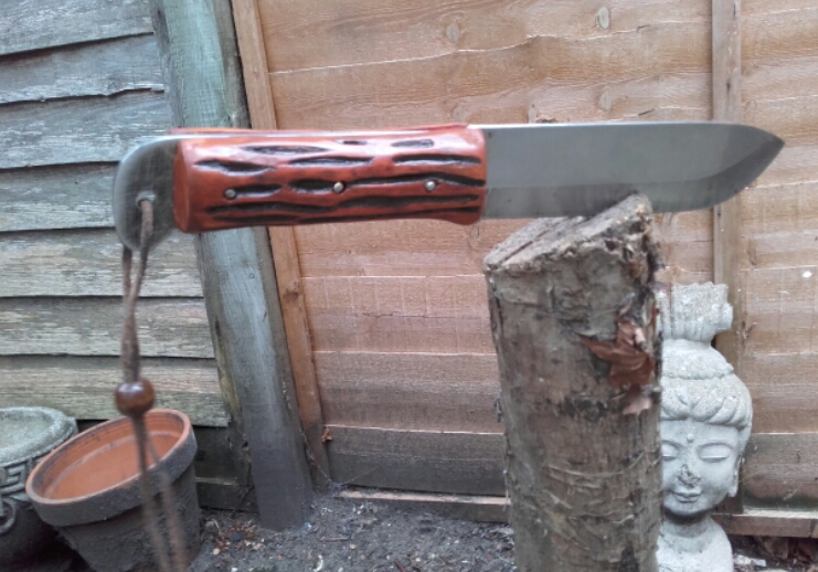

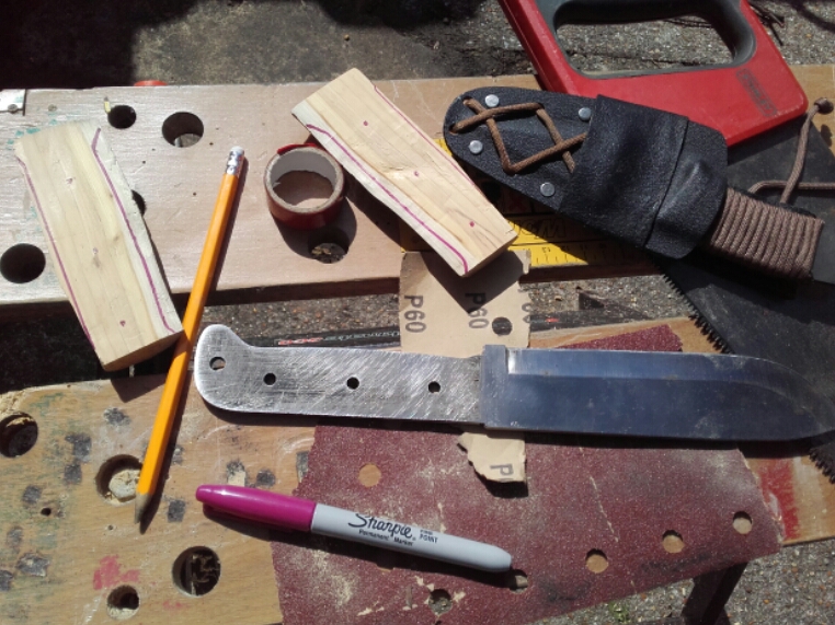

I thought this is the right area as is whittling ::tu:: I've wanted to make new handles for my MOD type knife for years,I've used this as a camp knife for a long time and it's become a trusted knife, I removed the guard ages ago as gets in my way. I'm not sure what wood I used as I picked it up ages ago but it's pretty hard but the Imperial schrades coping blade performed faultlessly, plus comfy to use, I've photographed the process, I'm very happy with the handles and I just need nicer bolts and Finnish the backside to make them more flush but they look nice,I'm going to do some of my Sak's and Mora #1 next ::tu::

Thanks phill ::tu:: I've just planed the backs flushed so they fit better,just need better fixings and glue them on,I'm just putting another coat of stain on both sides ::tu::

Very nice Z!! Thanks for the step by step photos, that's very interesting to look at. You did a fine job Sir... ::tu::

Thanks guys for all the kind words ::tu:: this has been a fun project ,as for what wood I've no clue :D it was picked up ages ago,probably my youngest picked it up :D it's pretty hard wood but nice to carve,at the moment it's just got 3 screws holding it together for now ,I want allen type bolts with recessed nut on oposite side,preferably in black, plus I'll epoxy the handles on ::tu:: I'll post pics as I do it ::tu::

The big knife stuck in the stump looks great !!!
the scales you made look too have great purchase to
the grip of the knife...outstanding !!!
I love a straight blade knife with extra thick stag scales to wrap
my hand around,, and you have achieved that with them, nice work !!!
