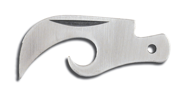

by Edgewise
Is this the one you describe?
This is the one I meant. There seems to be no stud. Maybe the nail nick part is braced on the can rim and pulled upwards.
I use this one. It is pushed forward.
[The extension gif has been deactivated and can no longer be displayed.]
The electric one isn't pocket friendly. ::shrug::
This one is also popular but I think it is pulled backwards.

Don't try those top 2 on a modern can. Those are from a time when tin cans were made from tin not steel.
Bruce
