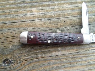

I noticed this knife on Ebay and thought I would get some opinions on it....excited to be a part of AAPK. eBay item number:
201685276175
Re: My first post.....questionable?
Posted: Fri Oct 14, 2016 7:14 am
by SteelMyHeart85420
I don't doubt it's genuine...I do suspect it's short, and reground to a non-factory profile
Posted: Fri Oct 14, 2016 8:25 am
by Landersknives
::tu:: Ok I knew it looked reshaped I thought the grind was off also like they might have used different blades. Thanks.

Beside the short blade it looks to have delrin handles. Not really a knife someone would counterfiet.

If the "repair" you're talking about is this, I don't think it's a "repair". Looks more like some kind of hot gunk was splashed on the handle.

6214 1/2 well worn delrin

It's a Frankenknife. 6202 1/2 (barehead pattern) blade in a 6214 (full head and tail bolsters) frame. Knife has been completely taken apart and poorly reassembled. If you look at the pics from the auction posting you can see that the center pin is not original. The back spring for the master blade protrudes from the frame at the tail end. I don't think the pen blade is original Case.

Looks like the center pin was over peened...the delrin is bulging on the mark side.
