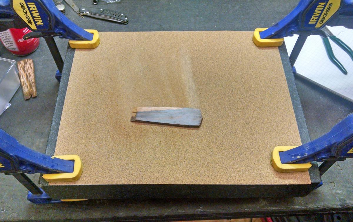

I made sure the backside of the wood was completely flat by using a lapping block.
I use the sawdust generated on the lapping block and mixed it with epoxy to use as wood filler for the holes in the backside of the handles.
