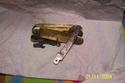

new can of worms-
remove the heavy rust- leave the patina-no scratches
suggestions?
KENT
N Y CITY
thank you,
trennon
the black one _in the middle
that is terrible pic
much better
getting the hang of this ... thanks to basser and junebugs tutorial finally a little consistency
thanks guys
trennon

Fine steel wool will remove the loose rust and won't scratch.

I'd suggest starting the rust removal process using a No. 2 lead pencil. Serious.......rub the rust with the point of the pencil. It will remove the rust without scratching the metal. You might want to apply a coat of oil and let that soak overnight before using the pencil as the oil will soften and loosen the rust a bit.
Keep us posted on how it goes.
Phil

Number 2 pencil is super good, have used it since I found out about it

Could have been either one of us. We're both cheerleaders for that process. I got it from someone else on AAPK a few years ago. You're right Phin, works great unless the rust has started to get crusty and pit. Then ya gotta scrape it off with another knife or something.

tried the pencil trick on a lighter rust mirror finished ulster and it worked great
for this one I resorted to a softer blade steel scraper knife (Imperial Ireland) then steel wool
and yes I had oiled it first with my fav., ATF
previously I had scratched a -H.M.SLATER- using a -NORVEL SHAPLEIGH- as a scraper obviously the diamond edge was no exaggeration
the only problem now is
I took the whole thing apart (rescale, whitetail antler)
Found lots of hard scale rust on the center liner and the springs; used the wire wheel on the springs, but burned my fingers trying to do the liner on the wheel so went back to the ulster scraper and got it clean. Trying to find a piece of brass lying around to fabricate a new center

Was the center liner not brass?
You may be able to find a similar-in-size/shape knife that you could take an old brass liner from. I also use the outer scales sometimes, and just pop off the bolsters. Those make decent liners in a pinch.

the center liner is steel, hence the rust
I did not wish to overheat the steel (I thought) on the wire brush is why I was not wearing gloves;did not really burn them just warmed them up a little
am gonna try filling the worn area with silver solder as it should be as durable as the brass on the other side
