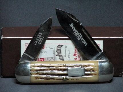

I have 3 S&Ms that look the same to me.
But yet the have differant numbers and names.
S&M Cigar Whittler 42265 Winterbottom 1 of 100 2003 3 5/8"
S&M Baby Sunfish 42101 S-6 Carved Stag 1 of 100 2004 3 5/8" my guess worng box.
S&M Baby Sunfish 42265 Carved Stag 1 of 100 2004 3 5/8"
The numbers are on each box. One box is smaller.Perhaps worng box... ::nod::
All have 42265 eached on the blades but echings are differant.
The thing I want to know is what is this pattern?? BABY SUNFISH??
Is it carved stag or winterbottom??

I think what you'll find is that the #42265 has been only a Sunfish Pattern anything else to the contrary is a cut and paste issue with the seller...and if it's the pattern you're interested in..2004 also saw the handle in Golden Root.Amber Wormgroove,Mahogany while 2005 introduced the pattern with the S&M signature bolster in Smooth Brown,Crimson Wormgroove and Bark Jigged Fire oak.
As far as the two images posted..the top one has been what Winterbottom looks like to me while the bottom images appears like a carved bone would look like.

As far as the two images posted at the top one has been what Winterbottom looks like to me while the bottom images appears like a carved bone would look like. I agree with you but the #42265 are on both knives and so is the year 2004.

Winterbottom is a jigging pattern. The color of the dye used can vary greatly but the jigging will have long straight furrows in the bone surface.
The carved stagged bone is a jigging pattern meant to replicate the look of natural stag in a bone handle material. The furrows are deep like in the Winterbottom jigging but they are more random in their disbursement and length.
The top picture Ken posted is one of a Winterbottom bone handle and the second one is of a staged bone jigged handle. The dye color used in both is similar but if you study the jigging you can clearly see a difference.
