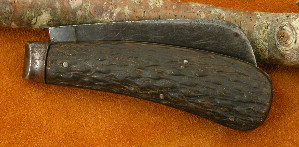

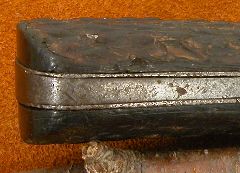

Some new info for the thread in terms of an example of a true "pressed horn" handle… Knife is a Joseph Haywood & Compy (Ca. 1845-1888) Hawkbill - (I’ll include some more history of this old maker when I post it in the Horticultural thread)… integral liners and bolsters so guessing +/- 1860… Classic teapot Tm stamp which was registered in 1860 and cool top hat kick on master.... anyway one question in this thread imho among the many is related to pressed horn as a possibility as the basis for the handle of the OP knife and perhaps more so for all other close examples posted in this thread - and this knife came to my collection in a serendipitous search :)
This Hawkbill pruner has a hefty handle in terms of girth so lots of handle to see… As described the horn was pressed using multiple overlaying pieces of horn that had been shaved to a layer, heated and trimmed to fit the mold in a stack (the latter info from the old articles noted above).. in fact I also had read that sometimes a dark reddish brown dye was used on these and I “think” I am seeing some of that color in this handle… Notably if you look at the enlarged photo of the sides of handle one can see the layers of horn overlaying each other and one can see the striations demarcating layers if you look closely. The mold pattern design in this case does not come close to those of all other knives here and not sure it would – not exactly a stag look, perhaps their version HSCRATCH but no doubt different… So given this example where I am seeing a clear difference to the many above I am leaning towards the OP knife and many similar examples not being horn but either pressed bone or a type of stag that was no doubt different than the well known old sambar stag, but imho definitely not pressed horn to give a stag-like appearance – I am not seeing the layering as in this knife on the majority of the examples above and a difference in the consistency when I look closely unless I am mistaken… jmo at this point which can always change with new info ::nod:: :lol: ...
