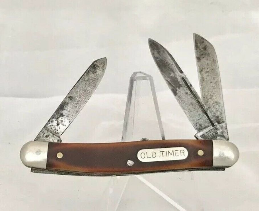

I thought I had an unusual 58 OT at first. It was advertised as a "Vintage Old Timer stockman knife, Ulster Knife Company". I always look at the Ulster OTs on the bay, looking for nice examples I can add to my collection. ANYWAY..... This one sure did look unusual. The blade complement was wrong. Hmmmmmm, I got it for a good price...... $11 shipped.
Well, this morning AFTER paying...LOL.... I took a GOOD LOOK at this guy. THAT IS WHEN... I see the rocker pin. Not factory and not at all put in very well.
It's a cobbled together knife. Oh well..... I think I will try to clean it, tidy up the rocker pin and carry it. I just hope the blades fit the wells good.
The seller was "theknifeorder" and if that is someone here.... no foul, all is good. I just got an inexpensive lesson. I NEED to examine these "looks too good to be true" knives a little better in the future.
Here she is.....
(Don't laugh...)

Up front, I freely confess I know little to nothing about Old Timers, especially the stockman pattern so please don't judge me too harshly on my question. Did Schrade ever make an Old Timer with a spear main blade? I don't recall ever seeing anything but a clip main blade in them. ::shrug::

jerryd6818 wrote: Wed Oct 09, 2019 1:14 pm Did Schrade ever make an Old Timer with a spear main blade? I don't recall ever seeing anything but a clip main blade in them. ::shrug::
I don't ever recall seeing any Old Timers with a spear main blade. This is probably going to be an Ulster knife with the Old Timer sides on it... (???)
I guess I need to try to find out which Ulster this was... is.... was....

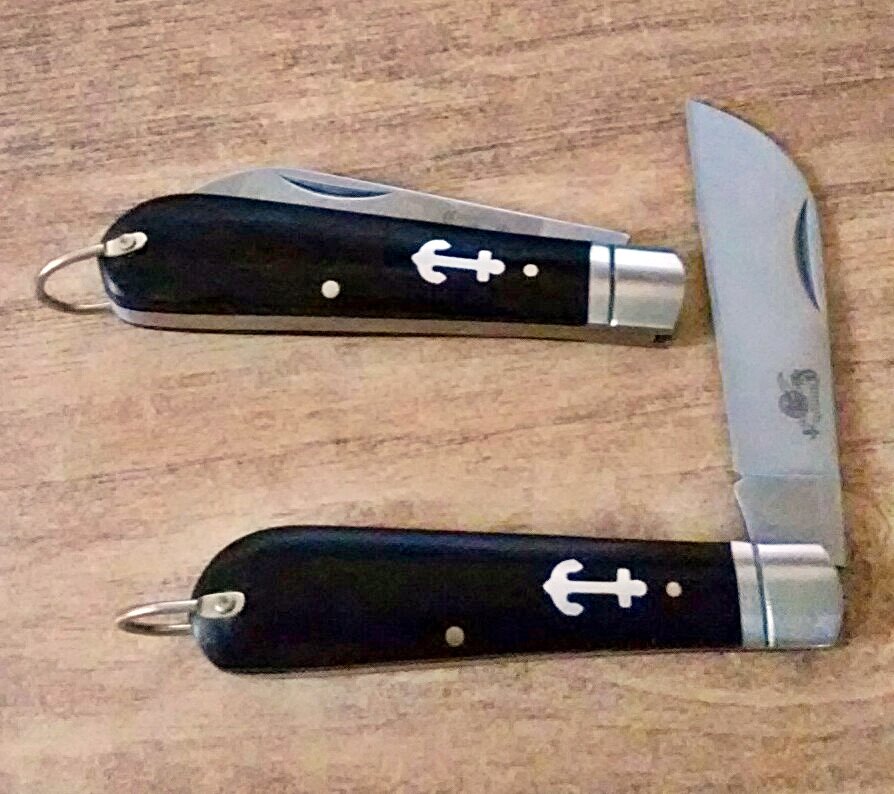

Would you like to see the pile that makes my point?? Here's two recent purchases (last couple of weeks). Bought one and then as a test to see if what I thought was true, I went back to the well and got another. ::uc:: It was true. They both have sloppy half-stops. There are others which preceed these two but these were handy and fresh in my memory. Ten bucks apiece including shipping.
Gave one to my buddy today.

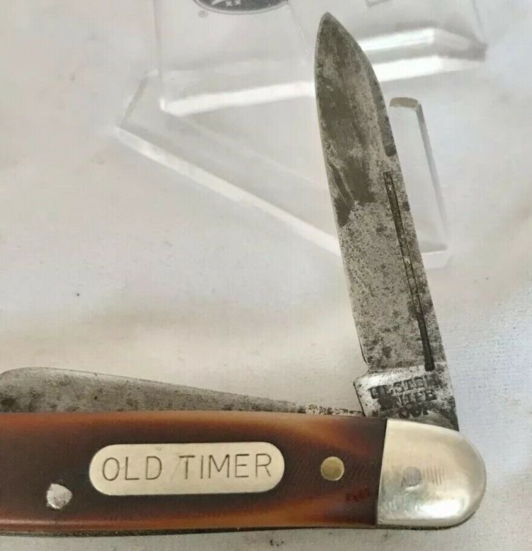

Well, I just got this little joker in my hands. It's pretty much a train wreck.
The spear point blade that was added doesn't even get close to fitting. It doesn't EVER engage the back spring. SO... no snap, no NOTHING.
The other 2 blades look to be original to a 58 OT...... but..... the main blade must have come from a smaller knife. Look at the pull.... it just disappears down into the blade well. AND, the tip of the blade is up out of the blade well. If it were down inside then the pull would almost disappear.
ALSO.... This new ....LOL.... main blade that was added is too straight on the outside edge and it scrapes the liner from opening to closing. What a MESS....
Well, I guess I have a parts knife I might be able to harvest a blade from.
I just looked at the sellers pictures..... They were ALL pictures with the knife open.
So there you go.

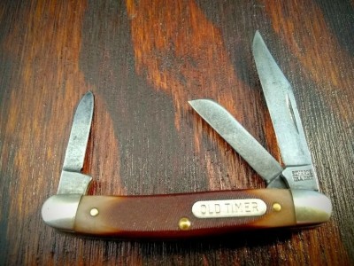

And another thing I just noticed.....
This is a 108 OT that was modded up not even a 58 OT to start with...
IT....
A 108 OT...
Oh well......
