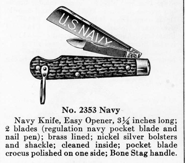

My opinions for what its worth, it is not a WW1 Navy knife, they were bare end with a bail and no shield, the main blade profile is not as wide as the Navy knife, I have an early Cut Co boys knife with this profile, I will add pictures later.
This one appears to me to be a civilian version in a boys knife size, would make sense to me as Schrade would have had nail file blades to use and why not make another knife with those blades, I know when I was a boy I needed a lot of nail work
It is a very attractive knife even though its been buffed, it does concern me that I have never seen another example but very few may have been made. The seller does list a lot of rare and unusual vintage knives and prices are high, I did make an offer on this knife but it was declined.
Pictures of the Schrade Cut Co I have and a WW1 pattern Navy knife by Thomaston.

page 31, catalog E. OP knife has substituted a manicure blade for the pen blade. Very possible right out of the factory. Shield difference, also very possible out of factory. Thinking a box full of six for a small sfo at a bank or butcher shop, etc. Pre-1930 jigging. Very bad price, poor condition when observed from my crow's nest.

I've been interested in WWI Navy issue rope knives and this one popped up in one of my searches.
Problem was, it's not an Easy Opener, it has no bail, nor does it appear to have ever had one and it has a bottom bolster, which the Navy knives did not have.
I thought, possibly, Schrade had simply taken the Navy rope knife parts after The Armistice and created a pattern that would allow them to use them up in a knife offered to the general public.
I shared the auction with a fellow AAPK member and they thought it to be bogus and suggested I post it here.
Were it an obvious U.S. Navy issue from WWI, I would have been interested in it.

Here is the Schrade Cutlery Company offering of interest, same page (31) as other knife, 1926 Catalog E.
