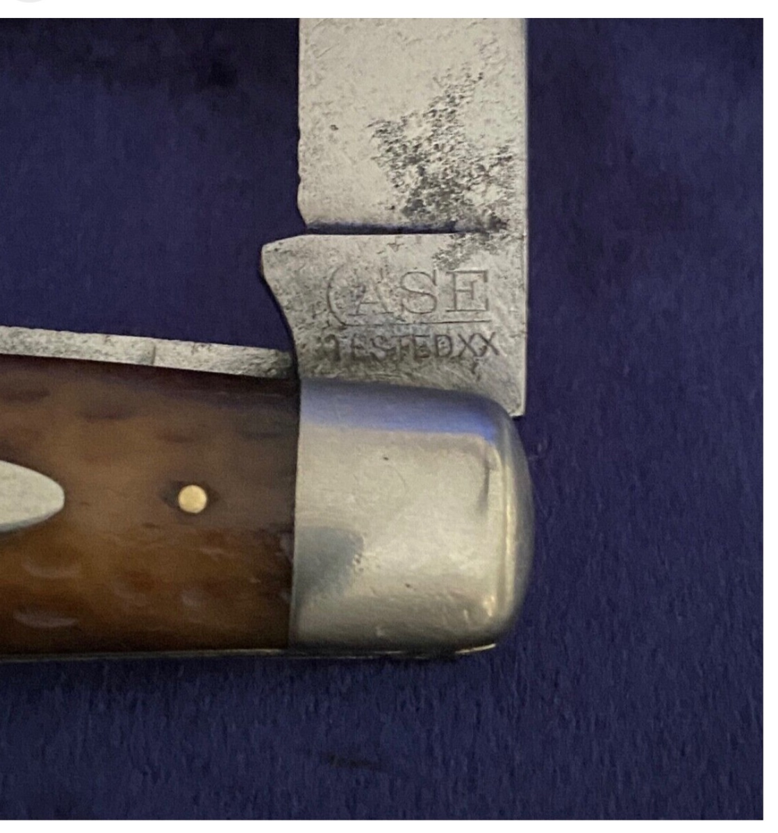

Saw this Case Tested Swell End Jack pop up, I’d really like to get my hands on one but I’m wary of all just because of the amount of counterfeits made. I also don’t have much experience with them yet. I thought I’d post this one while it’s still up and get thoughts on it, maybe I can learn some things to look out for as well. Thanks guys.

This looks like a Tested 6235 1/2 but the closed length for this model is 3 1/4". I don't see anything wrong with the knife, it is legit. The price is quite a bit higher than I'd pay for a knife in this condition. I hope this helps you out. Ricky
Re: Case Tested Swell End Jack
Knife looks right to me, but way overpriced. I don't really understand why folks like these, many companies made better knives than Case.

The knife looks okay to me. What I see is the bone and jigging matches the era (Tested XX) stamped on the tang, as does the shield https://www.allaboutpocketknives.com/ca ... xx-shields. The tang does not show any signs of having been ground down (aka shaved). The backsprings appear to be matched/aligned (one is not longer than the other) which is sometimes seen on knives that have been apart and re-assembled from mismatched parts. The blade grinds and shapes look correct for Case. Last but not east it does not appear to be “cold stamped”.

Although the seller say the blades are nice and full the pictures say otherwise. May be some issues with the handles, most notably the back side. I wouldn't entertain buying the knife at half the listed buy it now price but that is just my thought. Many knives on eBay seem to sell higher than what I would expect.

Thanks for all the responses guys, I’ll definitely pass on this one for the high price they are asking. But I will be spending some cash for reference books. Seems like they’ll do me a world of good in dealing with these knives!
