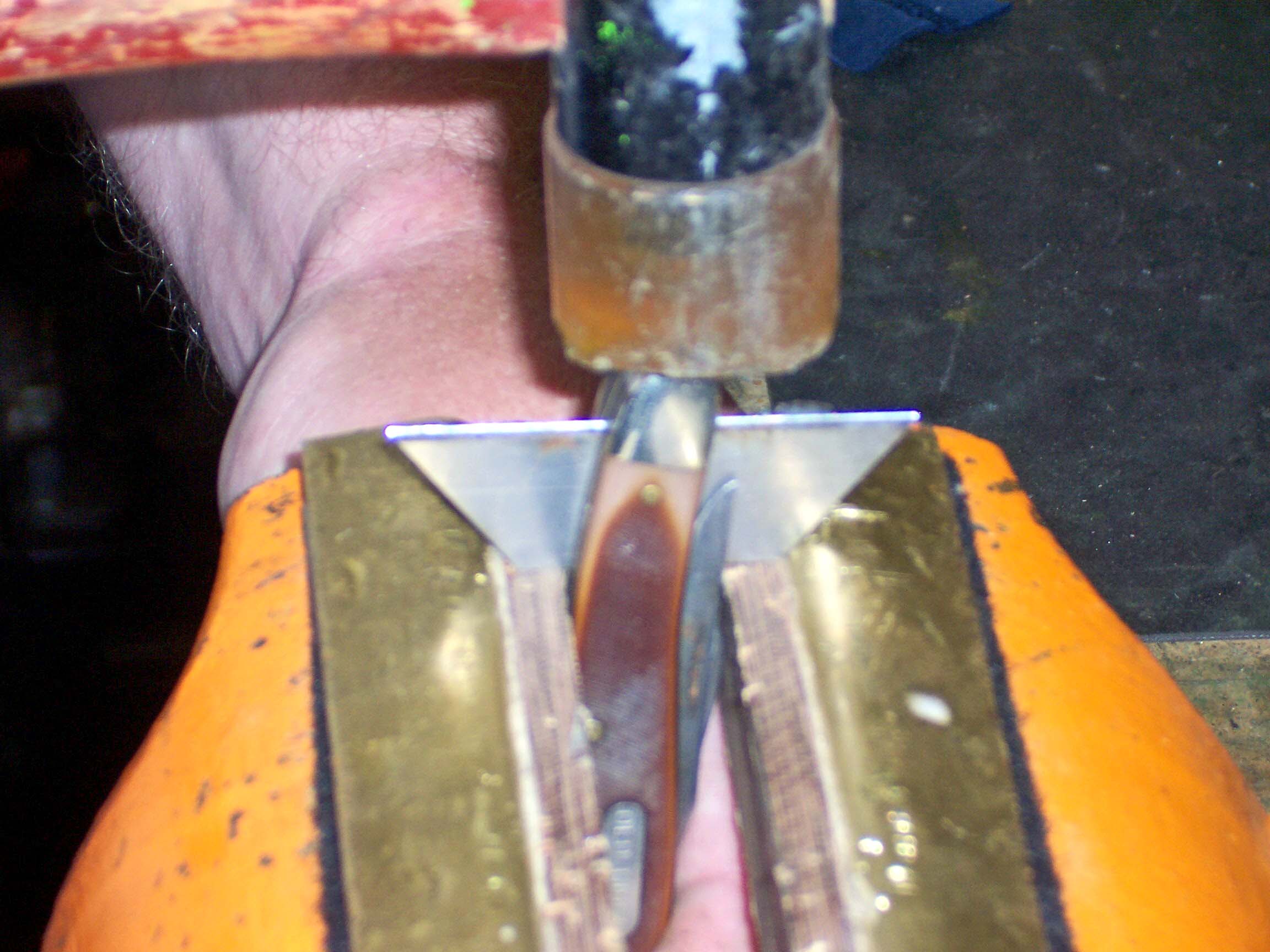

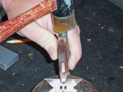

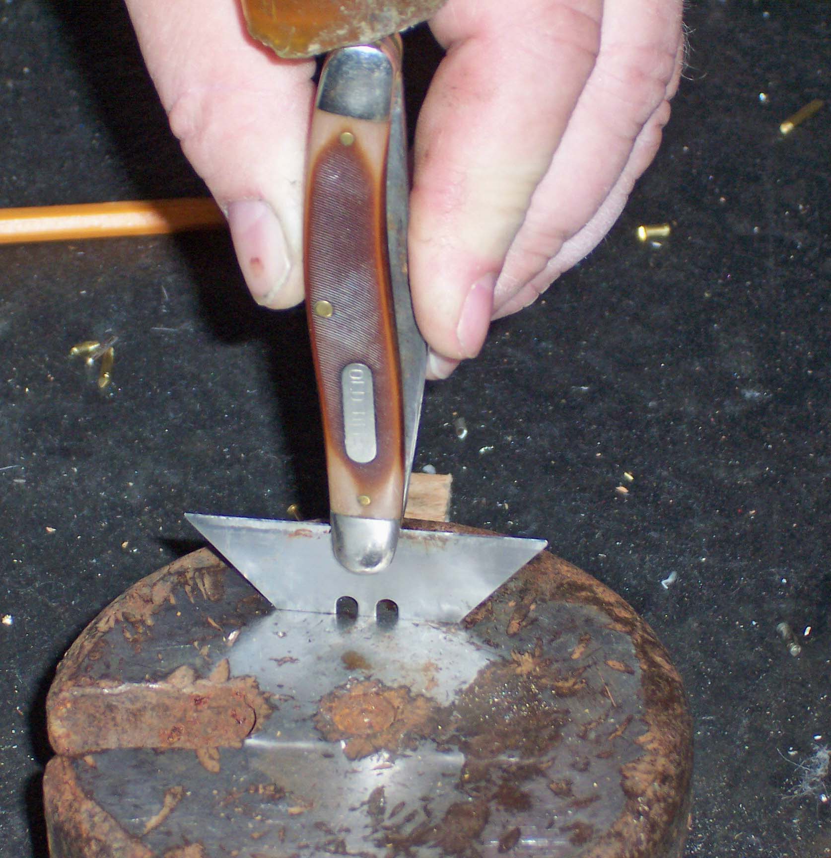

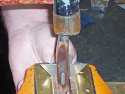

Step 1- Position a heavy duty disposable razor blade between the blade & liner. If the knife is multi-bladed, place the razor blade as close to the center of the knife as possible. Be sure that the razor blade does not bite into the liner, but runs parallel between the liner & blade.
Step 2- Tap the rear bolster of the knife with a soft-faced hammer to avoid damaging the bolster.
Step 3- After cutting the first pin, continue on to cut the rocker pin. On this step I moved the knife to where it is suspended between the canvas Micarta faces of my vise, so that the sides of the knife can pass on either side of the razor blade, & the between the jaws of the vise.
Step 4- Continue tapping the razor through the last pin. Be careful and don't hit it too hard or pieces of knife can fly in all directions. Just tap lightly & the knife will fall apart.

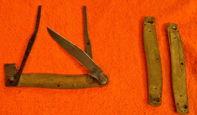

If you were just looking for a pic of a Swinden type knife apart, with rivets intact, then I also have such a pic.
Note:
It was a Muskrat pattern, 77OT, with a broken blade.
Hope this helps,

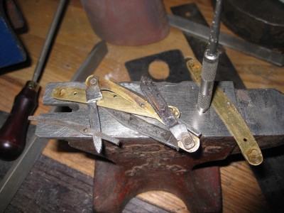

Excellent question Dave.
If I am going to take a part a Swinden type knife and want to put it back together using the Swinden rivets, the process is entirely different.
A- Using a small flat file, carefully file the dome of the rocker pin flat so you can locate the center.
B- Using a spring-loaded punch locate the center of the pin and peen a center mark that is fairly deep.
C- Using a small burr or very small drill bit, drill deeply into the pin so that the hole goes down the shaft of the pin. Keep in mind on a Swinden knife the rocker pin is probably 3/32" in diameter. When I drill down the shaft I normally use a 1/16" drill.
D- Using a larger burr that is approximately the size of the head on the pin, grind down the pin head.
E- This next step is a bit tricky as it requires three hands or more. Open all the blades of the knife & compress the backsprings using a vice or a Camillus type knife vice to compress the spring, the Camillus type knife vice is the easiest way to do this and less likely to damage your knife.
Note -- Camillus type knife vice & usage: http://www.allaboutpocketknives.com/kni ... 38&t=10069
F- Insert the 1/16” pin punch into the 1/16" hole you have drilled in the pin and drive the pin out of the knife.
G- Grasping the handles and bolsters on one side, turn it counterclockwise until it comes loose, approximately 5° of turn in the counterclockwise direction.
If I'm in a hurry and I am going to replace the handle material on the knife anyway, I use a rotary tool, (such as a Dremel or Foredom), and a burr; to grind the head off the rocker pin. Then I go directly to step E.
The only reason I can think of to keep the Swinden key system intact is if I were going to replace the handle material and reassemble the knife using the Swinden key system. I have done this quite successfully, however if there needs to be any repair work done or blades replaced the Swinden rivets must be cut and the knife converted to pin-through-bolster construction.
I hope this answered your questions,
