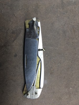

I received two 5OT’s from an AAPK friend as freebies. One was a green handle knife with a heavily worn blade and broken springs, the other was a brown handle knife with a decent blade but some ordinary handles.
I worked on a spring replacement/repair previously but the spring tension was too stiff so I put them away for a bit to work on other things.
This week I dug out the knifes again.
You can see in the photo of the springs (one on top of the other) that the end of the one of the springs is snapped off.
The 5OT’s use two of these springs in each knife. Both springs were broke in this knife one one spring was broke in the other.
I had previously purchased some spring stock from Jantz for a different project so I scrounged around in the shop until I found it.
The two original springs were about the same thickness as some nickel silver stock that I have so I decided to make a new rear knife spacer and cut a groove in it for the spring stock. The angle of the new spring doesn’t quite follow the old spring (you can see the outline of the old spring on the liner). But it seems to give enough tension to keep the lock bar in its correct position.
I cut and shaped the new nickel silver spacer to mimic the shape of the old springs. The groove for the spring stock was cut on my bandsaw. Once everything was roughly shaped in I reassembled the knife to make sure everything fit correctly.
The new spacer was just slightly thicker that I needed so I took it out to the belt sander and got it to the right thickness.
I temporarily clamped it all together to make sure everything looked right.
I decided to use the green handles because they looked to be in a little better condition. It turned out okay. I’d probably make a few changes to the repair procedure next time but as a concept it seems pretty solid.
The finished knife handles look dark in this picture but that’s because they were taken with my phone.
And since I didn’t have a dedicated buffing wheel for the brass bolsters, I polished them out buy hand with increasingly finer grits of sanding sticks.
It was a fun project. It didn’t turn out perfect but for a first attempt at this type of repair I’m happy with it.
Jeff

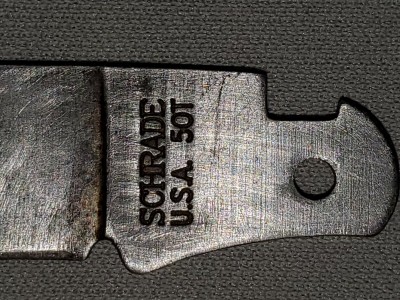

What was the bushing in your 50T made of? I know someone suggested using stainless steel tubing to make a new bushing. I believe they said the tubing could be obtained at Ace or True Value. I have not been to my stores yet. but hopefully I can find the tubing material. As far as I know, I'm just going to need the one bushing for the 50T I'm working on.
If I can get the bushing out of the original blade, do you think it could be used again? That is, if there is no more damage to it. If that is a possibility, do you have any suggestions on how to get the bushing out? Any other ideas would be greatly appreciated.
Kindest regards,
Jerry Johnson
Better side of bushing hole.
Worst side of bushing hole.

Are you sure that's a bushing? To me, it just looks like marks from something in the liners grinding against the blade. Of course, I could be wrong, just ask my wife...

How big is the hole in the blade? Some of those knives used a bushing and some didn’t. The hole in the blade shown doesn’t look that large, it might not require a bushing. I believe the one I had without a bushing just used a 3mm pin.
Jeff

I'm using a new blade blank. The hole in it is 2.4mm or 3/32". Maybe I need to use a 3mm pin, but then I will need to drill out the holes in the bolsters. Is that what you did?
Jerry

No, I would machine the pin to fit the hole. You should be able to machine a 2.5mm pin down to size to fit. Chuck the pin in a drill and use a file and/or sandpaper to get it down to the size you need.
Or find some 3/32” pin stock and use that.
Jeff
