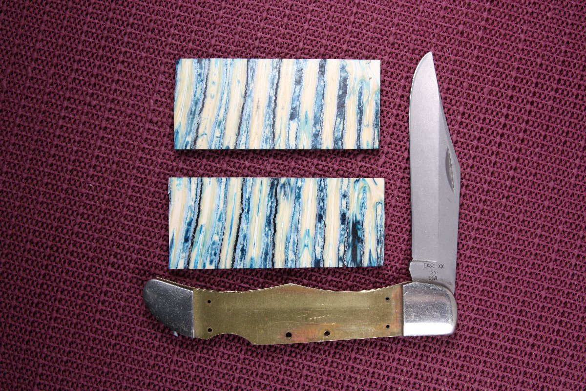

I sort of blundered into this project by asking a local guy I have known for years "what do I owe you for this?" after getting several sets of stag knife scales and some nice ironwood pieces from him. He said "can you rehandle a folding knife for me?" I answered "sure what have you got?". Then he pulled out this Case folding hunter lock blade and the two slabs of wooly
mammoth tooth that he wanted installed. I figured what the heck I will do it for some practice in case I ever get some wooly
mammoth tooth scales for myself. The first thing I did was to check on AAPK if any of you knife mechanics had done this material before and had posted any tips. After reading up on the material and techniques, I got going and got it done. I was very careful with the material when cutting and drilling, but didn't have any problems with it and it turned out decent. Any of you who have worked wooly
mammoth tooth before, does this material need to have a topcoat to seal it when the sanding and polishing are completed.?
It kind of blows you away when you think to your self that the animal that this material came from has been dead at least 10,000 years, but still lives on in the form of this knife.

The darker lines in the material are softer and tend to break apart from the harder light areas. I cut the material with a fiberglass cutoff wheel in the Dremel tool while clamping it between two pieces of plywood. It drilled easily with no chipping with a titanium coated bit. When working it on the power sander it gives off a smell like bone. I used Acraglas to bond it to the brass liners of the knife.
Cutting the wooly
mammoth tooth. Clamping between plywood scrap keeps it from flexing and possibly breaking.

Nice work. no topcost needed.
Main thing is going slow with this stuff tryo to rush it and it'll end up chipping or separating
