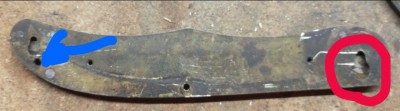

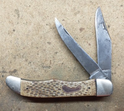

This Frontier folding hunter had loose plastic scales and a lot of blade play.
Before
Before
When I got it apart I was surprised to find that it must have been made by Schrade for Imperial, as it had Swinden keys. Well, at least it did on the front bolster. It had the keyhole on the rear bolsters, but they were not used. It was pinned through instead (marked in blue).
Partial Swinden key
Partial Swinden key
I love the way it looks now with Oak handles, and pinning it through the front bolsters fixed the blade play. I have had problems lately getting my blades centered in the wells after repairs, and I got that problem figured out. But now both of these blades are stiff when closing. They have great opening snap, but none on closing.
Any suggestions?

Reverand wrote: Sat Jan 01, 2022 5:46 pm This Frontier folding hunter had loose plastic scales and a lot of blade play.
When I got it apart, I was surprised to find that it must have been made by Schrade for Imperial, as it had Swinden keys. Well, at least it did on the front bolster. It had the keyhole on the rear bolsters, but they were not used. It was pinned through instead (marked in blue).
I love the way it looks now with Oak handles and pinning it through the front bolsters fixed the blade play. I have had problems lately getting my blades centered in the wells after repairs, and I got that problem figured out. But now both of these blades are stiff when closing. They have great opening snap, but none on closing.
Any suggestions?
Interesting story about the Frontier brand, some of them were made in Providence and some were made by Camillus and that is established through factory records, and some were made by Schrade as the Swinden key clearly Indicates. Depending on the model and when they were made a given Frontier pattern could have been made in two or three different factories, all owned or controlled by Albert Baer. Eventually, he was the sole owner of Camillus, Schrade and Imperial.
A couple possible reasons for your blades being stiff in closing:
- Wear on the round end of the tang.
- Front bolsters not parallel to one another. This might be caused by having one handle a little too long and it is not allowing the bolsters to set parallel to one another.
Those are a couple the come to my mind at the moment.
Hopefully somebody else will have a good idea as to what caused that, perhaps Eric, Glenn or someone else has encountered this before.

Great job, Rev, and great thread. All of the folding hunters with Swinden keys were only Swinden on one end.

That is both extremely interesting and unexpected. And where is that stuff now? I believe that Herman Williams planned to destroy the jigging machine.

Reverand it sounds like it could be one of two things:
1. Your blade tangs are binding up between the liners when the blades are closed. This can be remedied by opening up the gap a bit. Youcan accomplish this with a thin blade such as a muskrat. I've used a stockman blade in the example. It's important that they're thin though so you can slowly open it up. Just open a blade halfway, slide the blade alongside the tang at an angle, and then while holding that blade against the gap between tang and liner close the knife blade a bit, say roughly to about 45 degrees, maybe less initially. This will force the liner apart just a bit. You want to go slowly, don't force it way apart or you'll make it too loose. You may need to do it with both blades or if not too tight just the one might do the trick.
2. The spring might be bound between the liners. You'll notice this is the culprit if the spring doesn't follow the blade tang closely when you close the blade. It'll stick out a bit from the liner and you'll be able to push it in to the gap with your fingers. If that's the case you can open this area up a bit by opening the blade fully and then laying it flat on a stiddy or table edge with the bolster against the table. Take a mallet and give the bolster a little smack.
It sounds more like #1 is your culprit though.

Dale Steve is correct. It was invented by Dave but the patent was filed by Imperial Knife Associated Companies in 1960 and the process was used at both factories. There weren't really any specialized machines involved, rather it was tooling and fixtures that accomplished the parts process. The tooling and processes were nearly the same as what was used on a conventional knife with the exception of pre-forming the large head on the bolster pins. The bolsters were formed with a hollowed out back rather than a smooth back, and a keyhole punch was used rather than a standard round punch to punch out the liners. All the liner holes were punched out at the same time on an O press. For example here's the fixture for the Canal Street stockman liners:
