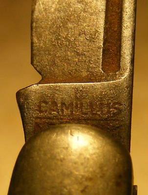

Posted: Sun Mar 24, 2013 3:17 pm
by msteele6
So much for my "simplest" solution to Camillus stamp dating given above. I just found this offering on eBay. Unless the blade is a replacement I would say that this knife definitively dates the long underline stamp back to at least 1956.
Re: Camillus Tang Stamps
Posted: Sun Mar 24, 2013 3:31 pm
by jerryd6818
Good one Mark. Looks like we'll need to re-think that long line era. Thanks.

Posted: Mon Mar 25, 2013 8:39 pm
by Vit_213
msteele6 wrote:So much for my "simplest" solution to Camillus stamp dating given above. I just found this offering on eBay. Unless the blade is a replacement I would say that this knife definitively dates the long underline stamp back to at least 1956.
What number is this model?
Posted: Thu Mar 28, 2013 4:40 am
by orvet
Mark, if that jack does not have a model number, what is the length of the knife?
Thanks! ::tu::
Posted: Thu Mar 28, 2013 1:56 pm
by msteele6
Sorry fellows, I found this knife on eBay and "borrowed" the pictures. After the pattern number question was asked I went back and searched for the answer and couldn't find the knife again. Maybe the listing had expired and the knife is now in the hundreds of completed listings.
Posted: Thu Mar 28, 2013 2:04 pm
by jerryd6818
It's a #15 pattern. (or at least that's what the seller says) http://www.ebay.com/itm/Vintage-Camillu ... 7675.l2557
And that's what looks like is stamped on the back of the blade.
Posted: Thu Mar 28, 2013 2:42 pm
by msteele6
Nice job, Jerry.
Posted: Thu Mar 28, 2013 3:12 pm
by jerryd6818
Hard to miss that Crown Royal sack the seller used as a background. :lol: :lol:
