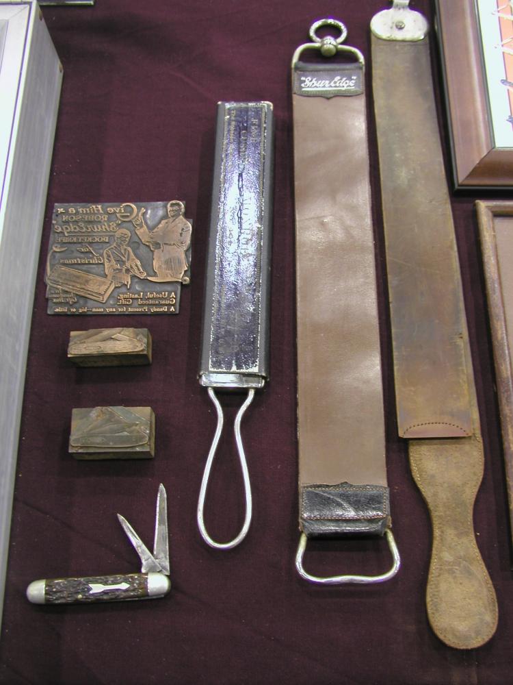

The long double-sided ones are meant to be hung from a peg or eye for convenience.LongBlade wrote:I guess I'm still trying to understand the difference between the strops which are a long double sided piece of leather vs those that are short paddles with handles
Lee
Typically those are leather on one side and linen on the other.
The paddle type are basically table-top versions.
Hope this helps .. .. ..

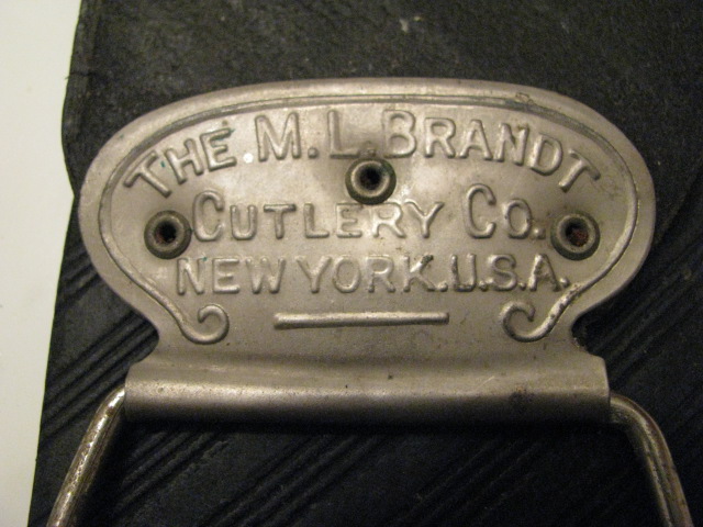

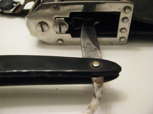

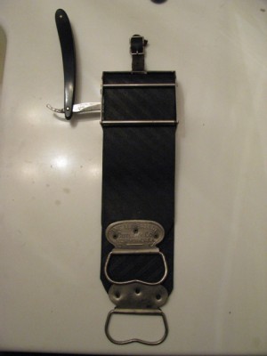

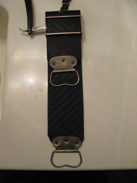

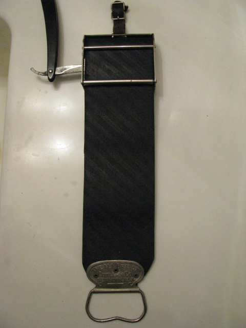

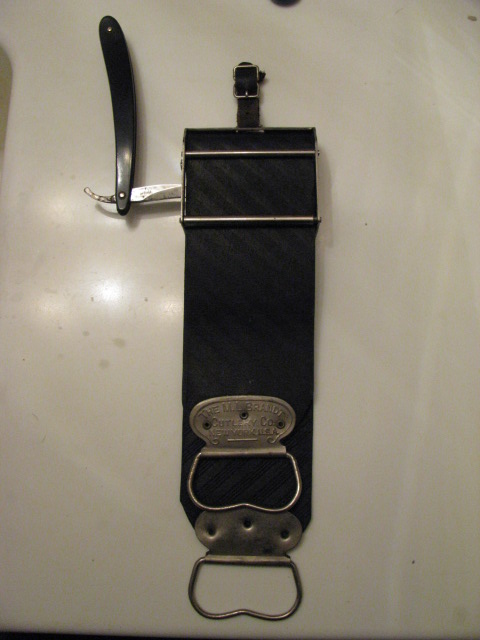

Here is an unusual one I posted awhile back.The device is hung from a hook or other appendage. The razor is inserted into the side of the device.Insert a finger(s)into the loop of the strap closest to the top and pull downward until it reached the bottom. Grab the other loop(now on top)and repeat the motion.Alternating the pull also alternates which side of the blade is being stropped.
If anyone has any info on this company I would really appreciate hearing from you.

Well that's weird.

I like weirdjerryd6818 wrote:Well that's weird.
Very neat Ray

Cool strop Ray - and I thought I was just starting to understand the types of strops out there

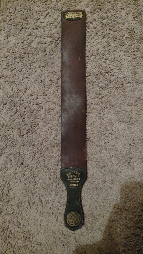

I got lucky and found a old Vintage Dubl Duck A-1 grade Horse butt that still had the plastic on it and was as supple as the day it was made. Its a slower strop than regular cowhide, maybe 50 strokes vs 20, but man the shaving edges that come off it are sHAweeeet.

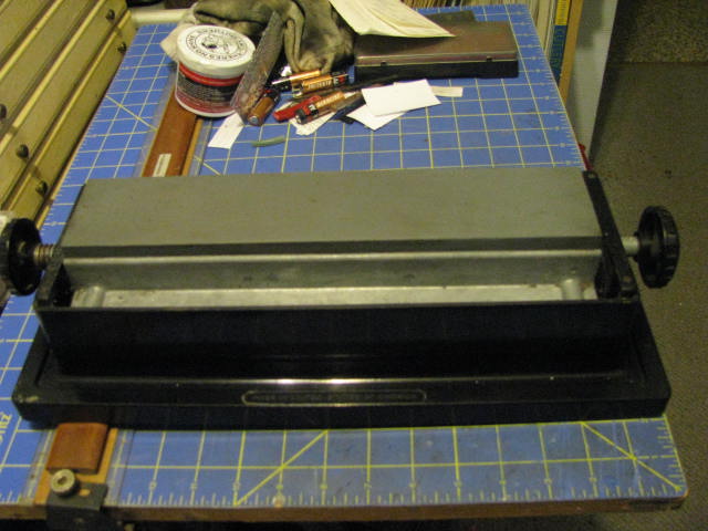

Anything like this? A Carborundum Duo-Stone 2 inch by 12 inch on either side(a coarse and fine).Cowdiddly wrote:
