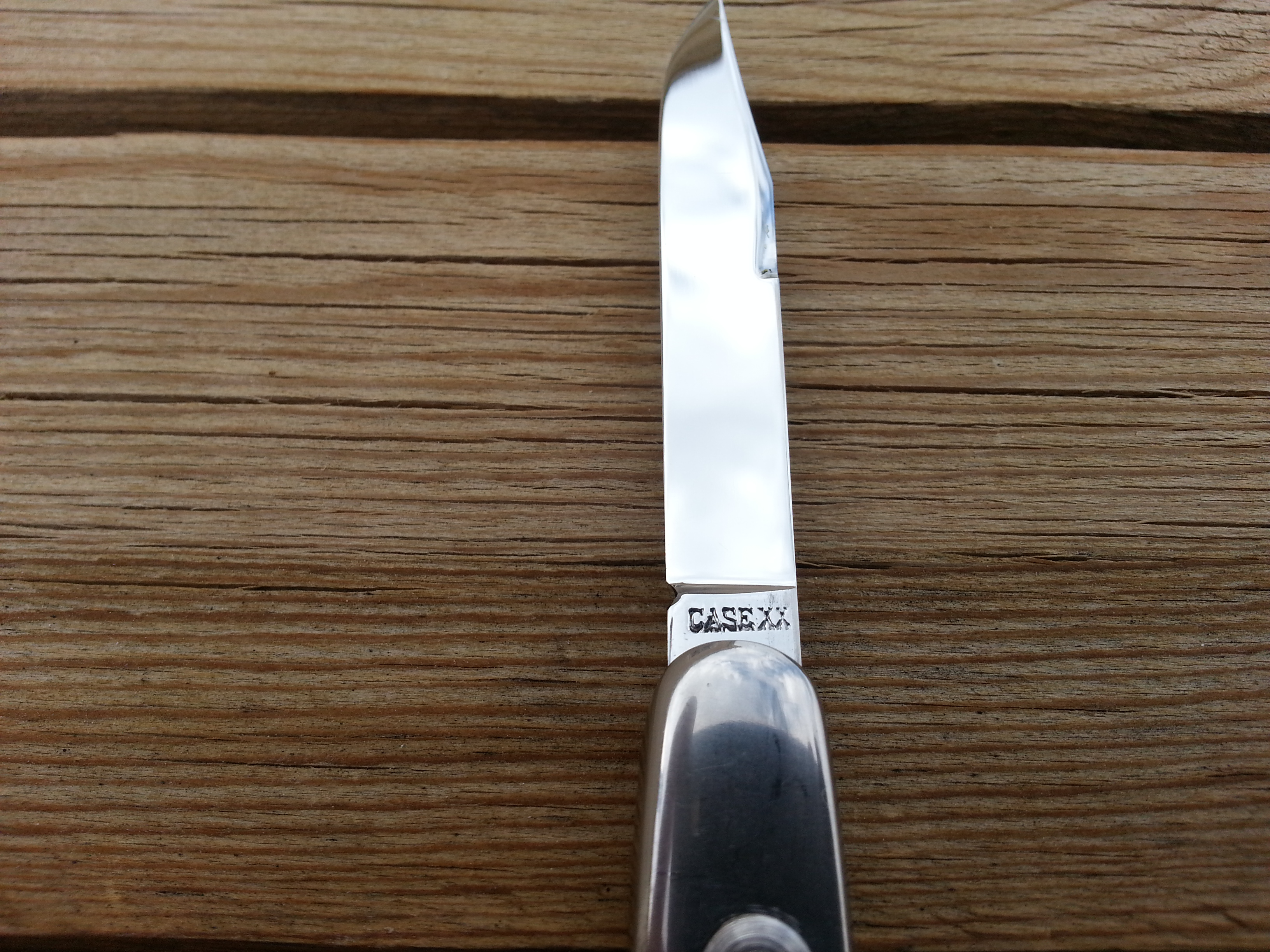

So I have what I thought was a CASE XX M100 Push Button knife. I answered another post today on a PB from a different maker so I pulled one of my PB knives out.
So I start looking at it with a 10X loupe and notice a CASE XX stamp with some interesting font. I start researching it and I find the same stamp on Gerald Witcher's Book, page 158. This is in the AUTHENTIC section where he shows alot of odd ball and seldom seen stamps, in addition to the more common ones we all know. Very interesting to me that he show this stamp and says "generally found on the M100 pattern which is a one blade pushout", as obviously, this is the knife pattern I am posting.

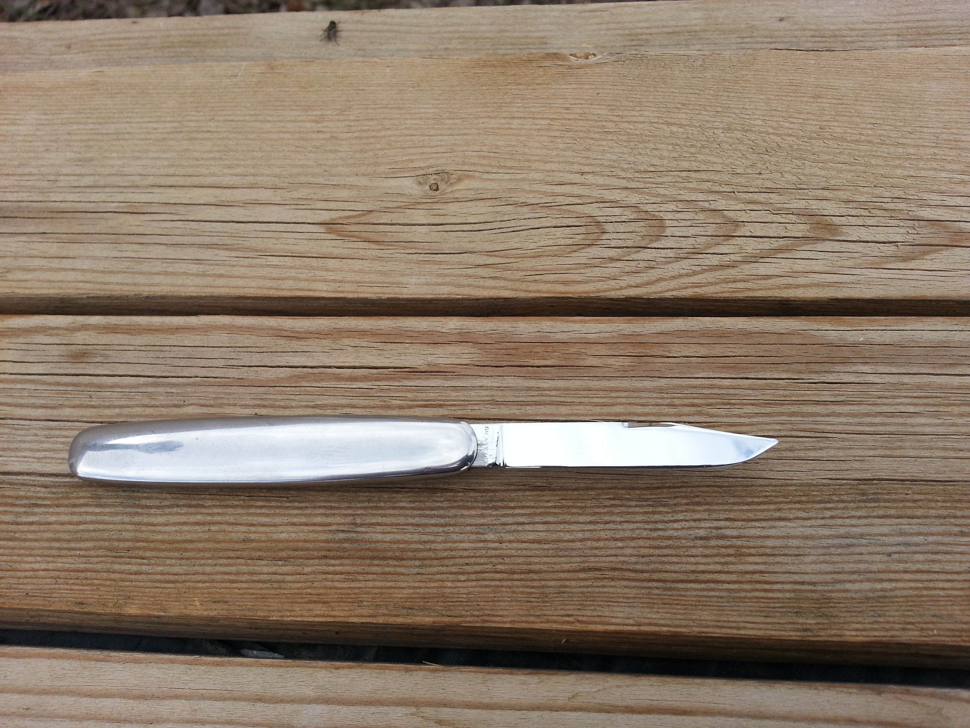

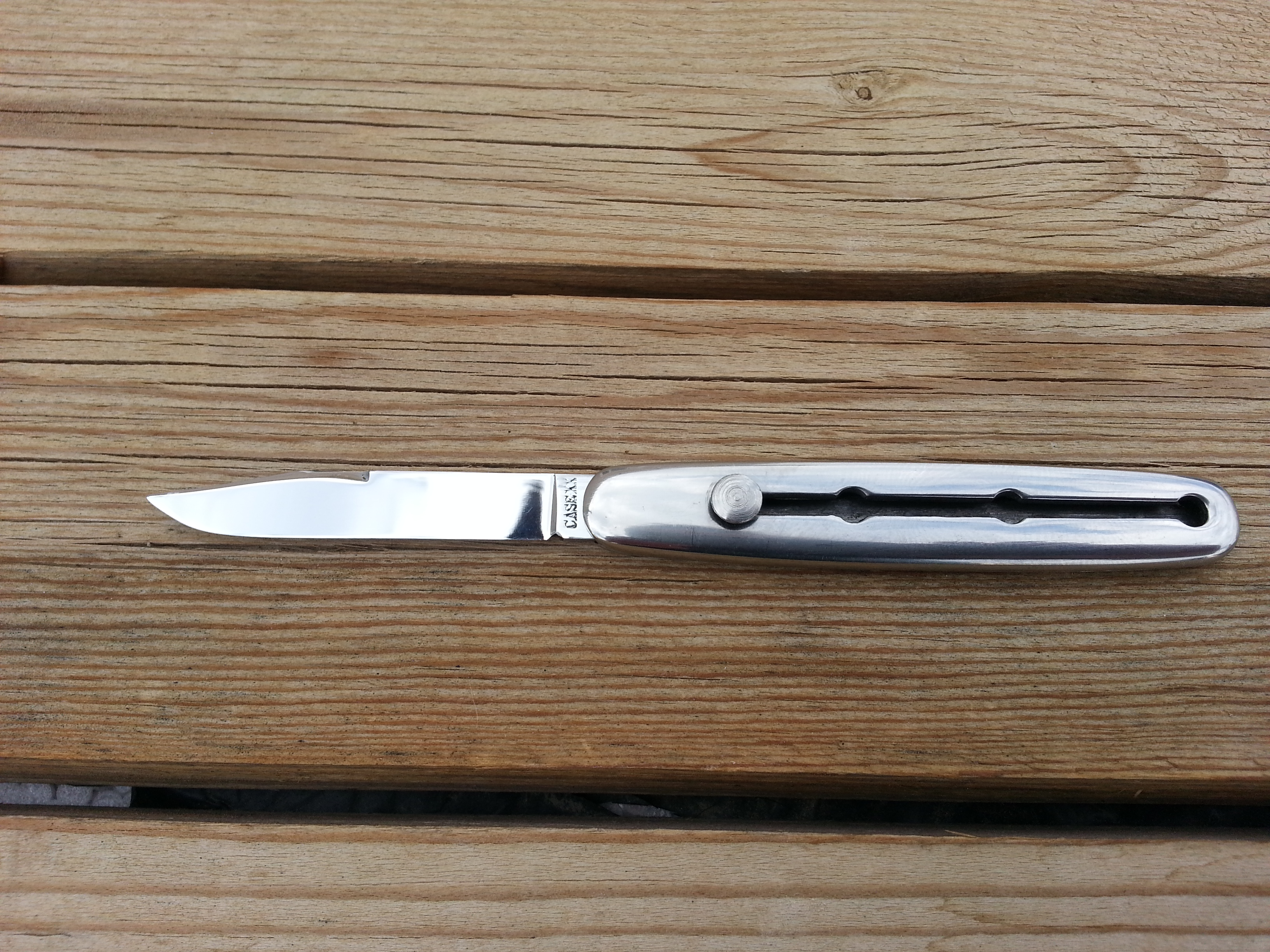

The knife also has a "PAT APLD. FOR" stamp on the rear tang. Did my best on the attached pics. looks to have been cleaned a bit, not polished to death, but full, nonetheless. I see not pitting around the tang indicative of heavy cleaning. Some scratching on one side of the tang from open and close.

2. The handle end closest to the blade is rounded. I have seen that in Sarge's book, which I turn to often besides Steve's, shows what appears to be a squareish end in the same location. I like his book but sometimes the pics of knives are real hard to make out.

I have one of these somewhere, not is as nice of condition as yours, but I picked it up due to the fact it was a patented knife, my current interest is in all different kinds of old knives that were patented.
Same stamp as on yours and I believe it had a pot metal handle, hard to tell if yours is nickle silver or pot metal like mine ::shrug::
Pretty sure the end is more square than your example.

I believe that I've seen this stamp called the "Circus" stamp, authentic in my opinion and from the time frame Witcher gives.

I thought the "circus stamp" was the TESTED long tail with the real square C. Either way, very interesting on the stamp's timeframe. So this is likely a pre TESTED stamp. Real didn't pay much attention to it as I really did not examine the knife closely before with a loupe. Thanks so much for the input. I really appreciate it.
