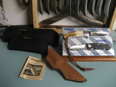

The first 500 were in sets with the D'Holder fixed blade, with matching serial #s, in this case #281, stamped into the spine of both knives.
