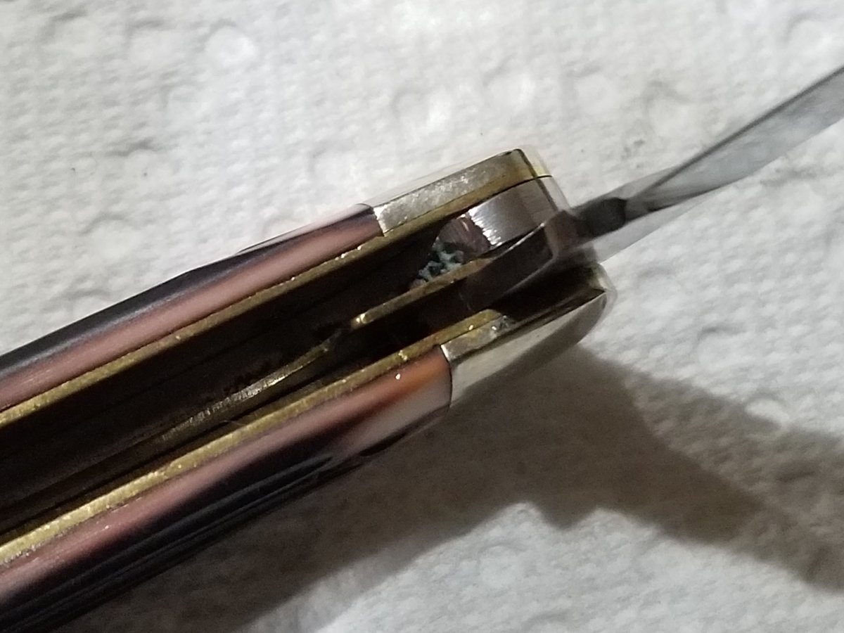

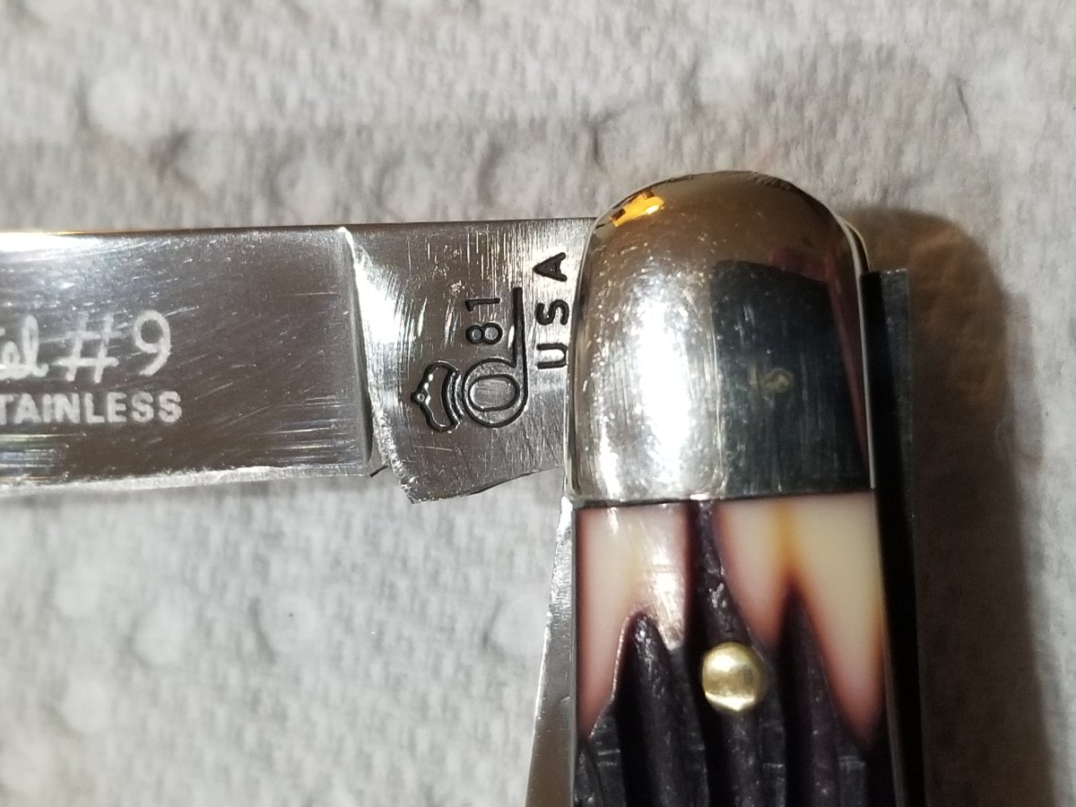

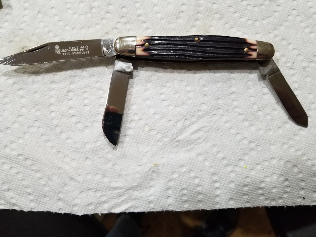

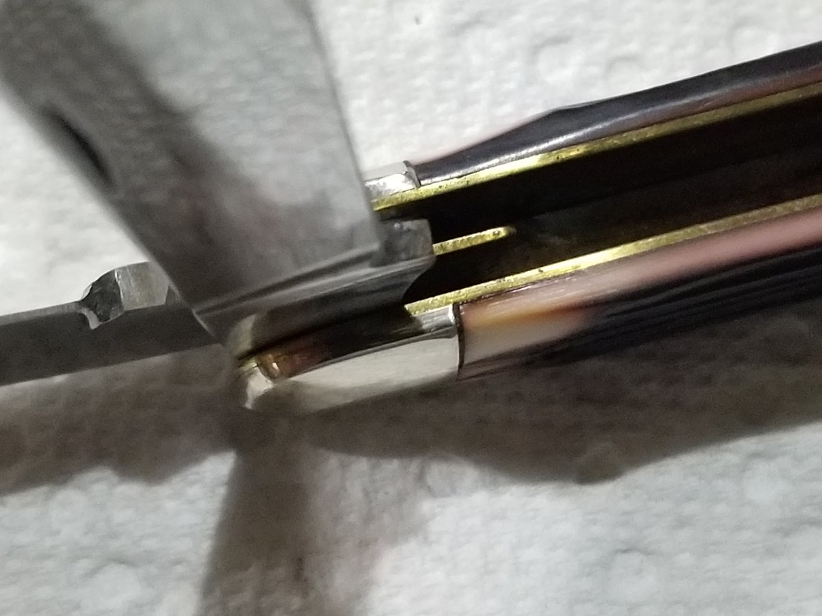

Hey folks, I just purchased a new/used Queen steel #9 81' model and I'm having difficulty getting ahold of the nail groove to open it due to the tension of the blades. I've boogered up both thumb nails trying to open primarily the opposite side single blade. The main 2 open with some tugging and snaps like a gator!
I used a jeweler's flat head with a microfiber cloth to get it open, oiled it and still haven't been able to open it up normally. This is my newest Queen (year wise) and it seems like the quality is slightly different from my others. Just wanted to see if anyone here has some recommendations... it a nice one, and worse case scenario I'd have a 2 blade EDC

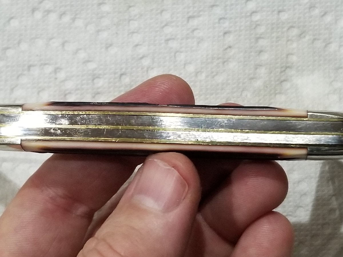

I am not a knife mechanic so perhaps the most honest thing to start with is I do not know what I'm talking about. However, staying home is getting boring so we can all use a little chit chat.
I have loosened up a few slip joints by opening and closing them hundreds of times with frequent oiling. As new they all had bolsters pressed too tightly together. My efforts only made knives that had normal springs but no snap start snapping as they should. With tightly pressed bolsters only a tiny amount of polishing grit robs a knife of its snap.Working the joints with oil gets rid of the polishing dust and slightly separates the bolsters. If the problem is very stiff springs or the cams on the tangs that work those spring repeated opening and closing is not going to fix it.
I have not done it yet but logically the springs could be thinned by sanding the back of the knife on a belt sander. You'd work it through progressively finer sand paper to restore the factory finish. One of my eBay Queens that is other wise a very nice single blade slip joint Is the hardest to open and close of all the slip joints that I've handled. I like hard snap in a large slip joint but this one is a bitch to open. I'd have tried my idea but I'd be a fool to not experiment with a knife from China first. All I need is a hard to open Chinese slip joint.
