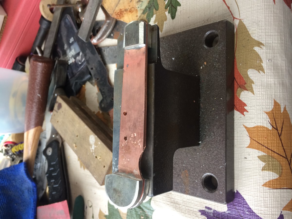

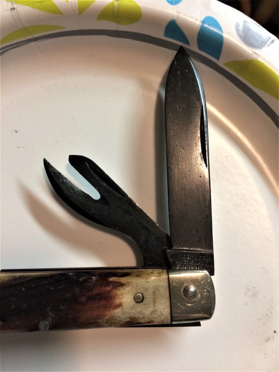

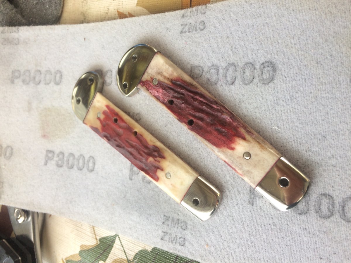

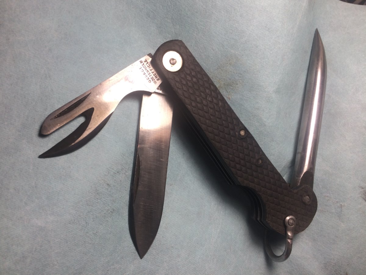

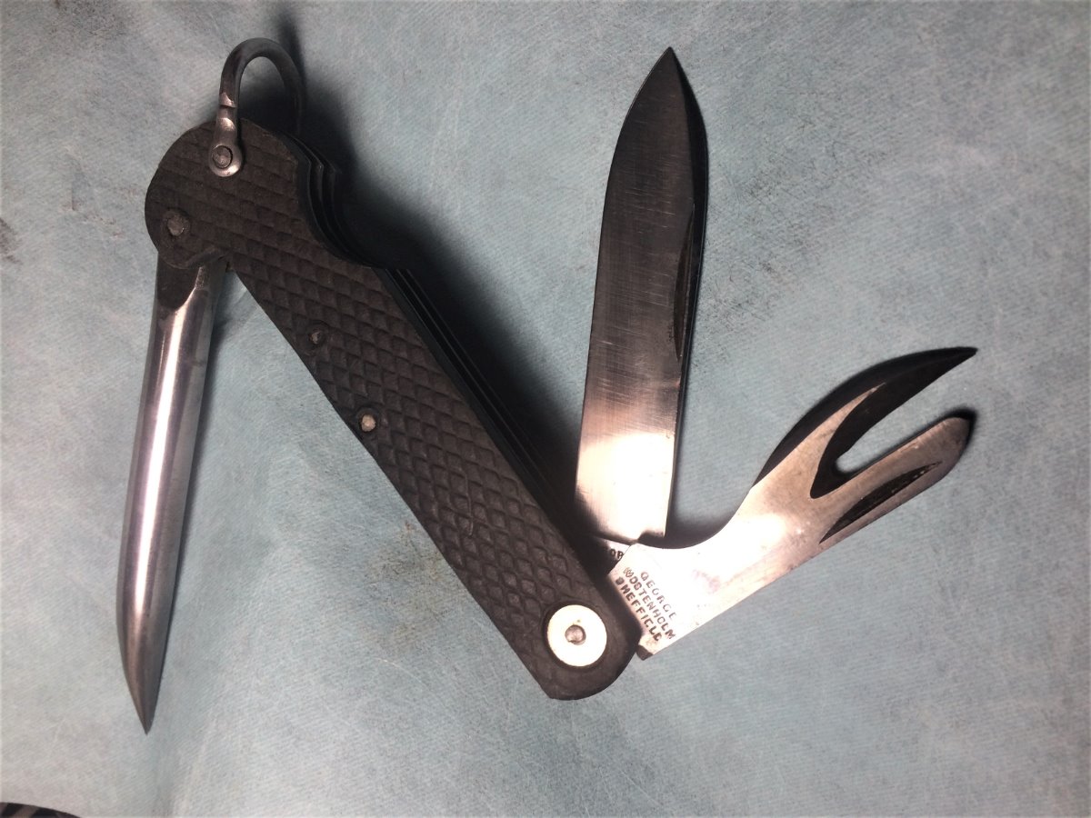

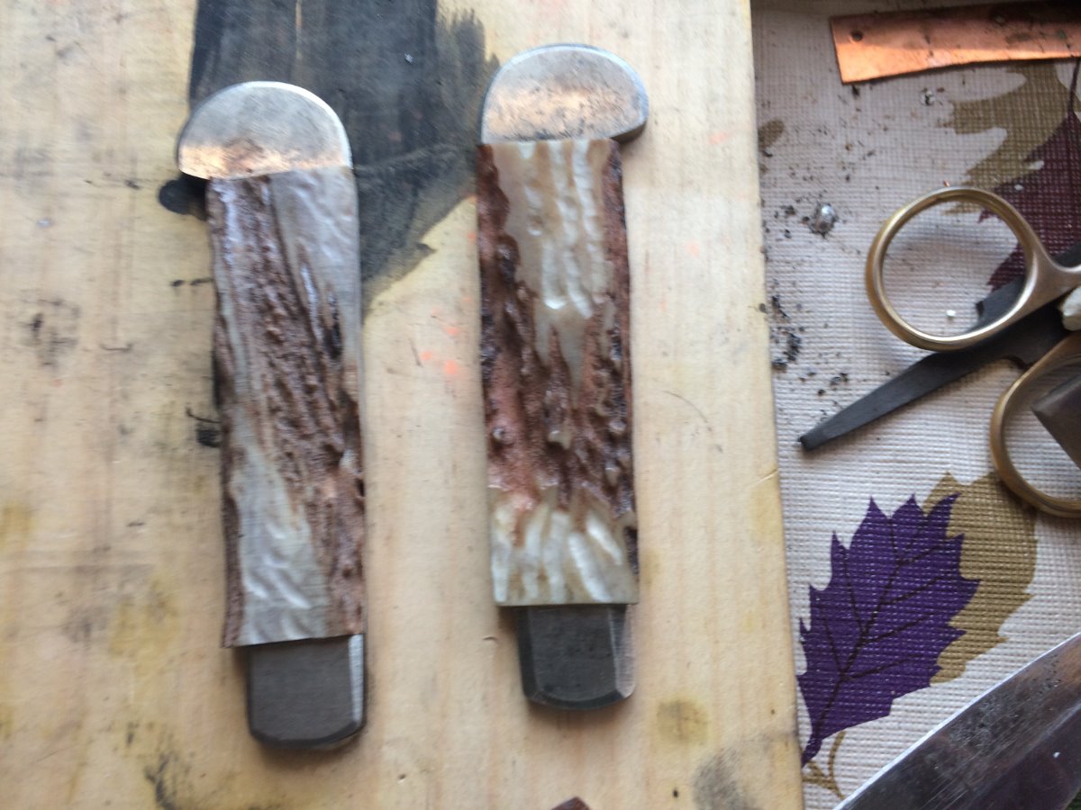

:D Project Sheffield Sailor Knife Parts and Progress , I Know You Guys Like Step By Step , , Need to make a bail , Since I Have Been Up- To my ( Lol) With Life Happens , I Find This Project To Be Of The Utmost Importance ,, ( Lol )K.C. Don't Seem To Be Any Order To My Madness so you might have to piece things together ( Lol)more photo's to follow .

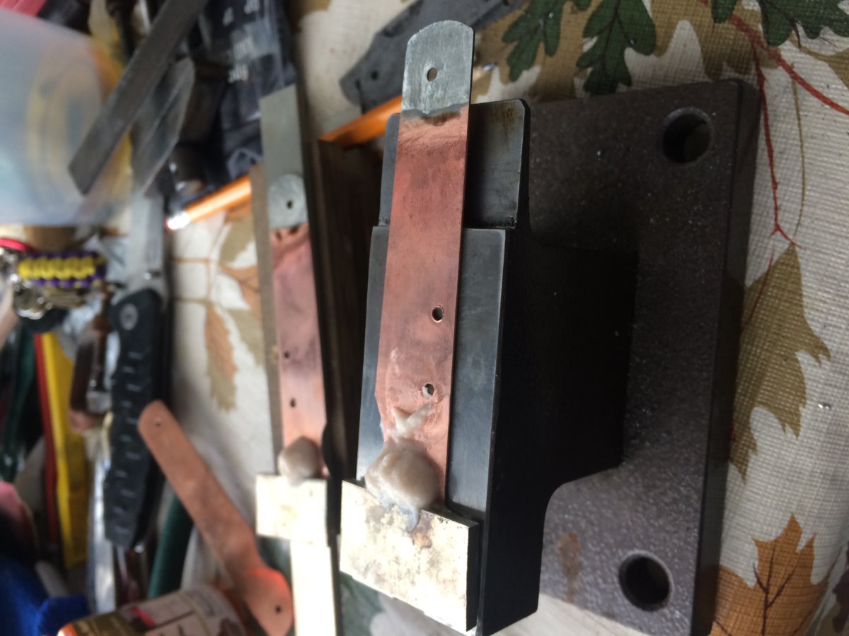

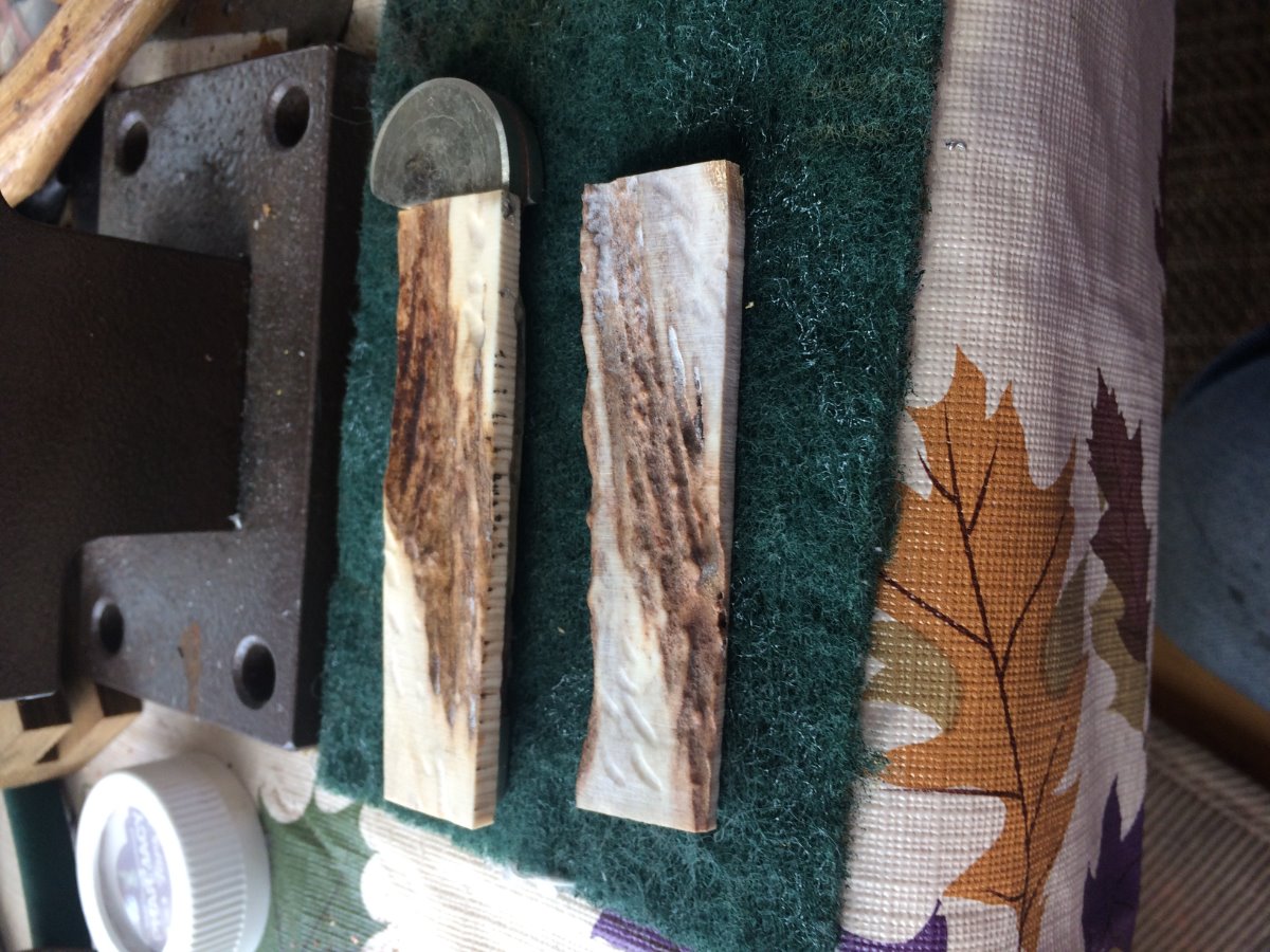

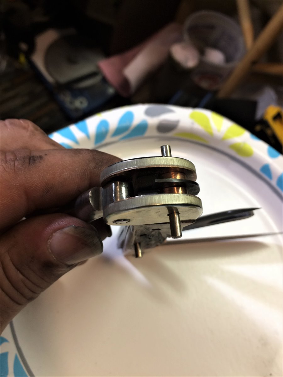

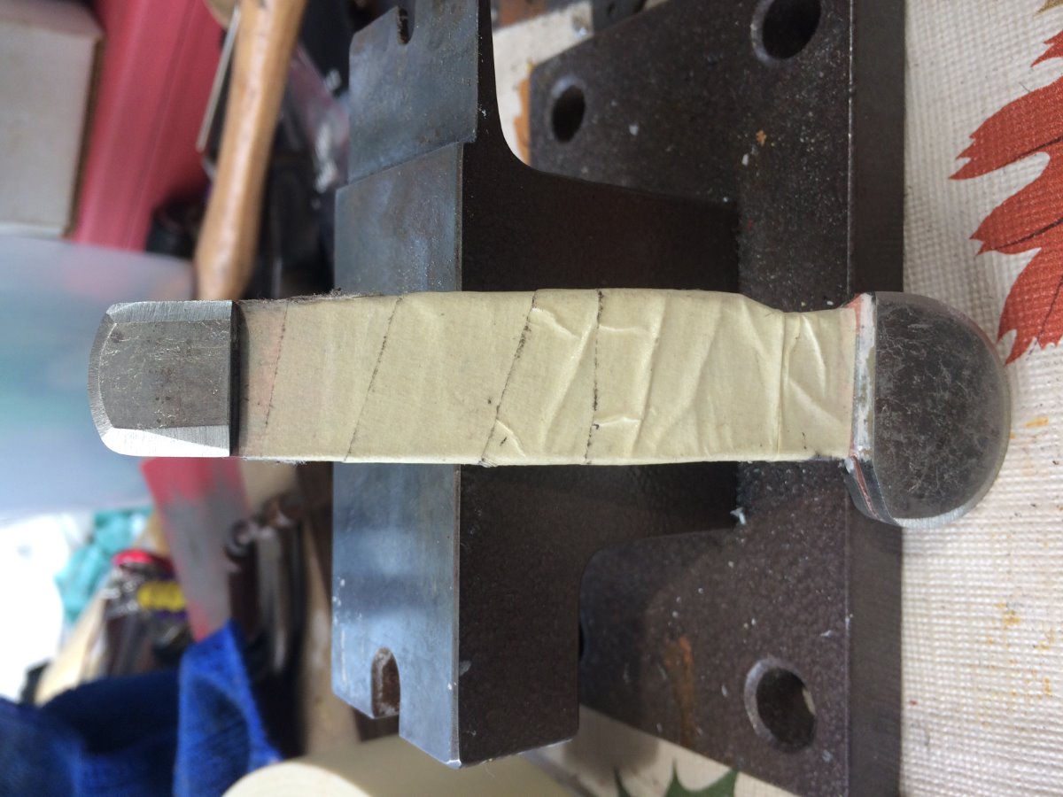

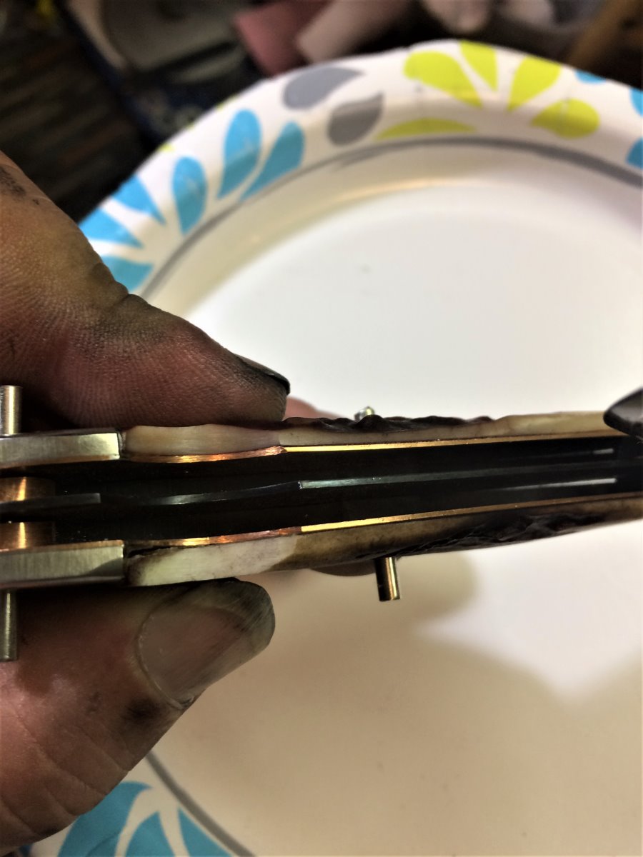

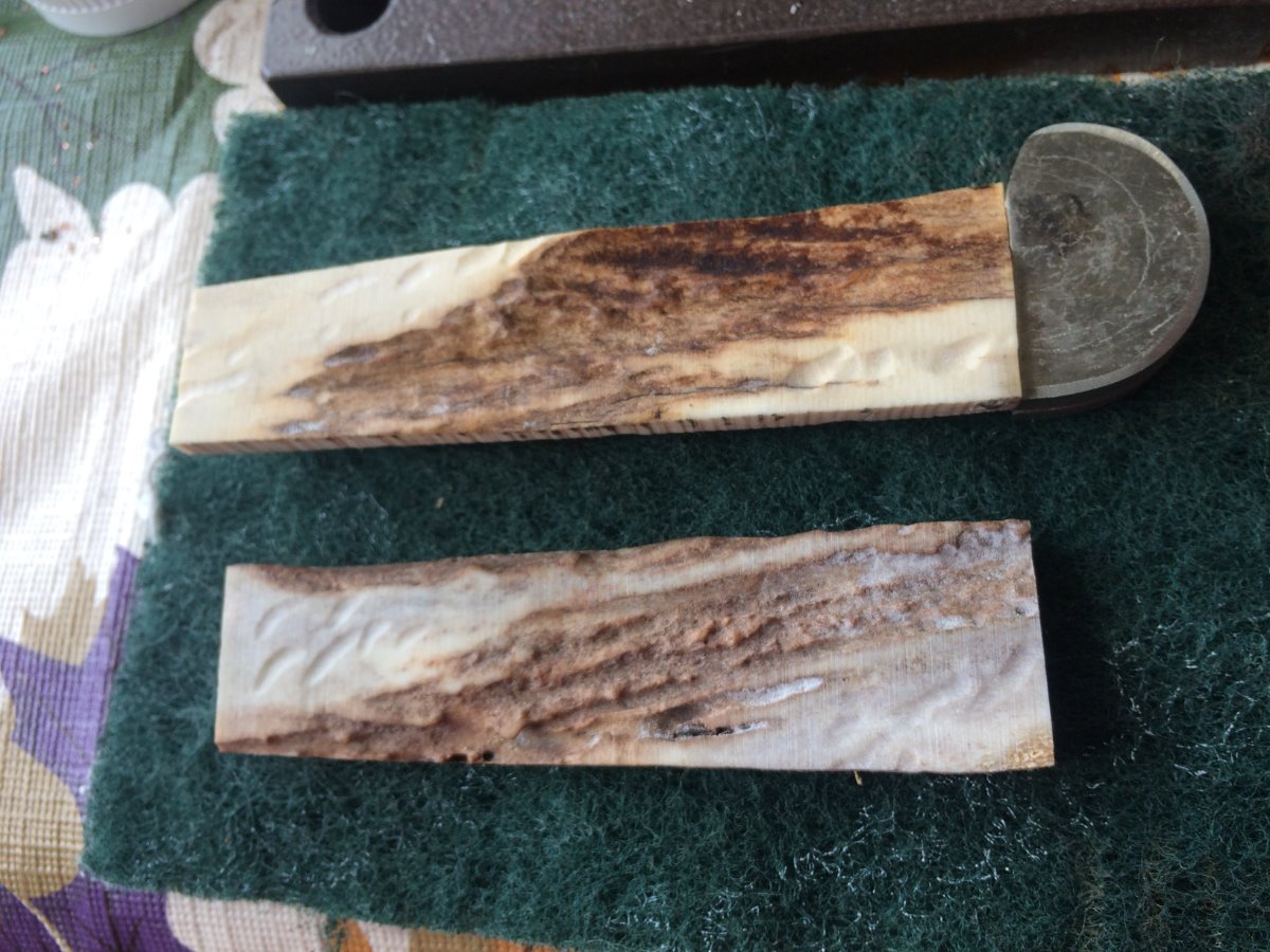

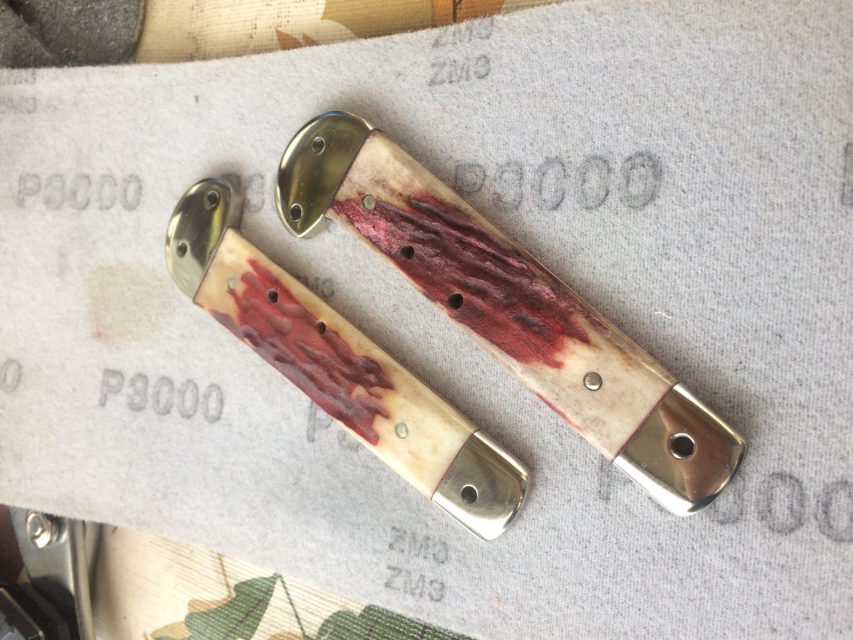

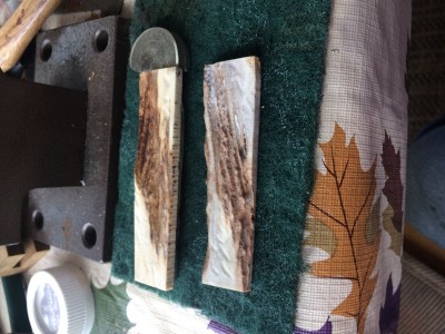

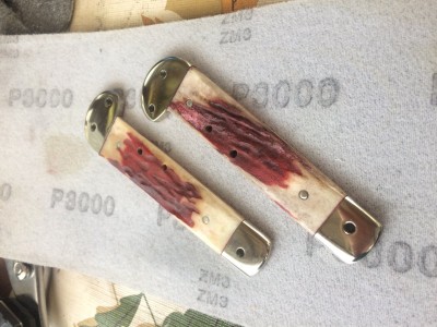

More Progress Photo's Which I edited . sorry K.C.
Original
Original
Original
Original
Blued Steel center Liner Backsprings And Blades
Coin Edge Nickel Silver Bolsters

Looking good! I've done a few of those. The ones I did had nail breaking springs, so I never used anything neat like bone, I was too afraid it would crack under the strain. I used micarta on those ones. I suppose stag would be strong enough. Hmmm ::hmm::

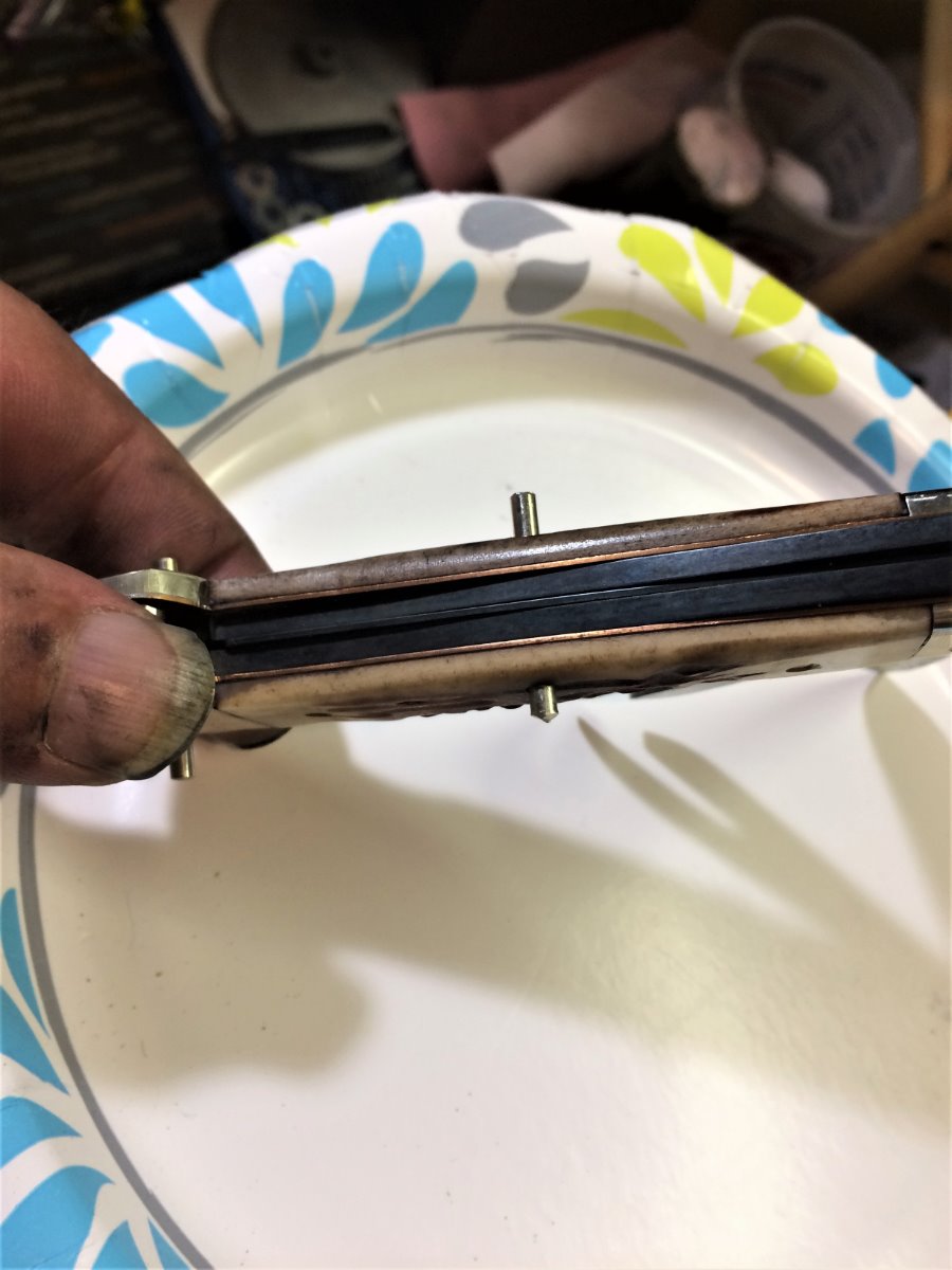

Thanks fella's . Going to Make a Flat long loop bail .. I think there flashy 8) Back spring on theses Type Knives are very strong . Nothing I would be comfortable using . So The project Begins ( Lol) Its quite possible to tweak the snap by varying Pin Hole Size and placement or so I found out . But the Liners must be Original before the modification with the pin size .. ::tu:: Thanks for youR Comments Will Have it completed Soon , I will take some 360 Views Should You like some ideas .. Ty K.C
