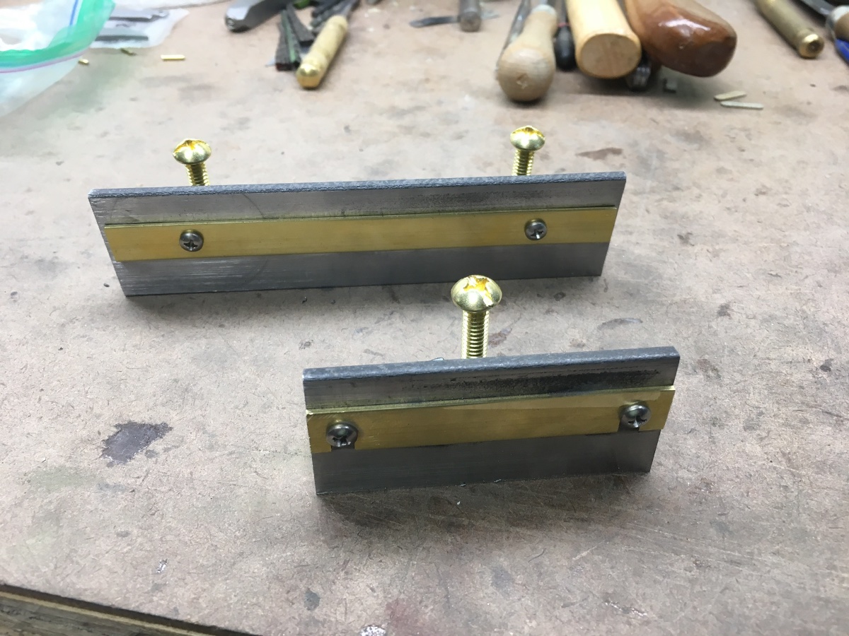

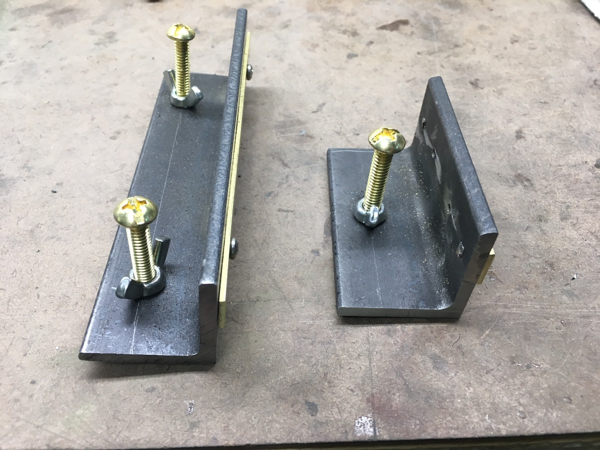

I made a few of those grinding jigs this week. I had to modify his plan just a bit due to the thin blades that Im grinding but other than that, they were easy to make, relatively inexpensive and work pretty well.

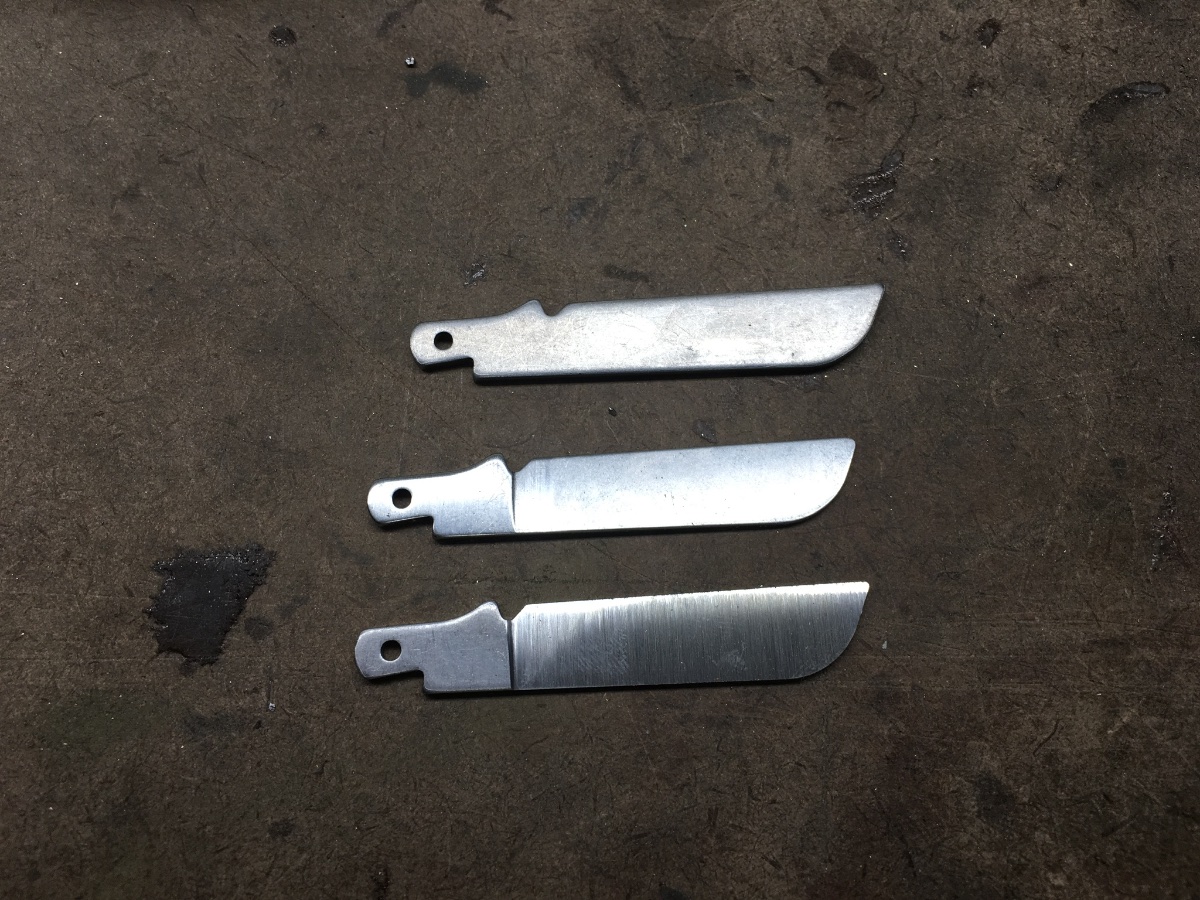

I’m working with some Schrade sheepsfoot surplus blade slugs that need to be profiled. The angle needed is much less than I would have thought but after four blade trials I’m getting close to where I need to be. I’ll need to round up a few more finer grits in some good metal cutting 2 x 72” belts and adjust the angle just a bit more.
The top blade is the factory slug with no bevel, the second blade is a factory ground blade and the third blade is my latest effort at grinding a blade bevel.
When I used the screw heads as the blade rest (like he did in the video) the grinding belt ground off the screw heads. So I switched over to the thin brass metal strips and for my particular need they work just fine. That and I allowed a bit more than 2” between screws to allow the grinding belt to work without contacting the screws.I’m working with some Schrade sheepsfoot surplus blade slugs that need to be profiled. The angle needed is much less than I would have thought but after four blade trials I’m getting close to where I need to be. I’ll need to round up a few more finer grits in some good metal cutting 2 x 72” belts and adjust the angle just a bit more.
