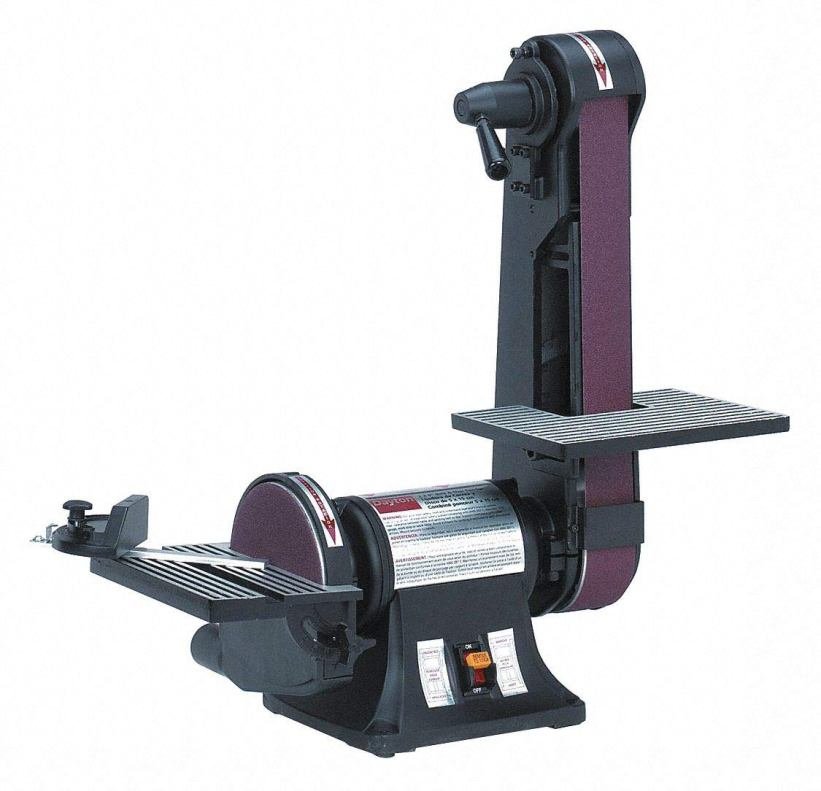

2x72 is what I really want (some day)....
Ole Santa just ain't that rich this Christmas. I figure I will get a 2x42 for now and maybe later get my dream sander.
I see there is a Dayton 2x42 that looks pretty nice. I saw a video on youtube where a guy made a better sanding table so he could change belts without taking the stock wrap around table off.
I'm leaning in that direction now....

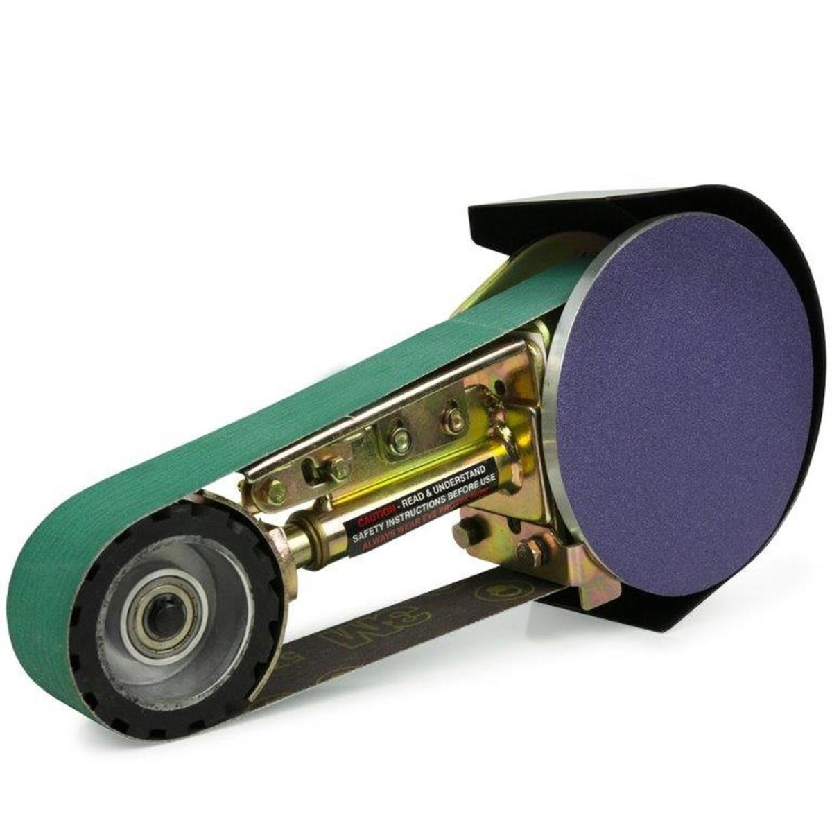

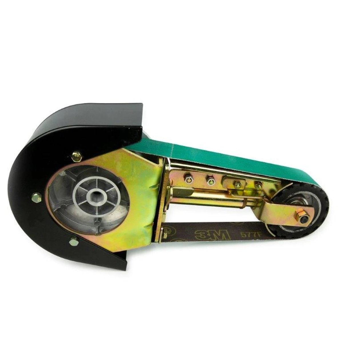

There's another alternative I forgot about, I saw it at Blade Show West a couple weeks ago, a company called multitool-usa.com puts out a 2" X 36" belt sander attachment that fits onto a bench grinder. If you have a half horse or greater, it would have plenty of power, $229 on sale.The really good thing about it is it has a contact wheel that you can grind on, something they can't do very well on most units smaller than 2 X 72. It also has a 7" disk sander built into it.
https://multitool-usa.com/2-x-36-belt-7 ... ttachment/
This one has a mitre table, metalworking belt & disk starter kit. It comes with some belts some sanding discs and buffing compound. It is $345 on sale, regular $458.
https://multitool-usa.com/2-x-36-belt-7 ... arter-kit/
I saw the unit demonstrated at Blade Show West. It was on a one horse bench grinder motor and that was more than enough power to run that unit. The belt and the disc sides both seem to work flawlessly.
I was impressed with the unit and I especially like the idea of having a contact wheel that you can grind on. I thought they also a version with a larger contact wheel, But if they do it's not on the website.
I was impressed enough with this unit that I still might buy one. I'm so crowded in my shop I almost have to get rid of something in order to bring something new in. I could bolted it on to my one horse Jet bench grinder that stands on a pedestal. It wouldn't take any more floor space than is already used. I think it would work fine for a first belt sander and it would definitely be great as a backup or a second or third belt sander.

If your grinder is a 3650 RPM model, the Multitool will run too fast.
I put one on a variable speed grinder, but I seldom use it. I have 3 2 X 72 units.
