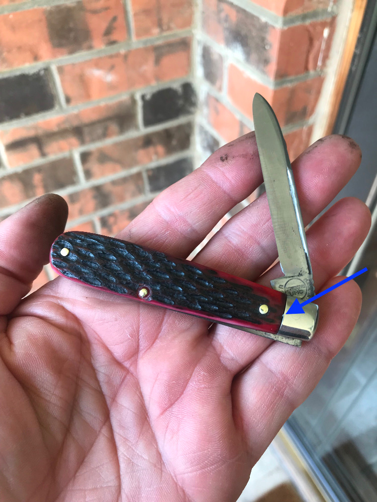

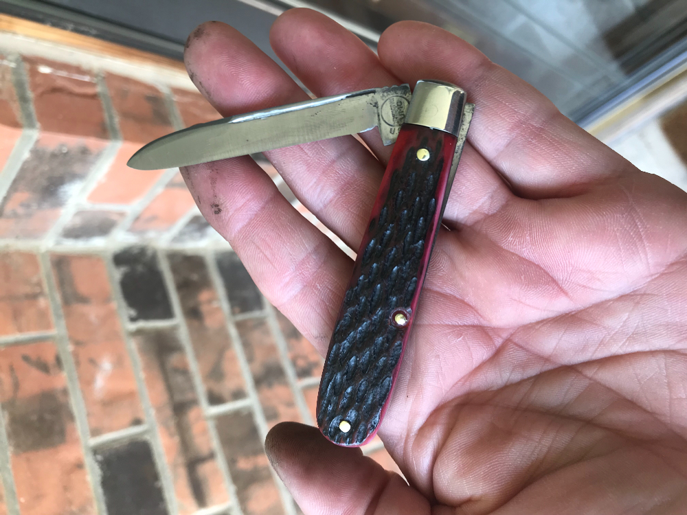

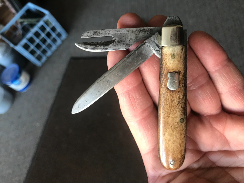

I picked up this old Remington that appeared to have been rehandled and a blade swapped out with an old can opener blade. I made a single blade out of it and put some red bone handles on it. This was my third attempt at rehandling and was somewhat successful!!

I'd say you were more that somewhat successful! That knife looks great!

Shawn that's real nice. You did a wonderful job, and I really like the color of the handles. You also got the edge of the handle right up against the bolster with almost no gap. Nicely done. ::nod:: ::tu::

It's ideal to be able to get the handle material fit flush to the bolster, but when you are working on old knives, especially ones that have been carried for a long time and have been pocket worn or may be polished from time to time, you will notice there's not a shsrp line at the edge of the bolster. Frequently the edge of the bolster has been worn down or have rounded off so that even when you have a good fit of the bone against the bolster, it often appears that there is a gap because the edge is worn away at the top.
Sometimes no matter how hard you try for a nice tight fit against the bolster the rounding and wear of the bolster edge makes it impossible to get a flush fit. ::shrug::

That looks like the same Catalina Crimson I used on my Boker rescue. I like the way you finished your handles. I think I took a little too much off mine.

I did have to file the edge of the bolster to get the bone to match up square. Still learning but it was fun!

I think that is what I used. I got them from Cullpepper for like 3.00 a set or something like that! Cheap I thought.
Ive ruined one set already!! ::facepalm::
